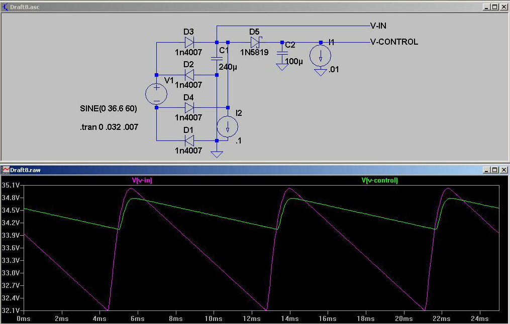

Interesting part. It has an open collector output. So it's only LDO with respect to the power input, as long as you can provide a higher voltage for the control input. If you only have one input voltage, then it's only semi- LDO at 1.2V in-out.
You could always do this.
