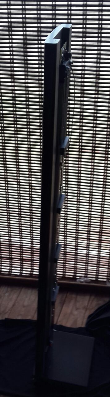

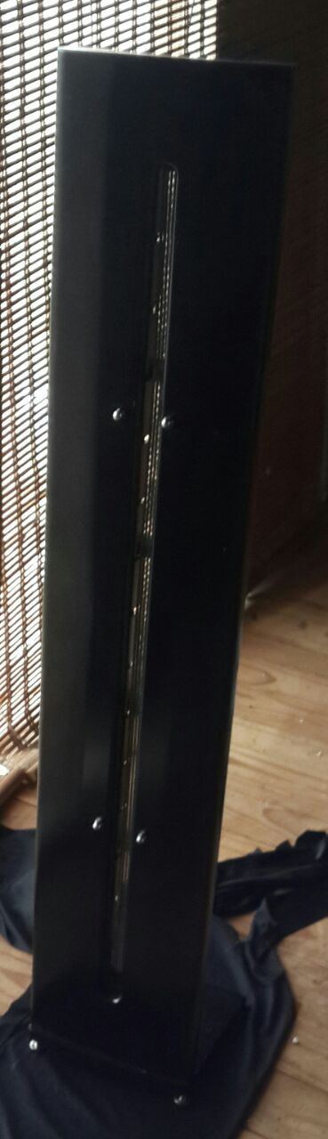

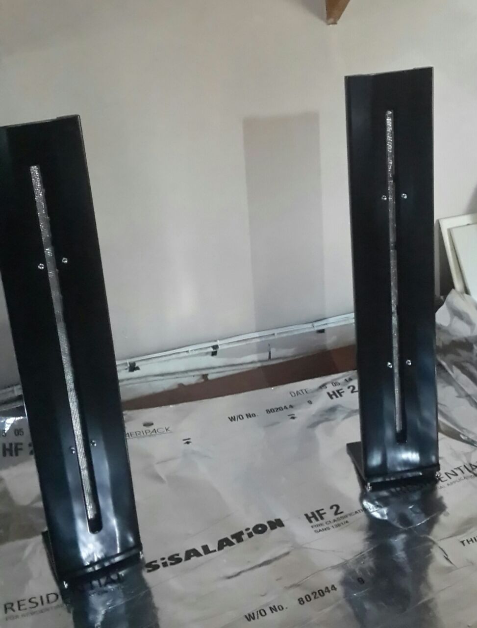

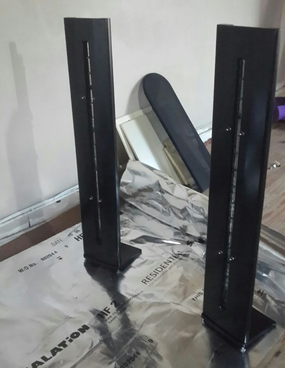

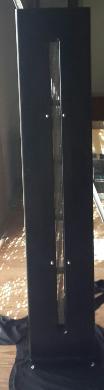

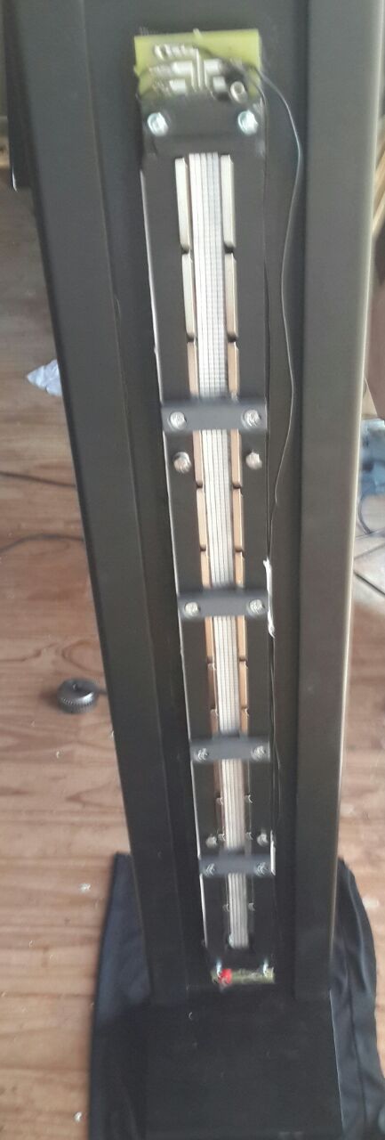

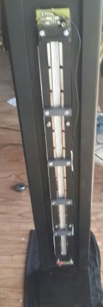

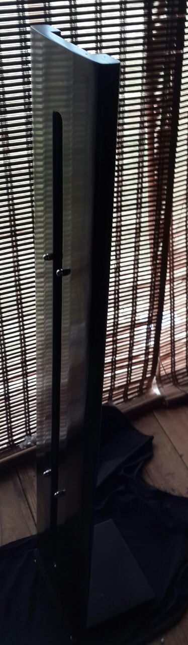

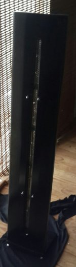

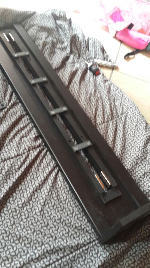

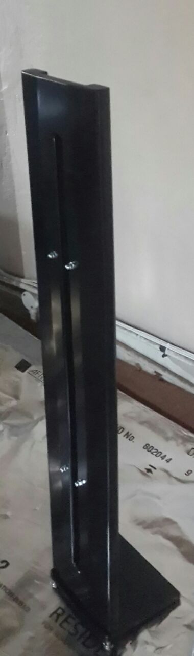

Hi Guys, I thought I would share some images of a build im doing for a client in South Africa. The ribbon is a 5 segment it measures 6 ohms resistance and is 18mm wide and 35" long. The client wanted a narrow baffle similar to the B & G Radia 520i. The baffle is 1.1m x 220mm wide. Iv used nylon bracing bars to try and keep the flux centred between the ribbon. My magnets are N37 3/4" x 2" x 1/4". My pole pieces are 3/4" x 3/4" solid bar (No idea how this measures on Femm)
Vary nice..........is the foil on bouth sides?...look to be free hanging?.......one thing I never got to hear was the two sided Apogee Stage 26" ribbon.......

Would you share on how you attached the magnets to the steel structure? Are they glued, or do they hold themselves in place?

The ribbon is attached every 180mm to the nylon braces.
No need for glue once they on the pole piece they wont jump towards each other.Would you share on how you attached the magnets to the steel structure? Are they glued, or do they hold themselves in place?
