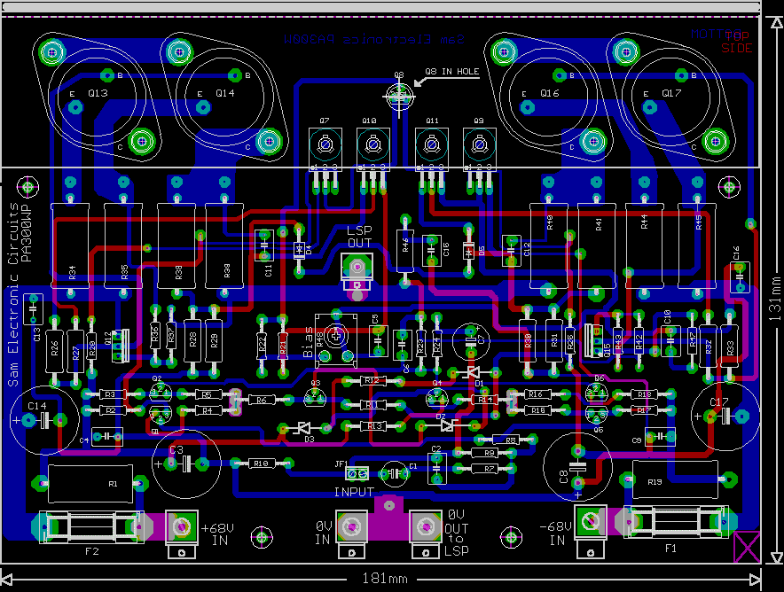

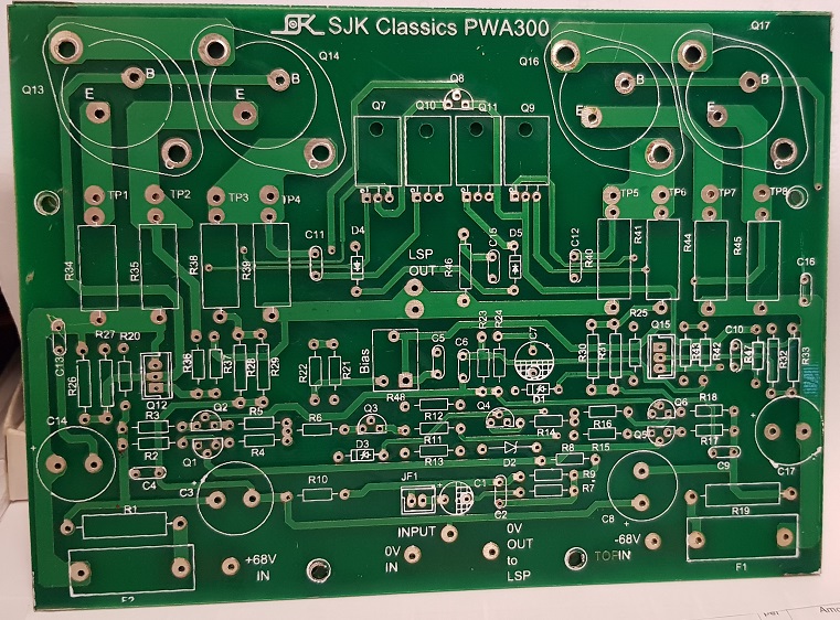

you should not need a 45Vac nor 50Vac transformer to get 310W into 4r0.
I used a 230:40Vac run on 240Vac to get ~300W into 4r0. It was designed as an 8ohm or 6ohm capable amplifier.
To guarantee your 310W you might need 41Vac or 42Vac particularly if your mains runs lower than 230Vac.

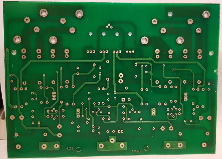

  • E10945 GBR.pdf
    E10945 GBR.pdf
