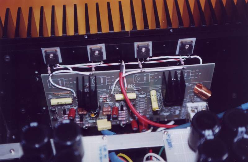

Mark V Electronics seems to be defunkt as there is no web address and no telephone number that is in service. It was a pretty crappy company to deal with anyway. The parts are really simple to come up with. The transformer and filter caps aren't too much trouble, either, these days......... The PC Board isn't that great and crappy quality, besides, the heat sink that comes with it is way too small and the output section needs to be upgraded anyway. There needs to be at least 2 more outputs per rail. I like the sound just fine but I don't have time or money to do the necessary nods. I never push them very hard so what I have is just fine. What I'd really like to do with this amp is lay it out again and use flat pack transistors rather than T0-3's. I'm looking at 2SA1943 and 2SC5200's They are obtainable at MCM Electronics and if you order 10, you get a pretty darned good price break.:cool: It is a pretty stable amp except the driver transistors aren't on the same heat sink as the outputs.:scratch: I don't like that much but it seems to work. It also is designed to have a fan blowing on it so if you build one, get the fan. If you build it right, no fan necessary unless you drive it hard continuously. All-in-all I rate it very good even soundwise. Yes, it sounds contradictory but it's a cheap kit (68.00) what do you expect. I also built speaker protection devices (kits) and they work well and I highly suggest them.

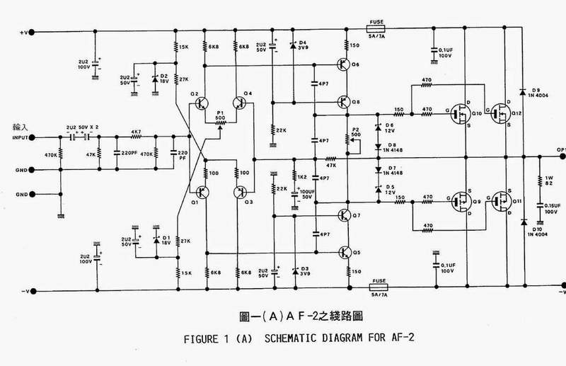

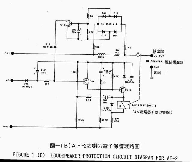

the sound of this kit just ok, very good for subwooder and P.A. system. for home use, try Sound Master's another kit "AF2", very nice amp with 2 pair of hitachi mosfet, usually, this kit will come with 1% metalfilm resistor, the price is $438HKD.
All kit of Sound Master not include power supply, so you must build it yourself. you can see the kit's pic here, its build by my friend.

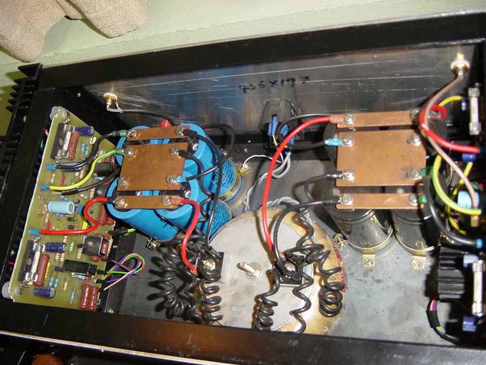

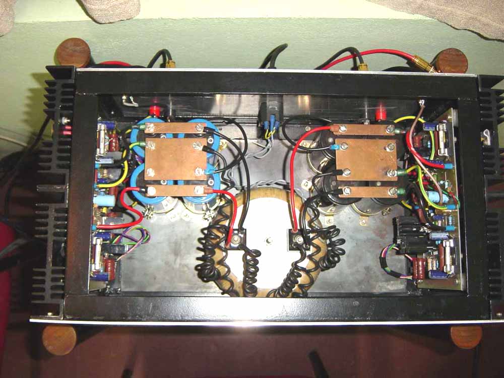

If you dug that amp, you may love this one. I have built 7 of these from kits and use them in my home theater setup.
Specs 300WRMS into 8 Ohms! +/- 75V rails @ 8A
Measured 242WRMS into 8 Ohms resistive w/sinewave input
368WRMS into 4 Ohms resistive w/ sinewave input
I think, with a bit better capacity of power supply, I'd get 300W into 8 Ohms.
Chris
