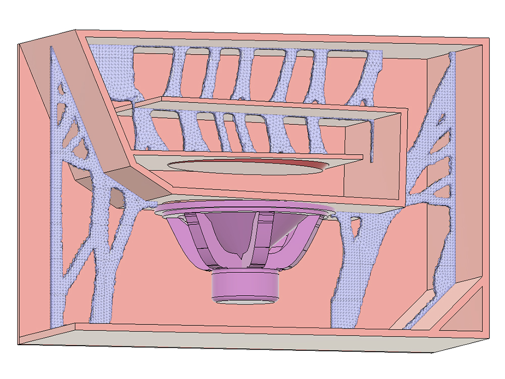

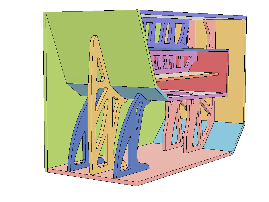

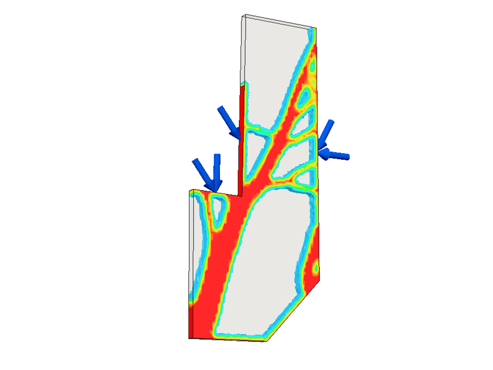

I ran some Shape Optimization simulations in Fusion 360 for the internal bracing.
You apply a load, and constraints, and it tells you where you can remove material. I'm not sure how accurate my inputs and outputs are, but it couldn't be worse than randomly drilled holes.

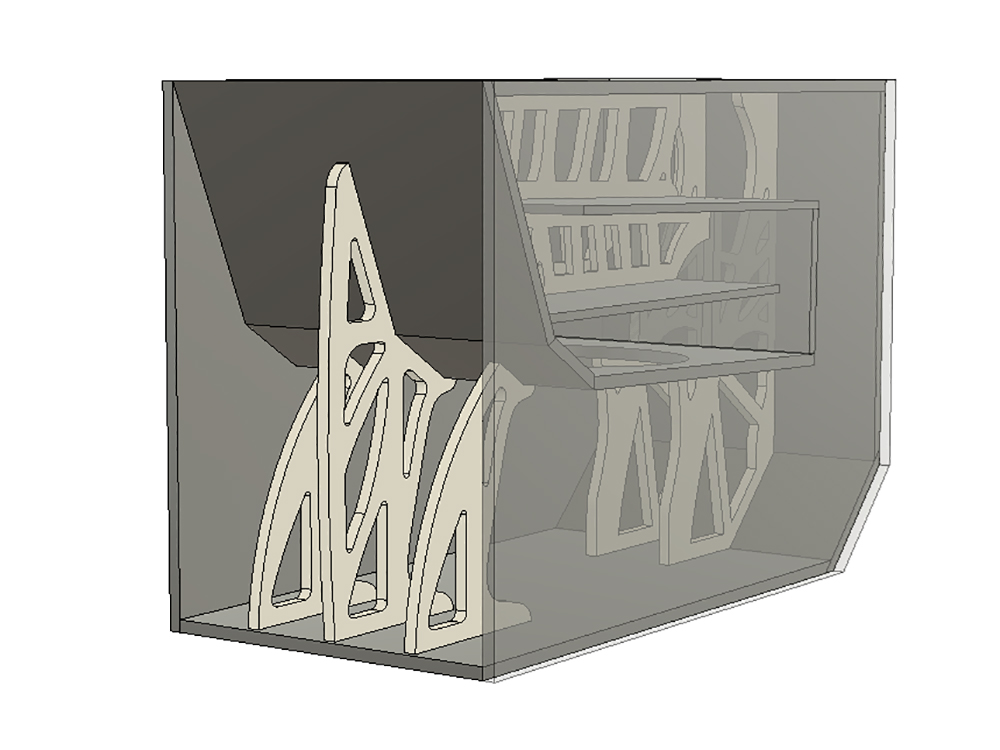

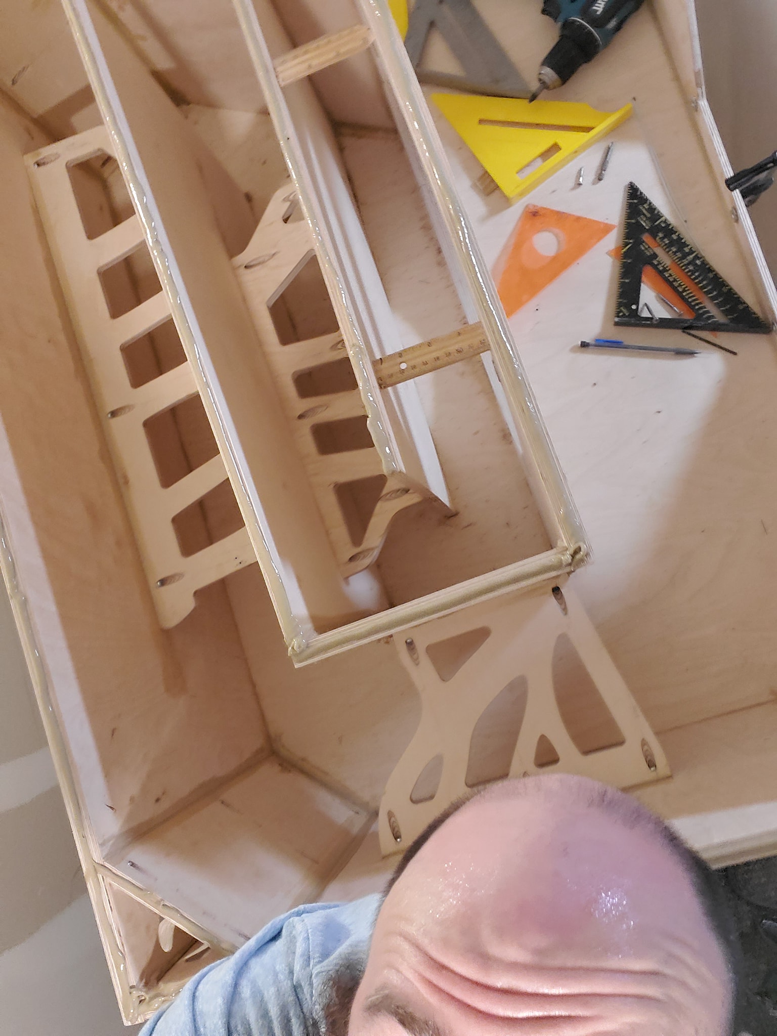

With pretty bracing like that, the enclosure deserves at least 1 plexiglass side panel!
BP1 you aren't the first to suggest that! I'm not sure how to seal it to BB, and the how to make the seal look good.

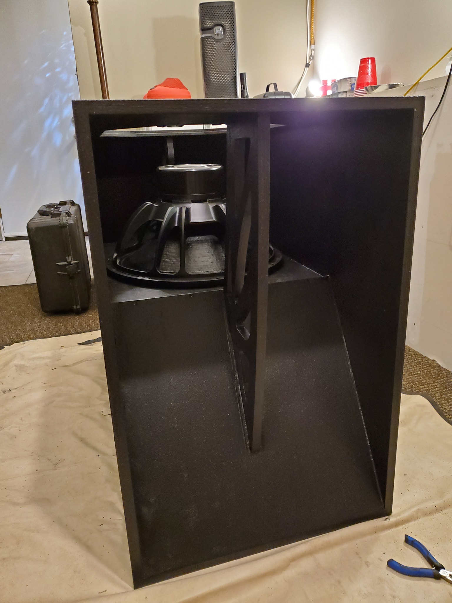

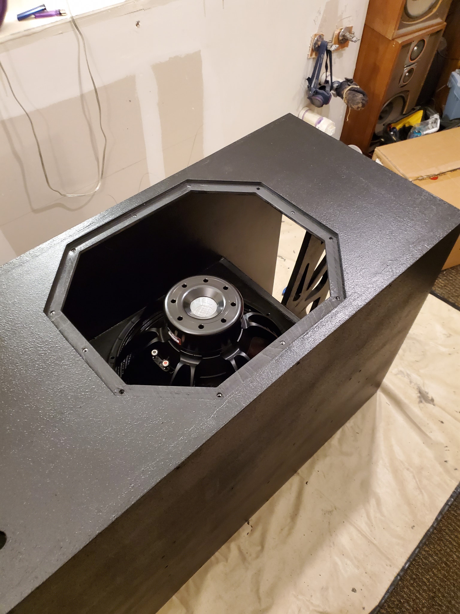

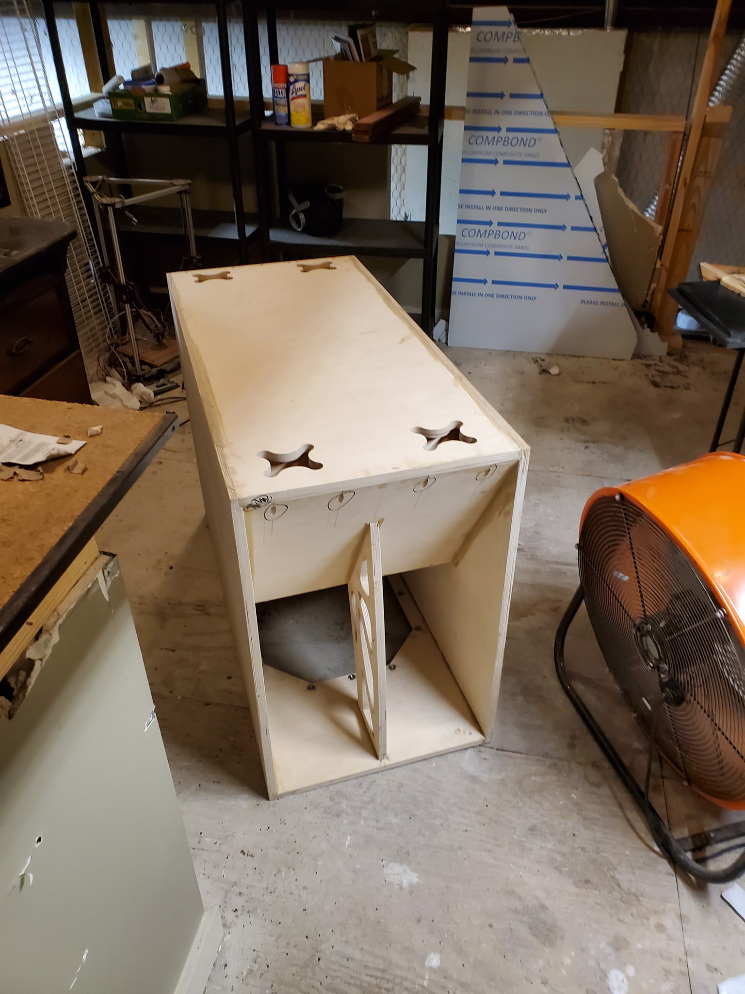

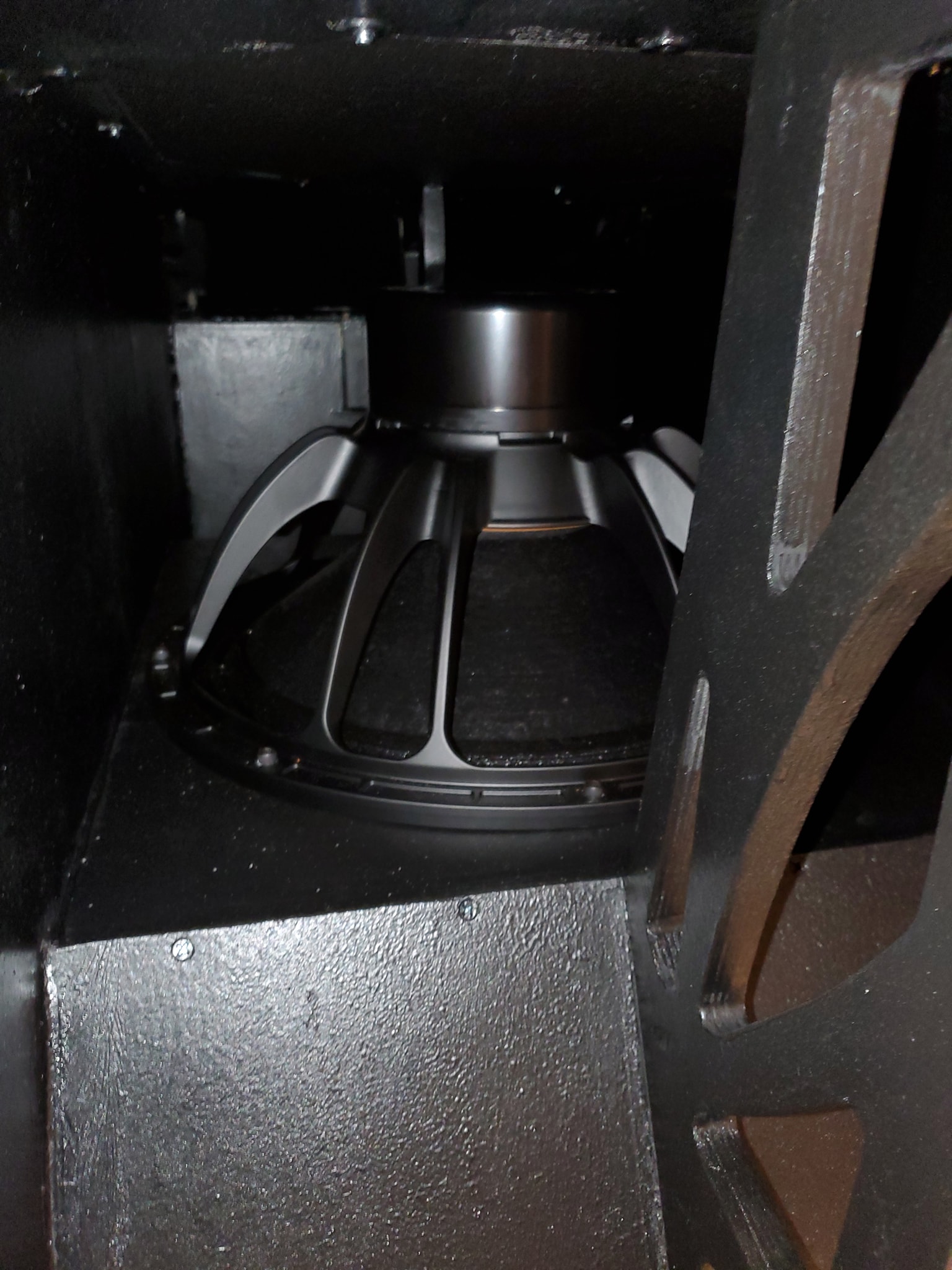

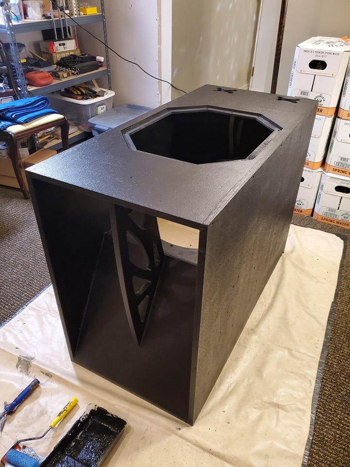

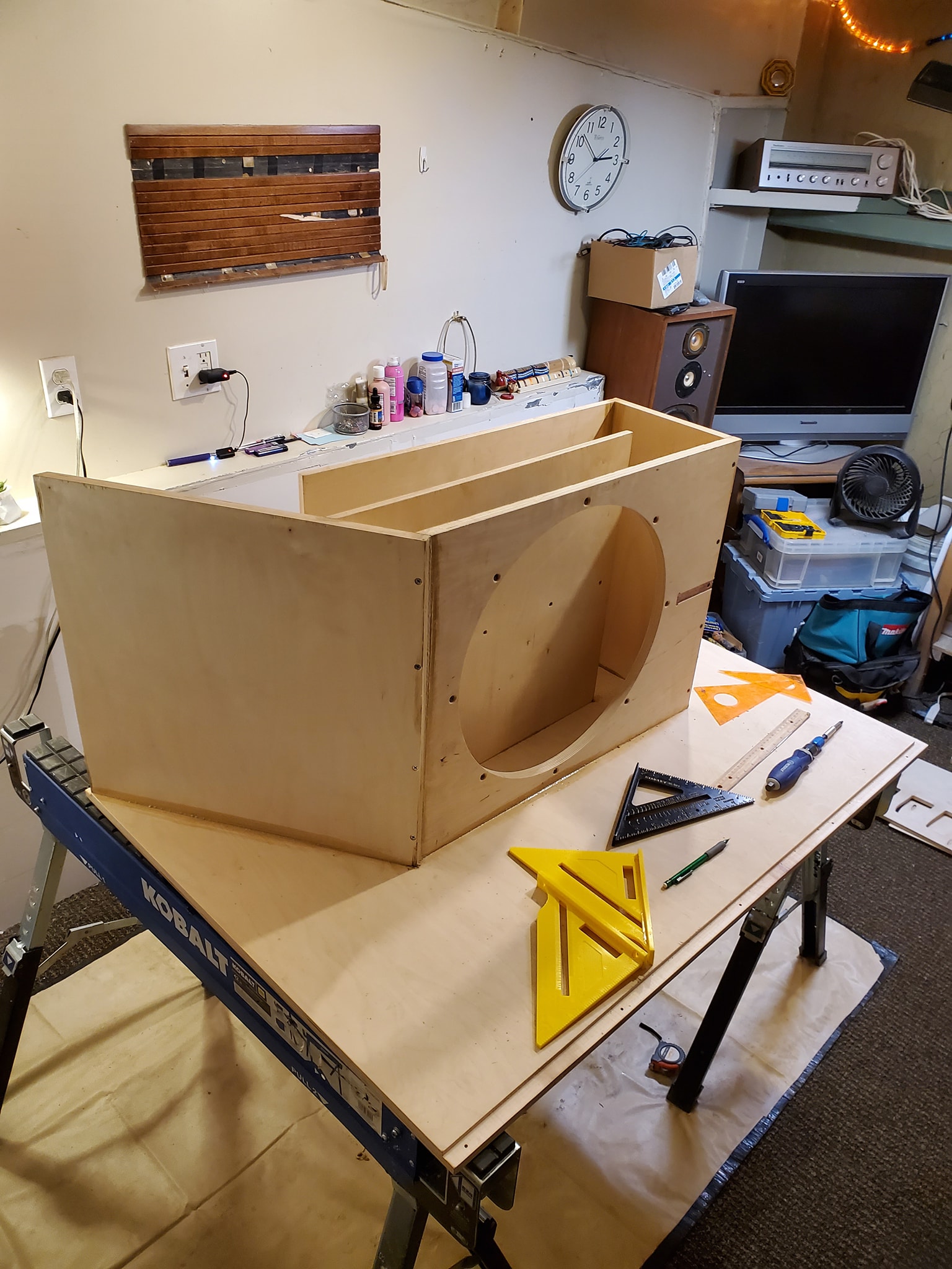

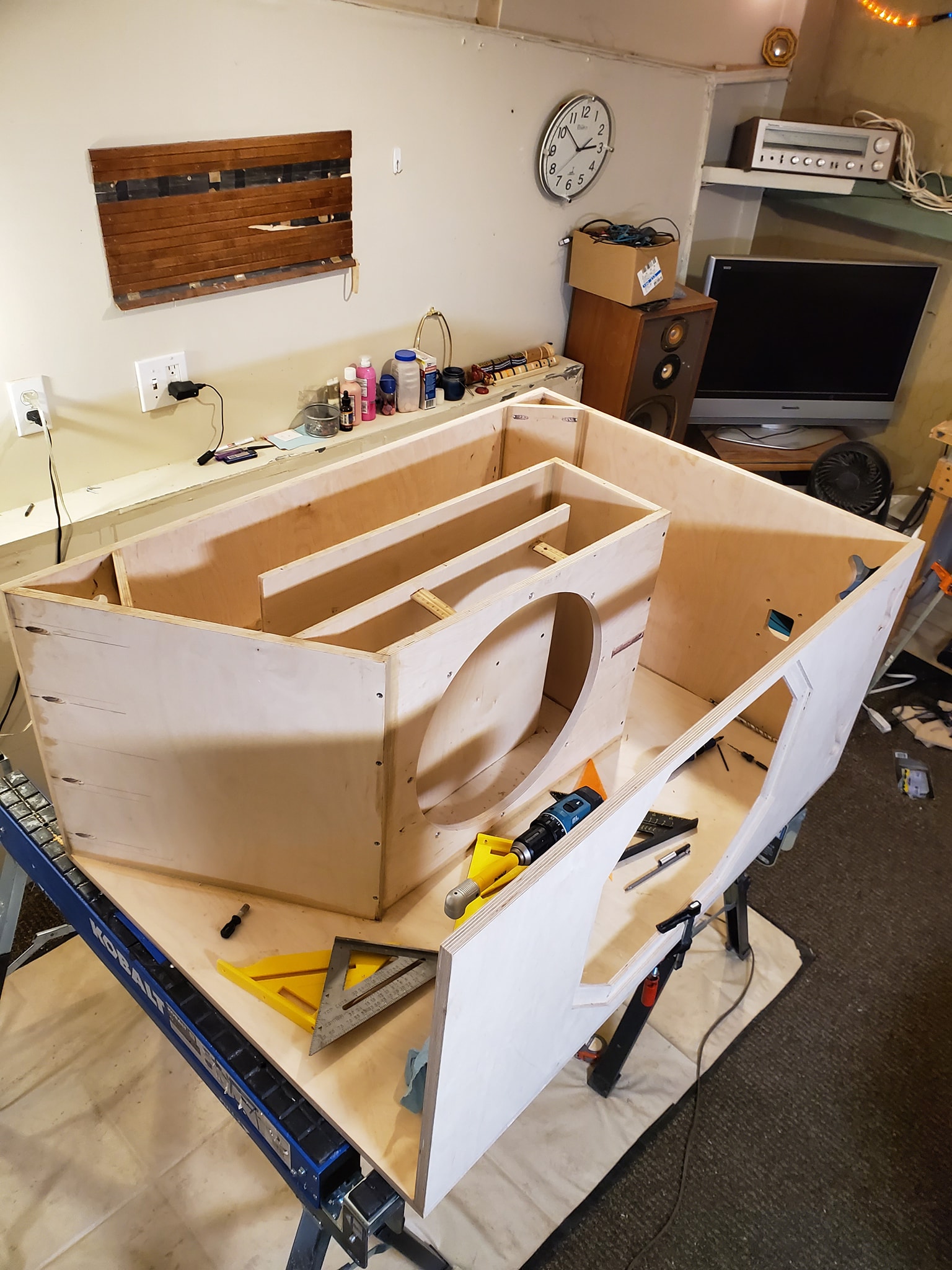

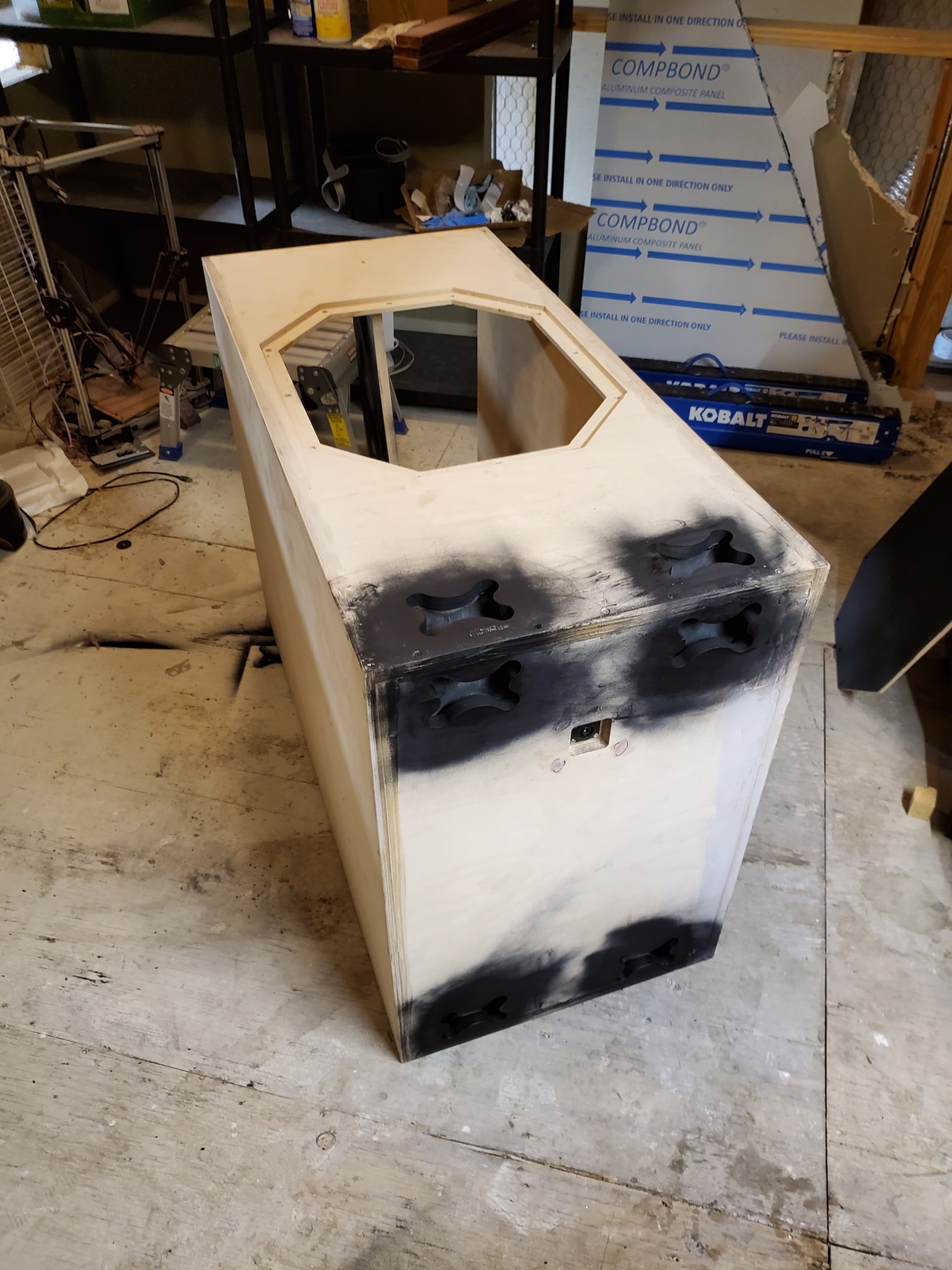

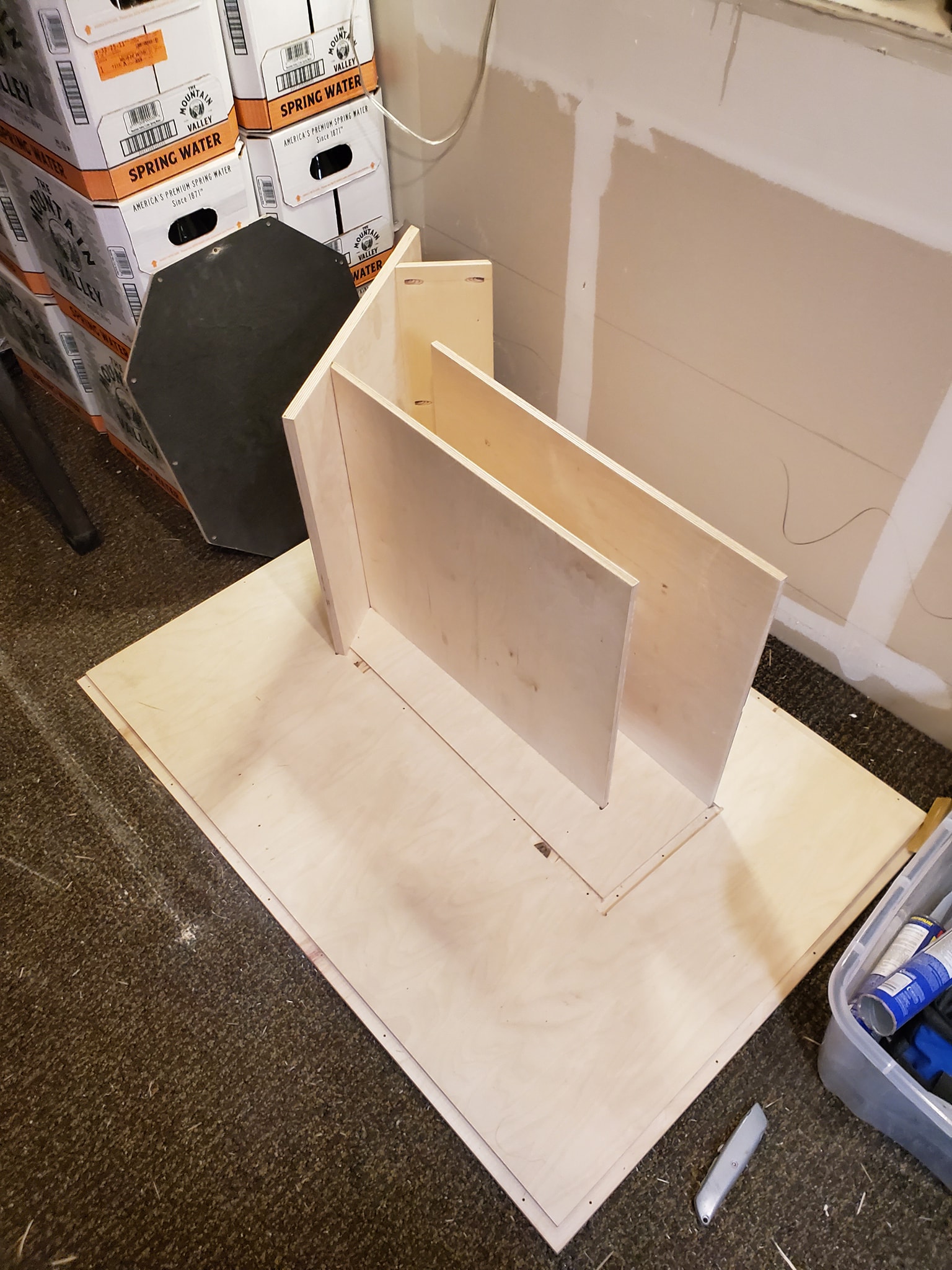

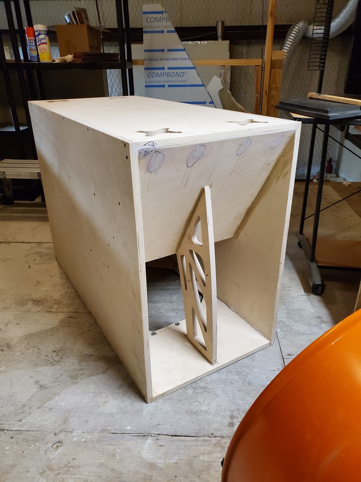

I built it! Twice. Screwed it up the first time, redesigned(simplified) and tried again!
(Redesigned with help from Alethia Sound!)

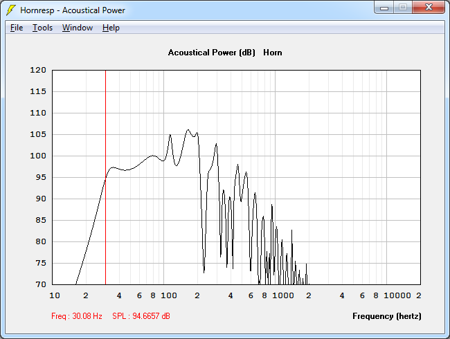

The final hornresp charts
(measurements to come!)

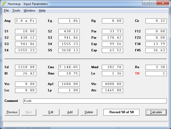

Given the physical layout of that TH, S1 seems to be off, and the expansion between S3-S4 and S4-S5 looks a bit off as well. You might end up with a more accurate model using the "TH1" option in Hornresp, which puts the driver at S3 instead of S4, leaving S4-S5 to be used to describe the expansion after the driver.

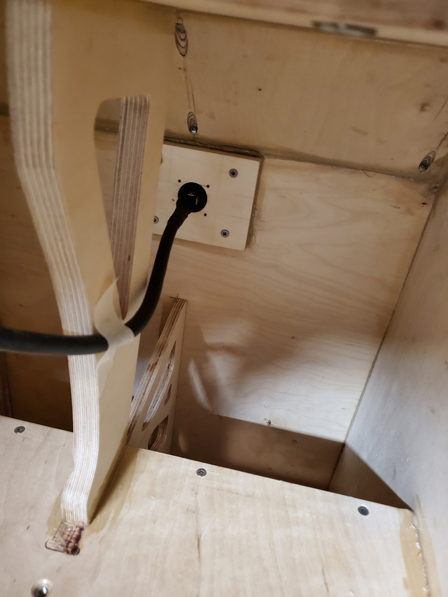

Very nice work!More build photos:
Looking forward to see the measurements 🙂
so how did they turn out performance wise... any measurements yet?
