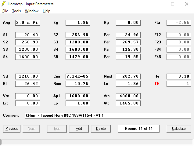

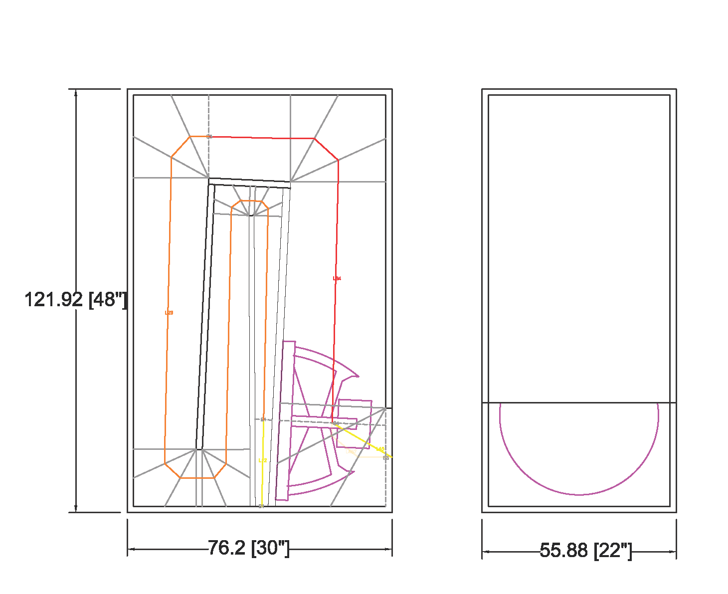

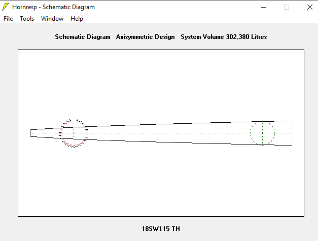

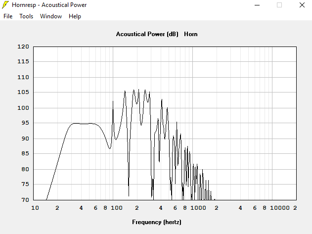

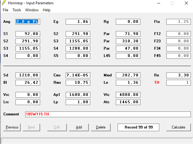

Here is a tapped horn I am designing for PA applications.
I wanted response down to 30Hz and the ability to fit it into my Kia, and looked at the Othorn and Keystone for inspiration (and reference since I am new to hornresp).
This is a preliminary design not accounting for volume from bracing, hardware, or driver. It also uses all 18mm wood, which may be overkill - maybe I should reduce the interior panels to 12mm?
I'm not sure if I measured L45 correctly, but otherwise I think my measurements are accurate. Please correct me if I am wrong!
Any advice, suggestions, or criticisms are welcome!
EDIT: B&C 18SW115-4 shown

What GM is saying is to make S2 larger.
At a high compression ratio the cone "sees" a lot of pressure, and at high power levels the cone will need to be strong to be reliable. At this time you can choose to reduce the compression ratio (increase s2) and avoid well reduce at least - issues.

As a point of reference for KhrisKhad (and akvaro), S2 is around 485 in the Keystone (about a 2.5/1 compression ratio) and VTC (volume of throat chamber) is estimated to be 7800 (a larger volume than akvaro entered), also using the BC18SW115-4.
Hornresp assumes a flat cone (no VTC), while an 18" and the 18mm baffle cut out creates quite a bit of VTC, The large VTC somewhat reduces the actual compression ratio.
That said, even with a strong driver like the BC18SW115 I'd still agree 3/1 compression ratio is about as high as one should go if using the full Xmax/Xvar excursion if low distortion and long cone life are desired.

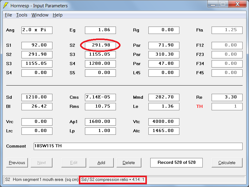

It is not even mentioned as "compression ratio", let alone "CR" :).
The value can however be read from the main Input Parameters window by moving the mouse pointer over S2 (for a tapped horn).
