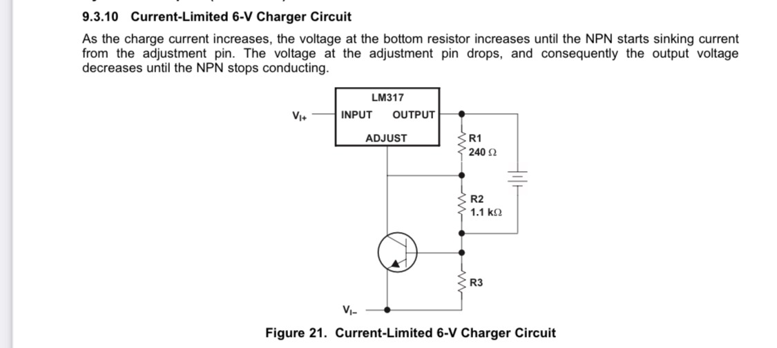

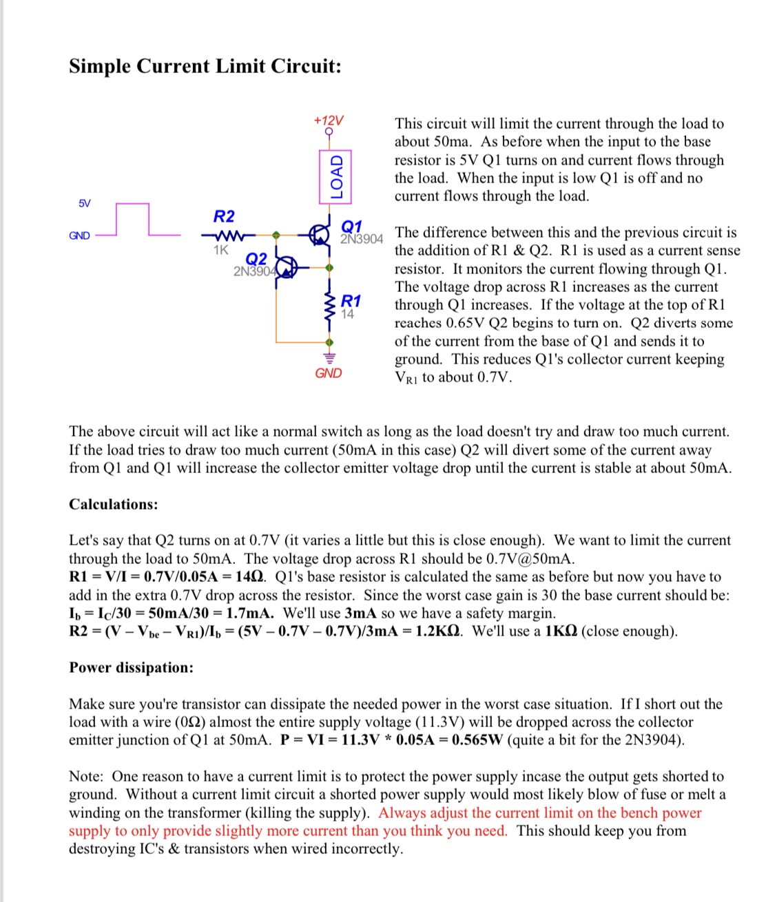

To the circuit above: it is a voltage regulator with a current limiter. It does not regulate the current, because, you can't regulate voltage and current at the same time as they are tied together through ohms' law.
What the above does is regulate the set voltage and then when current exceeds the set limit, limit it, but that then results in the voltage dropping. Either or.
In your case, you could set the voltage at 2.5V. Since the current is expected to be 1.5A, the current limit could be set to 2A so that in case of a failure the output current is limited to 2A. In the extreme case of an output short, obviously Vo would drop to zero but the current would be limited to 2A.
But in your use case the current limiter is not necessary. Look at a simple LM317 voltage regulator, the data sheet has lots of examples. Don't let the many graphs scare you, just ignore them and go to the application examples, like fig 16 & 17. Extremely simple and indestructable.

Current limited to 1.6A is target.
Using NPN?
Need to study a lot

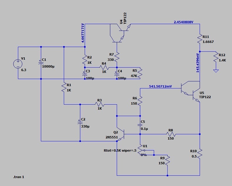

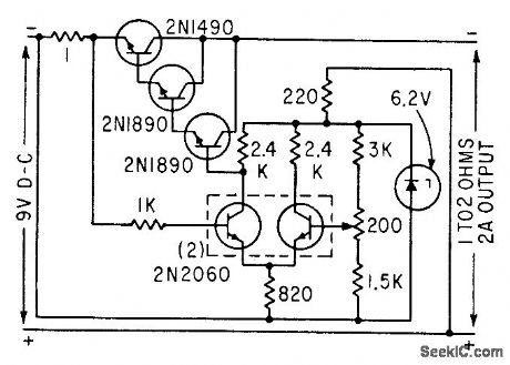

I have built my fair share of heater regulator pcb's
Below a schematic i still want to try. it uses a zener 6.2V reference and a matched BJT to compensate for the VBE drift inherent in these kind of designs.
I will breadboard this schematic and let you know how it performs.
V4lve

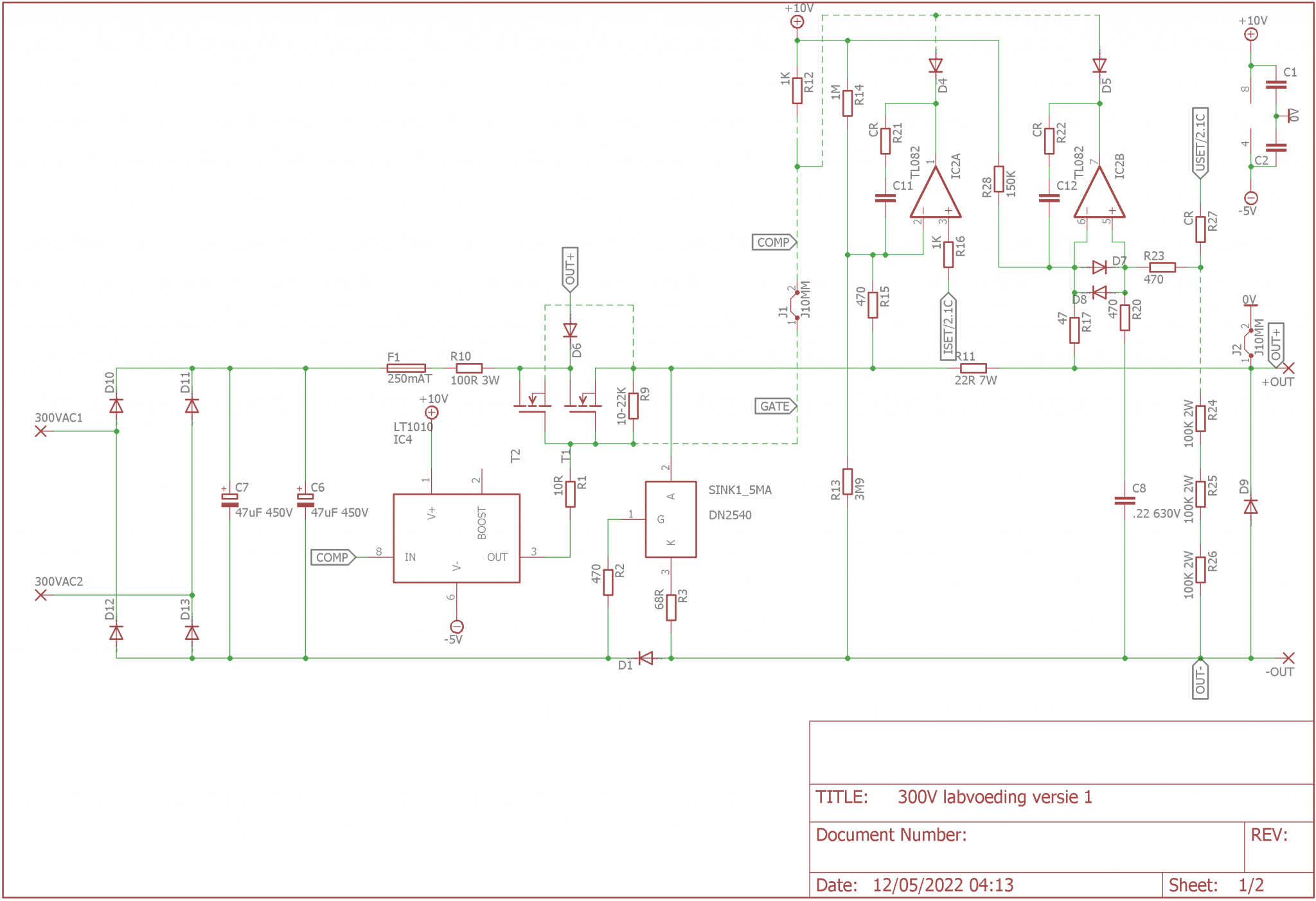

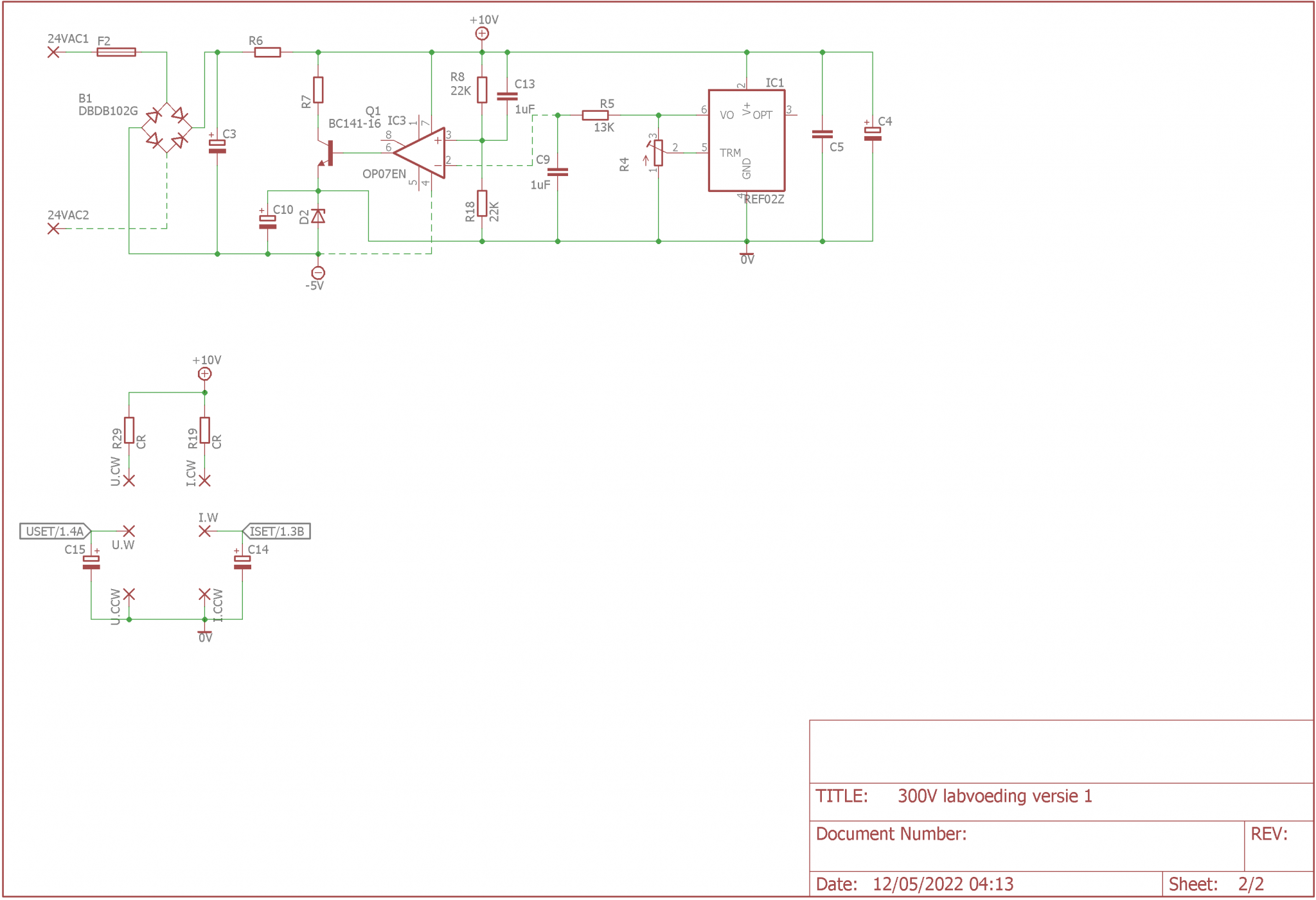

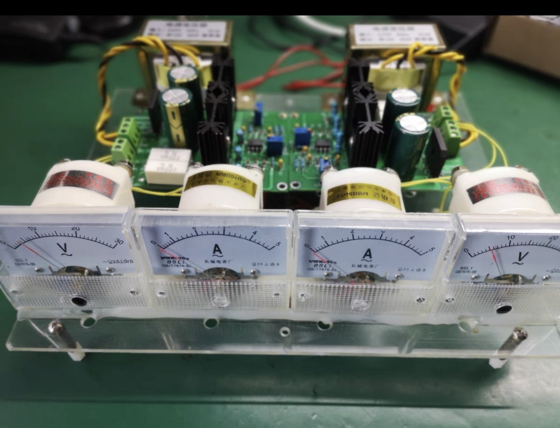

Attached the schematics of my 0-300V 0-200mA Lab power supply, the reference section with REF02 should be altered, as under low VIN conditions the IC will latch up, but the primary schematic is tested and working. its just that the reference is sub-optimal.
Reactions: supernut

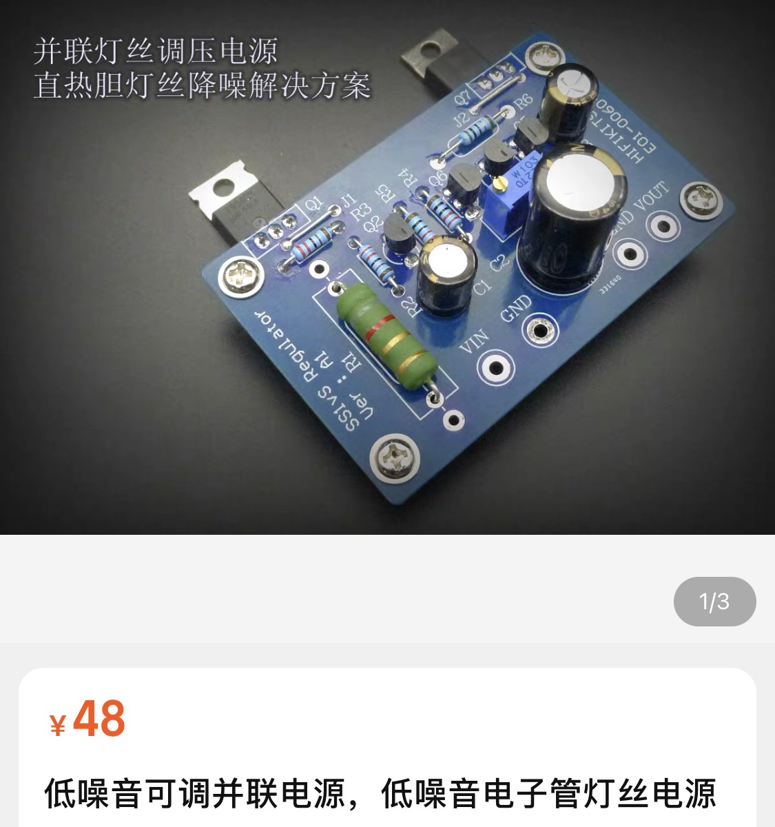

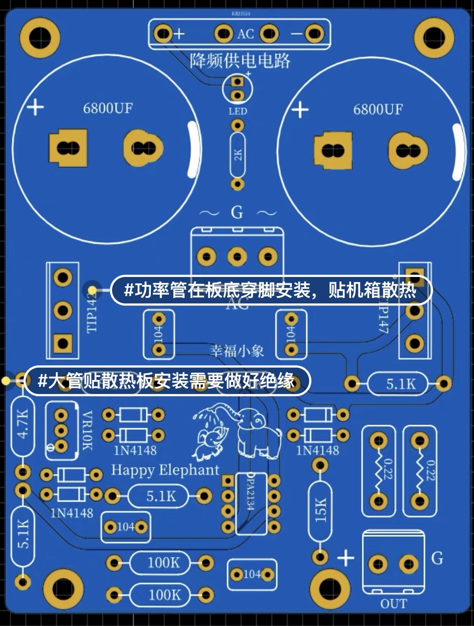

If not filament bias, just 2.5V and let current flow then
These 2 boards seem ok. It is commercial and tested.
If do filament bias then Rod coleman and MR enzo are the choice.
