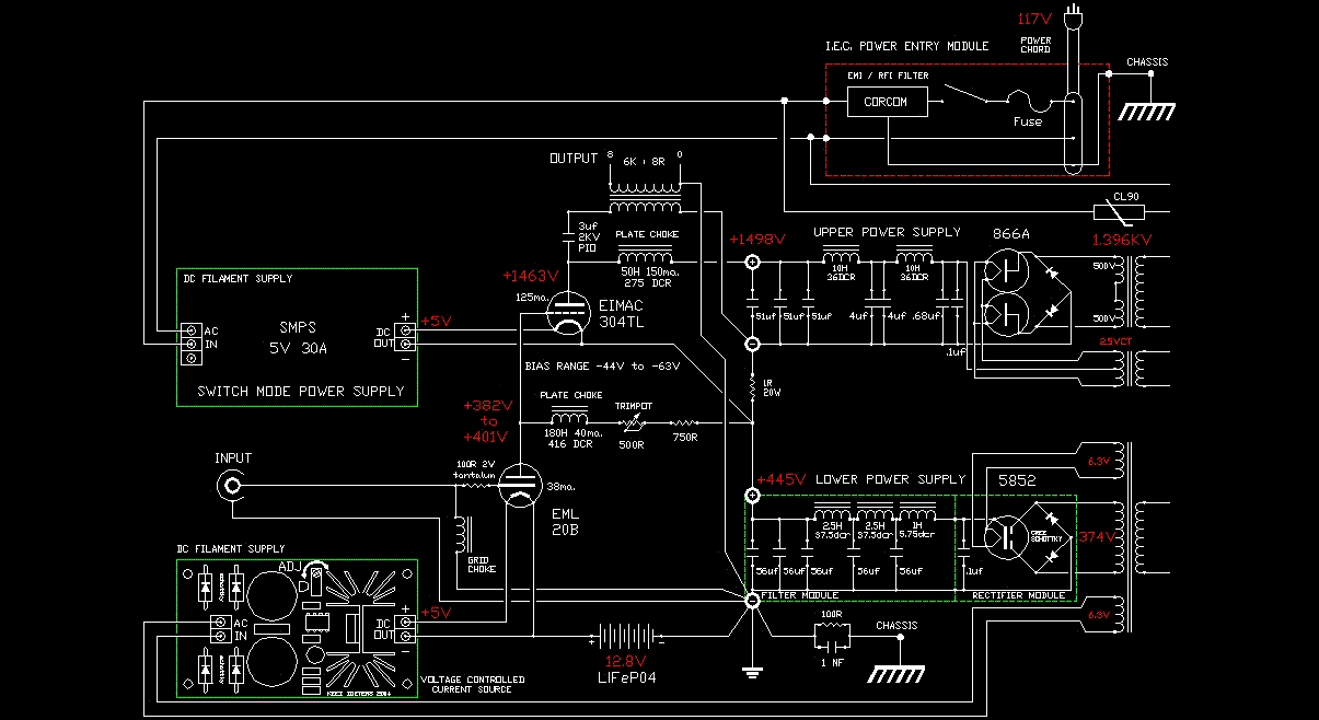

Here's my amp schematic still under development. I just decided to go the Parafeed route on the output. I have some of the iron on order and most of the other parts on hand. Plate choke on the EML20B is a MQ "Dowdy", the plate choke on the 304TL is from Electra-Print. Next couple of days I'll be ordering a Tribute Amorphous "C" core output transformer. Plus a few pairs of rubber gloves and boots!
Jeff Davison
Jeff Davison

Thanks for the schematic, am also moving along slowy, parts in the mail! Having trouble getting my SMPS filiment to start at times, probably just missing something. Ron Parola
Could be the supply going into overcurrent. A cold filament would appear as almost a dead short before its warmed up.
I'd want some serious isolation (electrical shielding) and filtering after that SMPS on the filaments... I would. Just me.
_-_-bear
_-_-bear
Forgive my ignorence, why do you have two different types of filiment supply? I understand not using one for both tubes, but is there a benefit to the voltage controlled source for the 20b? Thanks ron parola
The heater requirements for the 304TL are quite "rigorous" 5 volts but at 25 amps... yep twenty five. In a single end configuration, AC , even with all the "bells and whistles"..ie, hum pot, twisted pair leads etc.. will have a fair ammount of hum. DC is much better, but a normal DC supply (as used for the lower tube) can not be built to regulate all that current. Also finding chokes at 25A is fairly difficult in appropriate (non-microwave) frequencies / Henries, that aren't the size of a small automobile.
Each tube has to have it's own heater supply, they can not be shared as this is a two stage using DHT, where the cathode is also the heater/filament.
AC is said to sound good as a heater voltage supply( but can have a hum problem if not properly implemented), and series regulated DC less so, DC shunt regulation supposedly sounds better than series, and a Voltage controlled Current supply supposedly is the best DC heater supply sound wise. This can supply enough current for the demands of the 20B, but such a design can't be built for the 25A needed for the 304TL.... I really wish it could, but alas.......have to make due with what is possible.
JD
JD
