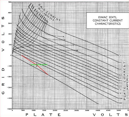

Anyone who has looked at Eimac's published tube curves for the 304TL, has seen that they are not plotted in the traditional manner for triodes, with plate current VS plate voltage. Maybe I'm making work for myself and this is a completely academic exercise, but is it possible to re-plot this data in the traditional form? Can someone help to get me started. If it can be done, I'll do it and publish the results here.
The short answer is “yes”. Often manufacturers of power tubes intended for RF applications show “Constant Current Characteristics” in their data sheets rather than the more familiar “Plate Characteristic” curves. The same data is captured in either depiction. To plot the plate characteristics, keep in mind that each data point involves three linked parameters: Plate voltage, plate current and grid voltage (ignoring grid current for the moment). In other words, for each combination of plate current and plate voltage, there is only one value of grid voltage. And for each combination of plate voltage and grid current, there is only one value of plate current, and so on. Each linked combination of three parameters is plotted as a single point in either type of chart. If you record those points and then re-plot them onto a plate characteristics chart, you can slowly build the familiar looking curves. Knowing that the familiar charts are curves drawn along constant grid voltages, you might start by looking horizontally across the Eimac chart at one value of grid voltage and pick up various pairings of plate current and plate voltage. For example, look at the grid voltage of -50V on the Eimac. That’s an imaginary (undrawn) horizontal line departing from the Y-axis at -50V. At 1000 v, current is about 250mA. There’s your first data point. Then look across and see 1500 volts and 750mA (approximately). You’ll have to interpolate between the lines in many cases. Now plot a grid voltage curve for -50V on your new chart with these data points. With enough points, the curves will begin to reveal themselves. Is all this worth it? I can’t say. I’ve done it before, and it’s tedious.
I will try to explain about the filament(s) again: a 304TL is really just four 75TL's (or two 152TL's) in one bottle. It's not just electrically equivalent to four 75TL's, Eimac literally took the guts of four 75TL's and suspended them around a central support. A 152TL is two 75TL's.
The filaments are brought out in parallel pairs. Two of the pins in the base light up two of the sections in parallel. The other two pins are for the other two sections. Note that a 75TL has a single filament that runs 5V@6.25A while the 152TL brings the filaments out in parallel for 5V@12.5A operation. Maybe we should think of the 304TL as two 152TL's with the filament connections brought out separately.
The bias point of any tube is determined by the difference in voltage between the grid and cathode. In the case of a directly heated tube like this, the filament is the cathode. In order to talk about bias voltage we might take the average of the two ends of the filament. For example, if we heat the filament with 5V DC, ground the negative end, then apply -50V to the grid, we might say the tube is biased at -52.5V.
In the particular case of the 304TL, if we run the filaments in series for 10V operation then two of the sections will be biased at -52.5V and the other two will be biased at -57.5V. That doesn't seem to me like a good way to make use of the four sections.
If you want to heat with AC @10V, then I suppose you could ground the center connection of the series connected filaments. That would put all the sections at equal bias. This trick won't help with DC.
As for the curves in the Eimac data sheet, in principle you could recreate more conventional plate curves from the constant current curves by sampling a bunch of points and plotting them in the familiar way. The problem is that the published curves don't have the resolution you need. You will want to run in the 100 - 300mA range, but the bottom three curves are 0, 250mA, and 500mA. To plot a good set of curves you would need at least a few more constant current curves in there. Go ahead and try....
The other problem is that the data for tubes like this (big class C transmitting tubes) seems to be somewhat unreliable at the operating points we want to run for class A. In other words, even if the constant current curves offered enough resolution, the resulting plate curves that you derived from them would probably be wrong. So much for all of your time spent gazing at plate curves to find the ultimate operating point.
I will offer the same advice I offered before: build the amp with variable B+ and grid supplies (you would want to anyway, even if you had a very specific operating point in mind) then just twist the knobs on the variacs until it sounds right. It's only two knobs. Really just one knob if you limit yourself to running at max plate dissipation as the tubes were designed to be run: try different plate voltages while keeping the bias at whatever it needs to be to keep the plates visibly glowing orange.

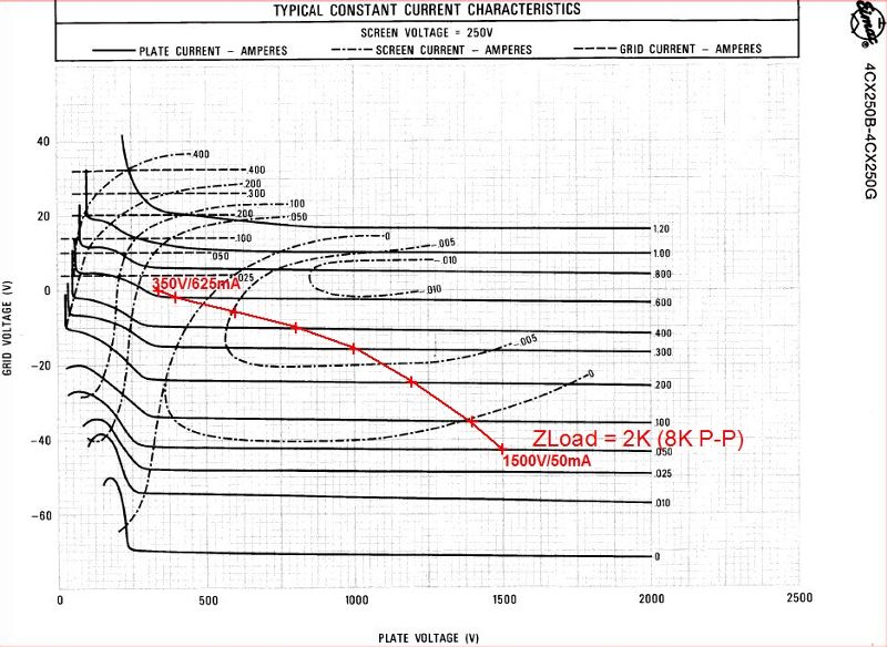

Just plot the load line on the constant current chart. It won't be a straight line, but then neither is a real life load line. You can still use it in the same way as a load line plotted on a plate characteristics chart. I calculate the V/I intersections based on the load impedance starting at the idle point as below:
Ok that plots not supposed to be for a 304tl is it? I see its a 4cx250. Just wanted to get a little clarification.
It is a 4cx250, which I used to illustrate the process because I already had it worked out. I haven't worked out a load line for the 304tl yet but for class A you would do the same process starting at the quiescent point and work the slobe both directions above and below.

Hi Jeff,
Sorry, I was out of town for 2 weeks with no internet access. Kind of nice actually...
It sounds like you picked an interesting project with some serious industrial design opportunities.
I would first look at what your loudspeaker load is and what damping factor you like, plus power level. Then think about an output transformer.
Here is an example class A1 starting point of 35-40W Po using Zpri of 5K ohms. The plate resistance of the 304tl at this point is about 1500 ohms. This will give you a DF of about 2.5-3 depending on DCR of the OPT.
You will need enough plate dissipation to get a red color for good tube life. The op point below is about 150W Pd, which may get you there. It could be scaled up in voltage if needed.
The drive requirement is similar to a 300B in terms of voltage and driver load capacitance is about 75pF; about 1.5X that of a 300B. There may be some grid current as you approach 0V at peak plate current. Rgrid circuit in non-grid current mode is 250K ohms maximum.
I think a 2 stage topology is perfectly reasonable (I think I have seen a 15E driving a 304TL in one of Jeffrey Jackson's amps). I think you will want a mu of about 40, so a 3C24 may be a little low. Maybe a 25T or 35T would give you enough gain. I have had great results using a stacked mu-follower to drive grid current on Eimac tubes. See:
