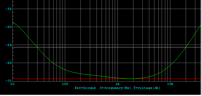

Just as a matter of interest I decided to sim my design with a Leach cascode front end (pictured below) to check for PSRR. This can be compared with my cascode front end at post 40 -
http://www.diyaudio.com/forums/showthread.php?postid=786965#post786965
Greg

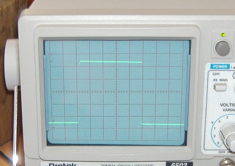

Between festivities and libations I decided to build a new piece of test equipment to test my amps - a 10KHz tailored impedance square wave generator. I needed one which had sufficiently fast rise time and worked into a capacitative load, so I could bypass the Rinput filter and test closed loop character. A very fast rise time better stimulates the UHF character of an amplifier.
Spec : 10KHz, rise time < 400nS , fall time < 100nS. Zout 47R //1000pF.
Here is the GB300D with it's output . no 160KHz input filter.
Greg

I think not mastertech,
Interestingly the rise and fall times are virtually those of the square wave generator... so I guess I'll need to do an even faster one.
That's the trouble with building really fast amplifiers, in this case full gain bandwidth >5MHz, is that your equipment has to be upgraded as well.

What is the V/DIV on your picture Greg? Without it seems difficult to ***** the result!
5V/div??

Jens, you can actually see the knob at 1 V/div. Check the black stripe on the knob.JensRasmussen said:Home sweet home

When I cropped the photo I left in the V/div selector. 1V /div.
It's roughly 1W. The sq wave gen's just a lashup at present. Needs a box, connectors and a pot for functionality.
greg
I know, I was unsure about the x5 botton......
I often use a x10 probe, I thought that you might do the same
How about a rail to rail pic?
\Jens
Hi Jens,
There's no way I would do a rail to rail at 10K sq wave with 3MHz BW.
It's inviting disaster, irrelevant and stoopid. Such an amp to handle this could easily be built but would add complexity unwarranted for audio. But you knew that.
The max I would test , bandlimited, at 10KHz is about 50W for this size of amplifier. I'm happy with that as it meets practical requirement.
Perhaps I've been doing this too long?
Greg
