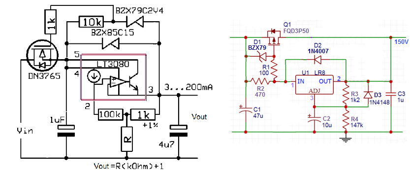

The LR8 (and the LR12) are basically an LM317 with a high-voltage DMOS pass device. App circuits can be calculated in the same manner.

Hi Kevin,
Just curious. Wouldn't a D-Mosfet like an LND150Nx be a little easier to deal with? You could use a DN2540Nx if you needed over 1.5 mA.
The LR8 looks like a pretty cool part. I'm going to get me some 'o those!
-Chris

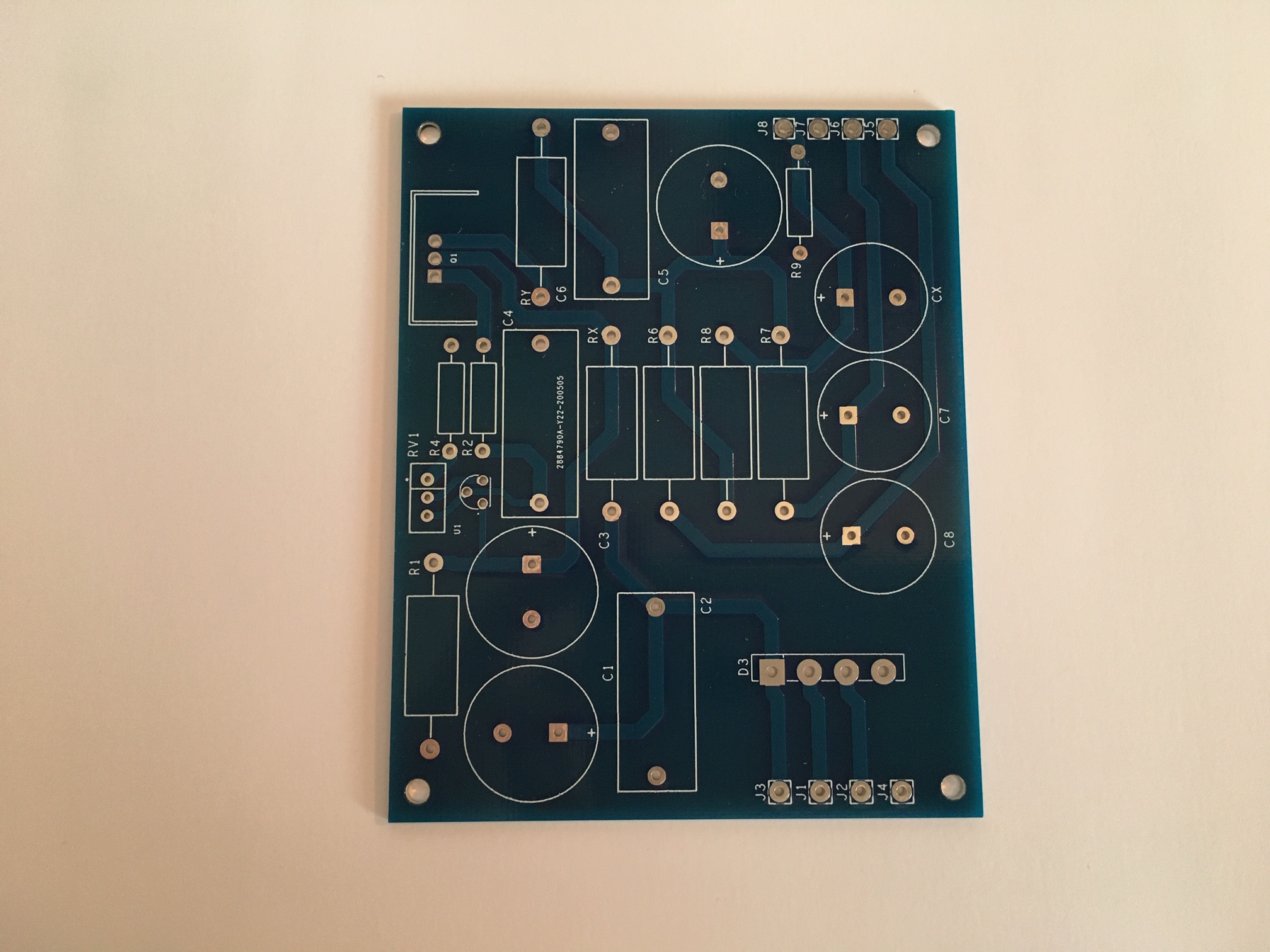

I design for the load current, my designs all use high transconductance triodes and operate at the current listed or above. The LND150 would fry in seconds at these power levels. As long as the gate stopper is located at the gate I've not had a problem with any enhancement mode mosfet. I don't use depletion mode mosfet as followers in power supplies. There is no problem either way, just a design and cost consideration.
Hi Kevin,
No, for the CCS portion. There is nothing wrong with your pass transistor that I can see.

I exclusively use the LR8, have been for years. It is deceptively simple yet super reliable, I can honestly say that I have never had an issue with it, it is rock solid, super quiet and clean!
A lot of the circuits I have seen here are good, but, in my personal opinion, over complicated, when compared to the LR8. I believe in the KISS principle! 😉

Why would I replace the wonderful LR8 voltage regulator IC with a zener string and a CCS? There is no CCS in this design. I can set the voltage to anything I want, it has quite decent ripple rejection, noise performance, short circuit and thermal protection and much better precision than I could manage with a zener string. Can withstand over 400V on its input terminal. It also costs less...
I use both IXYs and Supertex depletion mode mosfets in the cascode CCS/mu-followers in my active circuitry, most are running at 10 - 20mA depending on the end purpose

If we can take you at your word, then you would absolutely love the LND150Nx and DN2540Nx D-Mosfets. A CCS consists of one resistor and one of these devices. You end up with a two terminal current source. It's done the same way as with a J-Fet.A lot of the circuits I have seen here are good, but, in my personal opinion, over complicated, when compared to the LR8. I believe in the KISS principle!
-Chris
See my comment above. CCS is nice but I like the LR8 better, just accept there is more than one way to skin the cat, and we don't all want to do things the same way as you would. I would have to use a string of qualified zeners for regulation operating at much higher current to get anything like comparable performance, more heat and more cost..
Hi Kevin,
Fair enough. I thought you were using it as a CCS after seeing the stack of resistors. Obviously I needed to look more closely at your circuit.
-Chris
-Chris
😀 I don't advocate it as the last word, but it works well and has been very reliable in a reasonably large number of builds. I use variants of the design to power a stain gauge pre-amp and 3 different RIAA phono stage designs.
It's designed to be cost effective, a good performer and reasonably consistent in performance. Variability of output voltage from sample to sample generally seems to be around 1% or better for parts from the same lot, basic tolerance is a few % and rarely worse IMLE, zeners are 5% typically or worse and have to run at higher current for good performance, and they drift..
