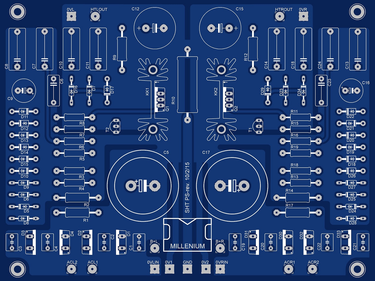

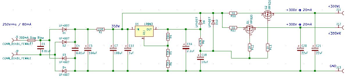

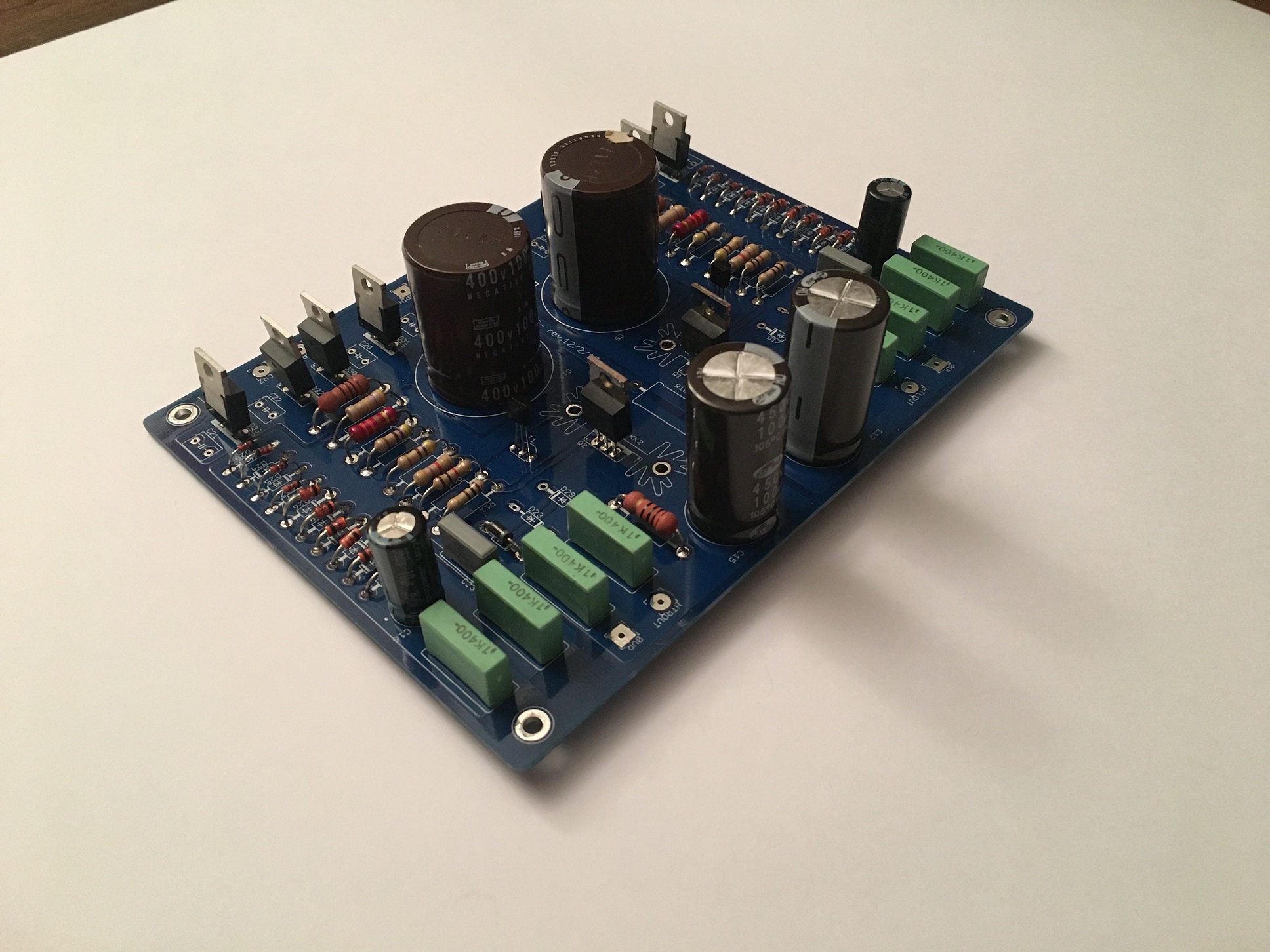

The R1 and R9 are just to limit the in rush current on power on but can be omitted.
In every case the ripple is very very low. With or without (U2 song)
About LR8 it is very interesting and now I am playing with it for a variable HT with a good success ( with a power fet )
At 300 Vdc with 60-80 mA the ripple residual is 5-10 mV rms
Walter
Walter

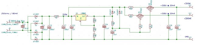

Hi Tim,
Yes I'd be delighted to share, but regard this as a guide, it's certainly not the last word. I do recommend if you think there is any likelihood of an output short that you add a 15V zener from gate to source. The resistor string in the feedback circuit satisfies the LR8 minimum load requirement to properly regulate while not putting much of a load on it .This is what I use in my phono stages and it has proven quite reliable over about 25 samples (group buys) over the past 3 years or so. You can safely change the gate resistors to 220 ohms if you are concerned about the noise contribution of the gate stopper resistor.
