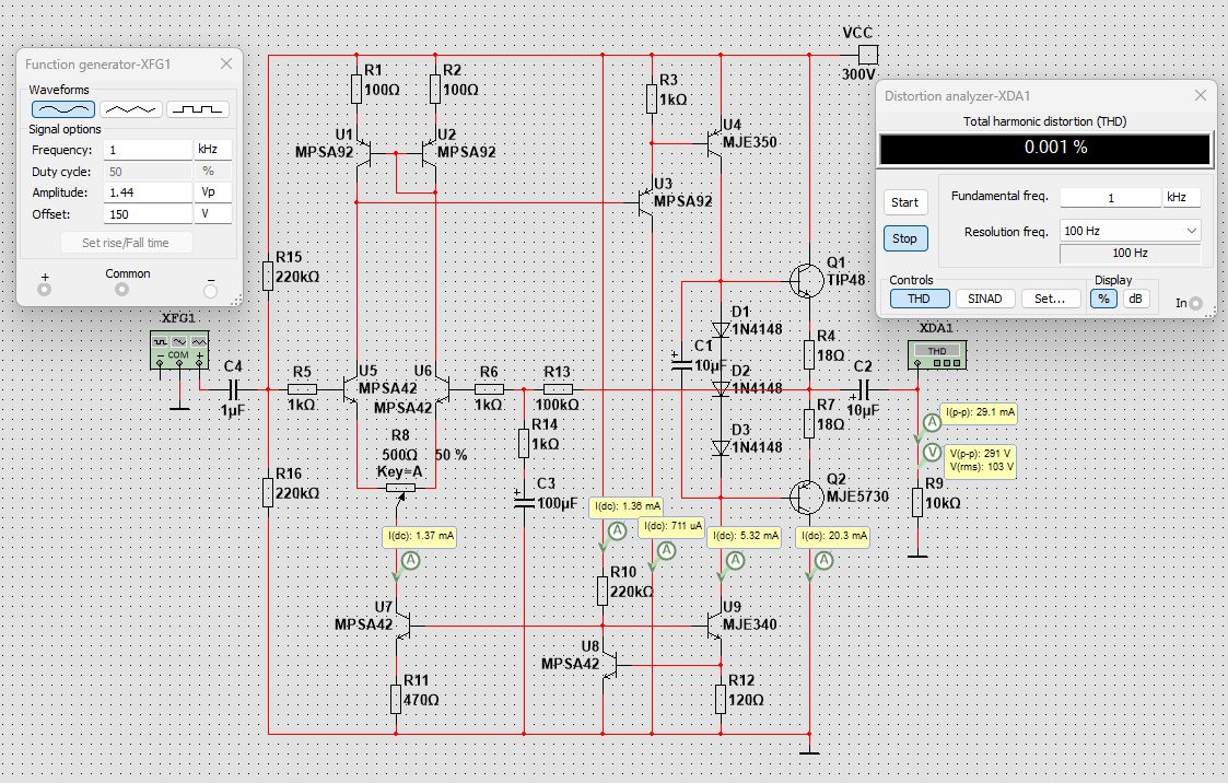

300V Discrete Opamp - Real Madness!
All transistors are 300V devices.
The example shows 1.44Vp input and gain x101 gives output 291Vpp.
Distortion is THD 0.001%
Do not build this ...! 😀

Btw, that 10uF output cap seems rather small. Are you sure its not 10mF?
If a amplifier has 10u in the front it is "too big" and then if it is on the output it is " Too small"
At the end of the day with 10k impedance the cutoff frequency still remains 1.59 Hz
More than fine for audio bandwidth.
Being 10u the most generic value ever used with opamps.
Far as " 40 watt" transistors needed for " SOA"
The bad news for the experts is IC's never have or never will use 40 watt transistors
for 10k loads or usually higher
If anybody tossed in a few diodes for crude anti latching and flyback / current limiting
it would be vaguely impressive and likely all that is needed to power whatever imaginary audio application
needs 300 volts of small signal other than a tube amp. using a basic triode with absolutely no magical nonsense.
Using some mystical magical unknown 600 volt capacitor that existed sine the 1900's
100 years gone !! what should we doo doo oh no !!

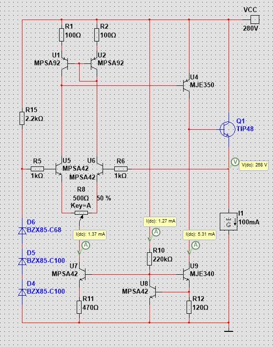

I post this circuit again.
It is a simplified version working at 280V.
This is the use we can expect. A regulator for high voltage.
Gives 268V output.
