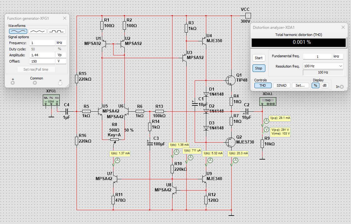

Looks doable, i believe i got all the parts.All transistors are 300V devices.
The example shows 1.44Vp input and gain x101 gives output 291Vpp.
Distortion is THD 0.001%
Do not build this ...! 😀
Not sure why others are criticizing safety when its cap coupled. Besides, tube guys here work with 400VDC minimum.
Btw, that 10uF output cap seems rather small. Are you sure its not 10mF?
If a amplifier has 10u in the front it is "too big" and then if it is on the output it is " Too small"
At the end of the day with 10k impedance the cutoff frequency still remains 1.59 Hz
More than fine for audio bandwidth.
Being 10u the most generic value ever used with opamps.
