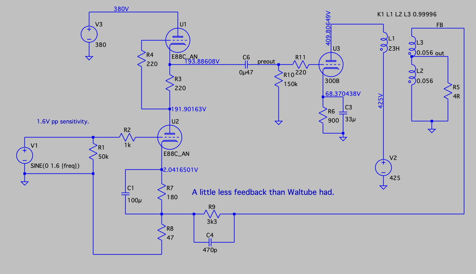

Oh boy... 😆 , thanks for spotting.
E88C seems to be unobtainium as well. So I would need to use a diff one if I opted for the SRPP variant.
What I can’t understand is the approach of the problem
With the circuit I sent you can find a good gain, good linearity ( not as ecc88) reasonable low Zout
And it is tested !
And the E88C is not so expensive compared with some others
In addition you can try the mu follower configuration checking carefully the bias point
The EF184 is good as triode with 55 of gain ( theory) and 5k5 ohm of Rp but the Cin in not low
The E280F is also good but expensive
Ec8010 is good
Ec8020 the best
Walter

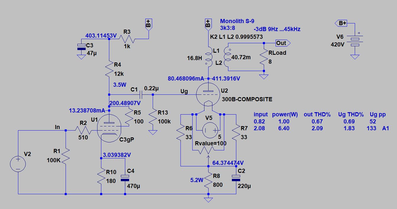

I usually use D3a/E280F/E810F/E180F or C3g/C3m/(rare)C3o trioded pentode as VAS stage.
One of the simplest architecture:
The pentode replaceable with any good high gm pentodes listed above.
The VAS stage linearity can be increased if you use choke/interstage or active (CCS, gyrator) loading.
My favorite is CCS loaded D3a or C3g stage.
Reactions: mz543578854

The LTSpice voltage source is peek, so 2.08V peek is 1.47V RMS.
I don't see a "2.08Vpk voltage source"; C3g cathode is at 3V so the grid can accept 6Vpk-pk which is perfect for 2VRMS.
This is in line with my experience for C3g in triode as input/driver for a two stage amplifier with 180V anode and 15mA current.
In case of choke or interstage transformer loading the mu of 40 will also be the voltage gain.
300B grid requiring ~ 50VRMS will be perfectly driven by a C3g triode stage.
@Rod: the x number of Siemens NOS C3g's I used as input/driver were very stable w.r.t transconductance a.s.o. so they biased perfectly. Headroom with inductive loading is not an issue as you will know. Agree that a well designed pentode stage is a good option as well.
And it is tested !
Using the the E88CC was a mistake by me, because I did not read carefully enough to recognize the missing C. If at all possible, I typically try to simulate to get an impression and to be able to compare, since it is not possible to build all possible options 🙂 .
I have now found one good source for the E88C. Indeed it is pretty inexpensive. When I wrote "unobtainium" yesterday, I hadn't been able to find any shop I could buy them.
Ec8010 is good
Ec8020 the best
I will not be able to design a driver stage myself. That is why I asked for schematics having a sensitivity matching my system well.

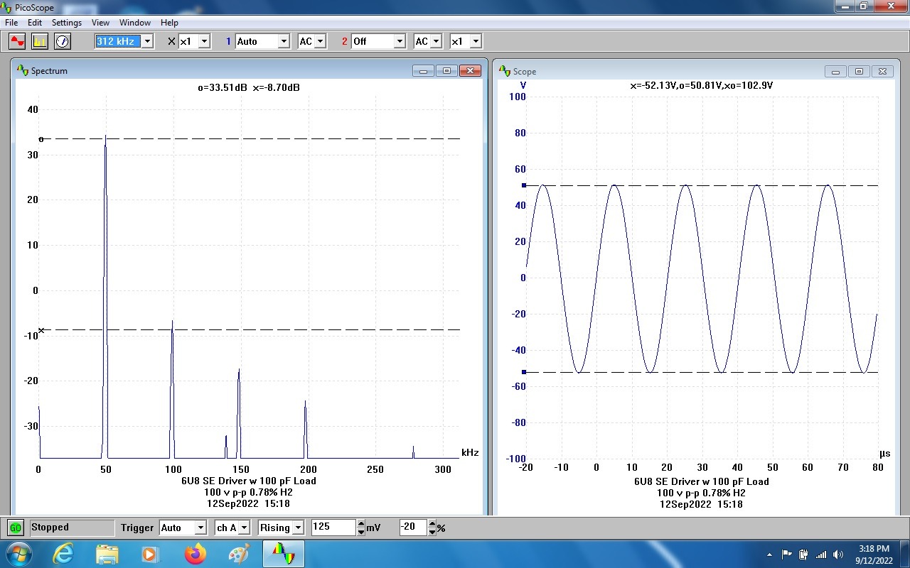

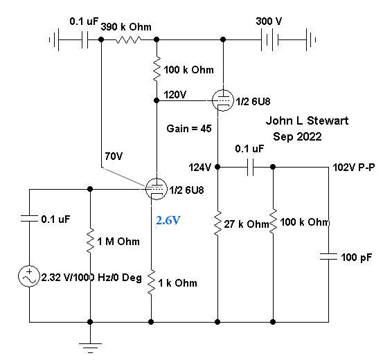

Here is yet another solution, posted here on DIY a while back
It was meant to drive a 2A3 I recall, the 100 pF load was intended to simulate the 2A3 Miller effect.
Many will reject it since it uses a pentode as a voltage amplifier. Pity! 😀

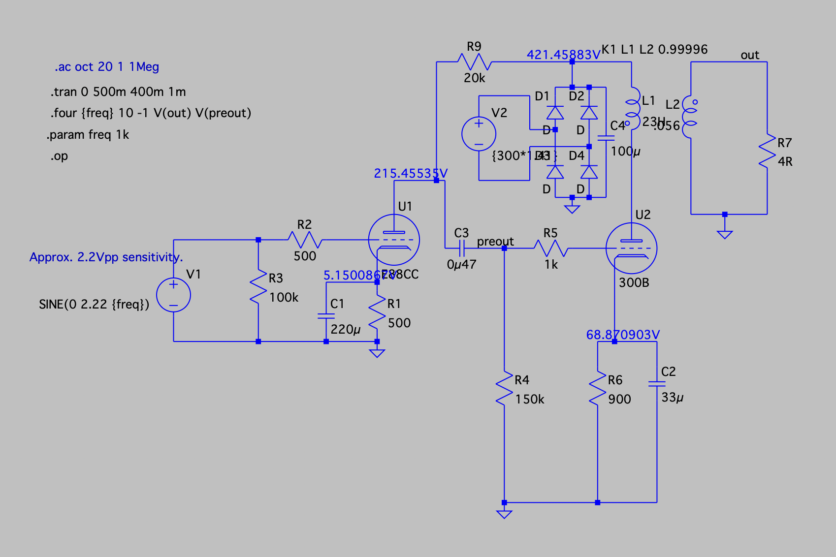

Weather was really bad here and I had lots of time hammering spice...

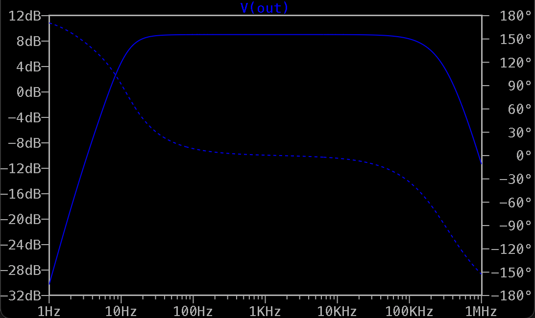

I might have found a simple driver meeting my requirements. The circuit has a sensitivity of about 2.2Vpp, so has some headroom too. Can you experts confirm this should work fine? And maybe check my 6DJ8/6922/E88CC setup if it needs to be improved / corrected? According to LTSpice it looks OK, but who knows? Any comments?
Vin: 2.22Vpp = 1.57V RMS, so enough headroom
P: 4.63W RMS
THD: 3.125%
