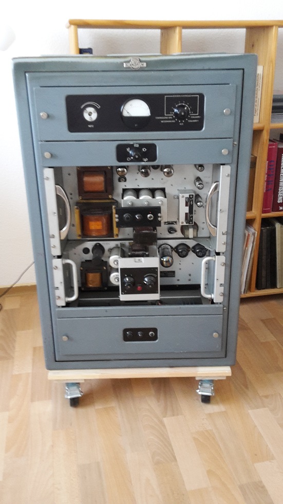

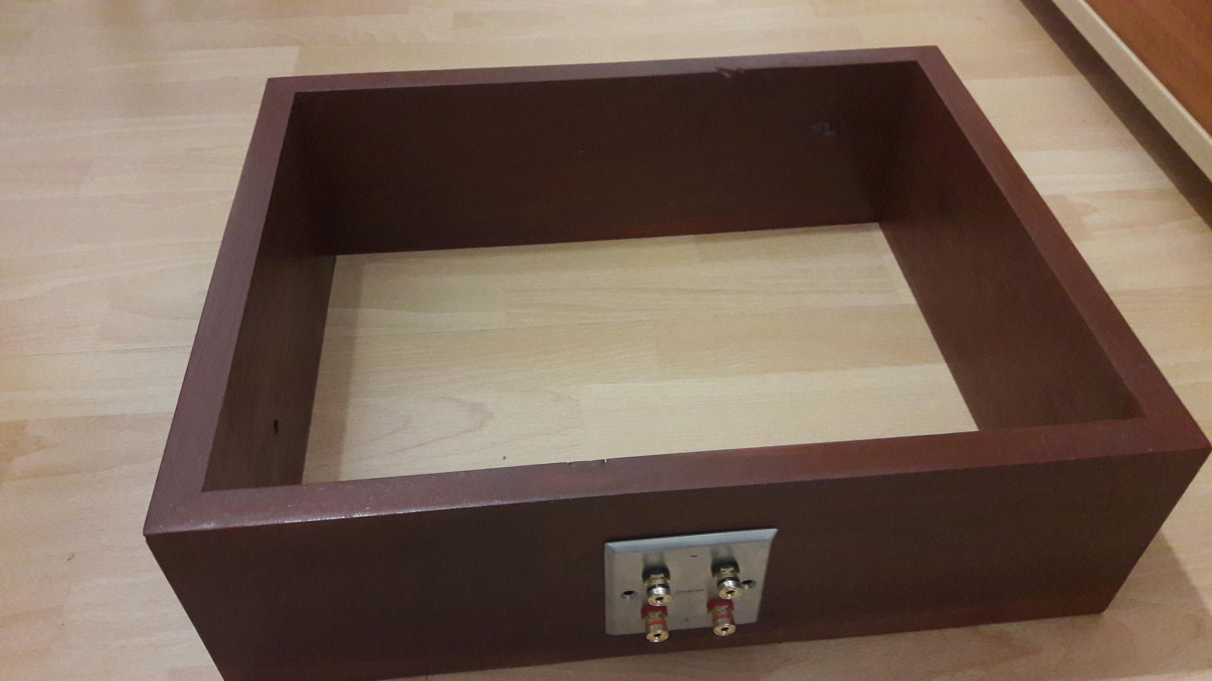

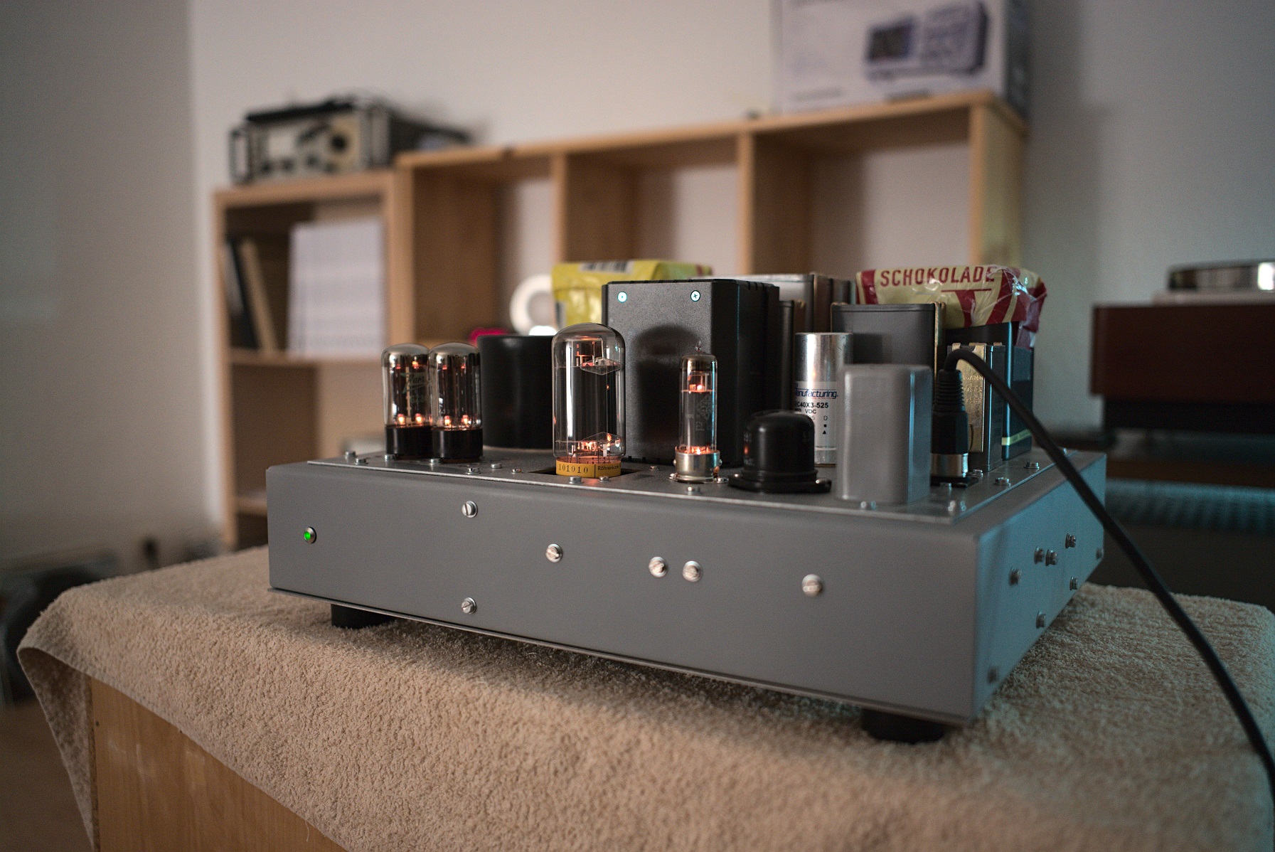

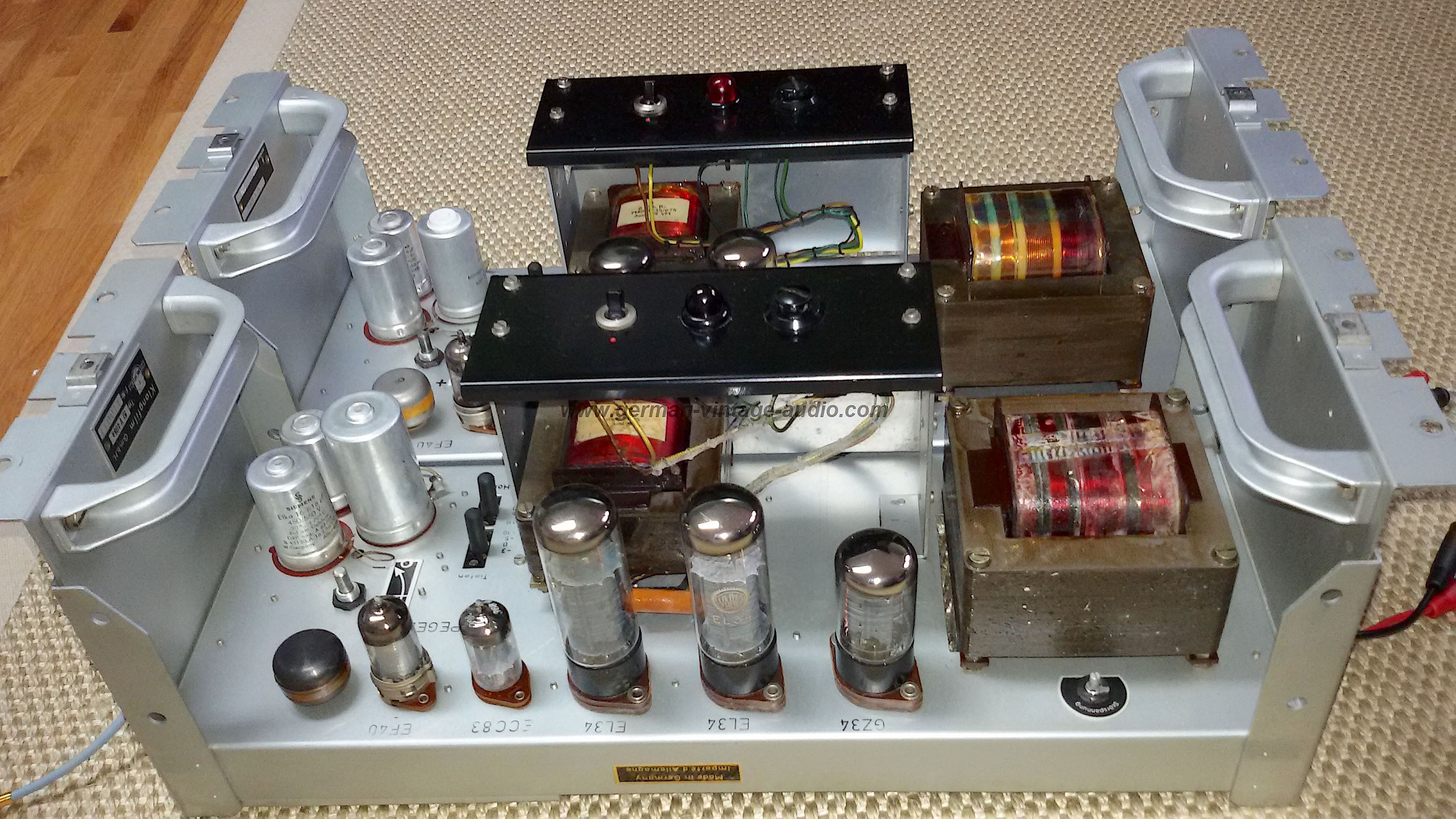

Hey! That's a lot of good information! I've been tinkering with my box for now and soon I'm going to buy top and bottom plates for the amp, here's a picture what I've done for now.
Always wondering wether people try to build electronic gear or furniture when this is the starting point.
No one, expect DIYers, wrap wooden frames around electronic gear since the 1970s. Its so outfashioned...
It's electronic gear 🙂
I fear it will never become gothic🙂
Well as we would say, every man has his taste 🙂
@Deva009: Nice wooden frame! Well done!!!
You are right, a nice brushed aluminum top and bottom plate, and it will look fantastic!
I like the "antique furniture" look - especially for amplifier designs that hark back to the 1930's.
Have fun! - I am sure with this kind of care, your 300B amp will sound fantastic! - Please post pics as you progress. 🙂
