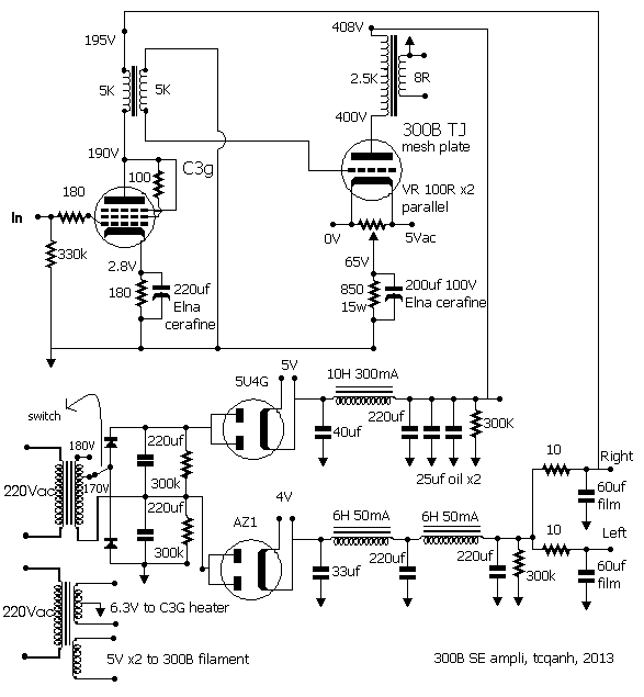

Yes, according to the actual maths, the circuit should work just fine.
According to Miller Effect (Slew rate current) | VT52.com :
300B:
A = µ = 3.8
Cga = 15pF
Cgc = 9pF
U = 40V
f = 30kHz
Ig = 2 x π x 40V x 30kHz x (9pF + 15pF(3.8 + 1)) / 1.000.000.000 = 0.61mA
yet at 70V swing the 300B requires 1.07mA
The Ultimate 300B has 2.5mA or so sourced from the paralleled-12AX7 SRPP driver stage.
That's almost 2.5X the minimum required plate current to drive the input capacitance of the 300B at 30kHz to 70V peak swing.
I don't understand the insanity of that thread.
Now, whether or not that's the 'best' way to drive a 300B, I really don't know and cannot say. But there is a good theoretical basis for why that circuit should work fine.
So there.
PS - "Ultimate" literally means "final" or "the last one". It does not necessarily mean "best".

12AX7 is a wimpy driver tube for a 300B.
Much too complicated and sophisticated concept. Use a real beefy driver tube and your done. No SRPP double parallel nonsense.
