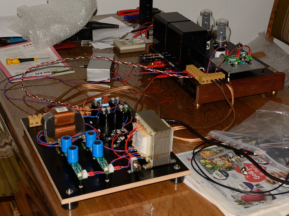

If the B+ with PT etc. was moved to a separate box or board. How does that work in general with wire connection and high voltage connectors etc.?
I watched at the "Bartola" homepage that is seems very long cables (DC) from the PSU to the amp can work. The filament reg. has to be close to the tube of course.....but not necessarily the B+?
It is really the "PSU stuff" that is the most complicated in a tube amp.
Now I finished the external PSU (B+ and Rod Coleman Raw PSU). Next step is to build what is necessary in the amp itself. It will be wire connections and the Rod Coleman filament regulators and mount the cathode resistors without the hum pots.

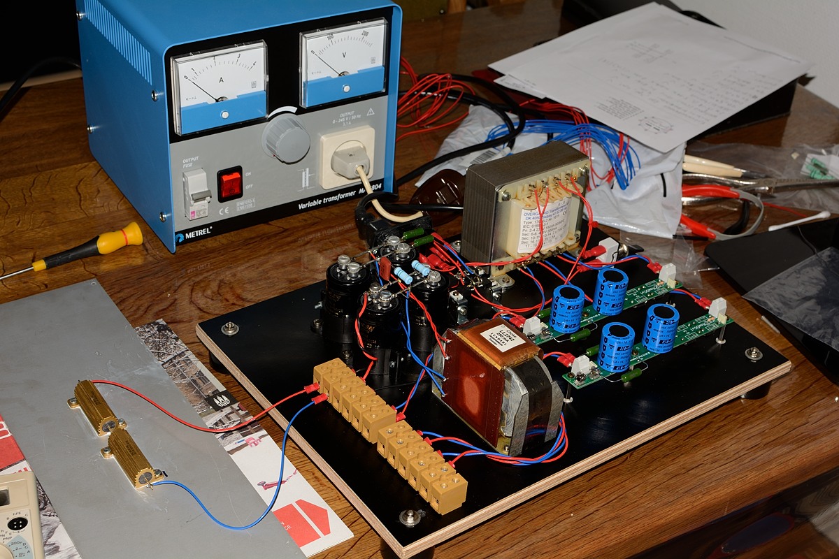

I tested the B+ using 2 x 2k 50W resistors in series as load mounted on an alu. board as with 535 VDC and 130 mA it generates some heat. After re-designing the PSU going from a simple C-R-C filter to a R-C-L-C filter using a Lundahl double choke in "common mode" configuration the B+ was more or less spot on the expected value.

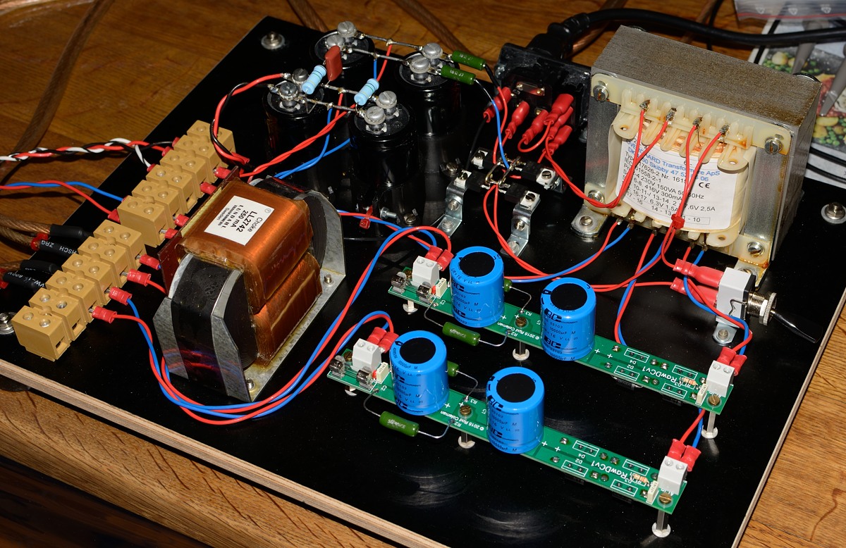

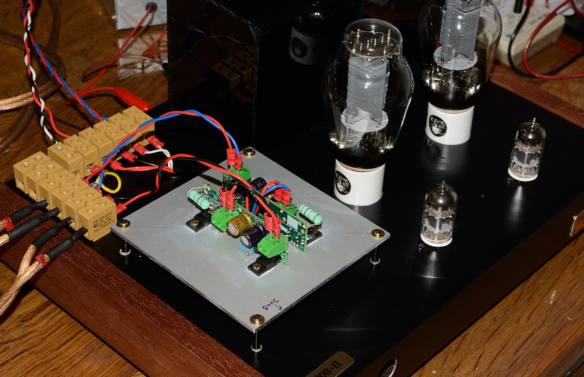

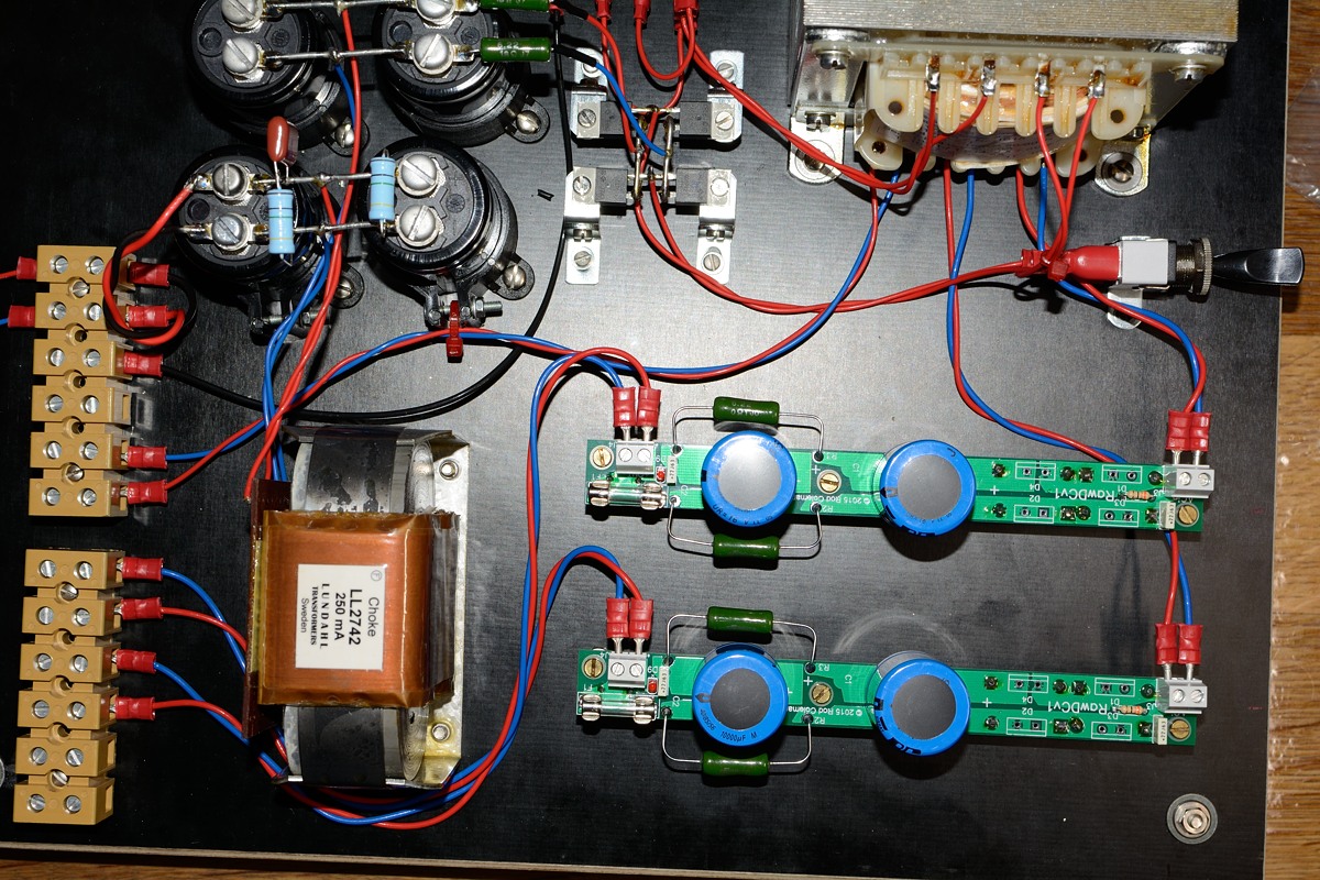

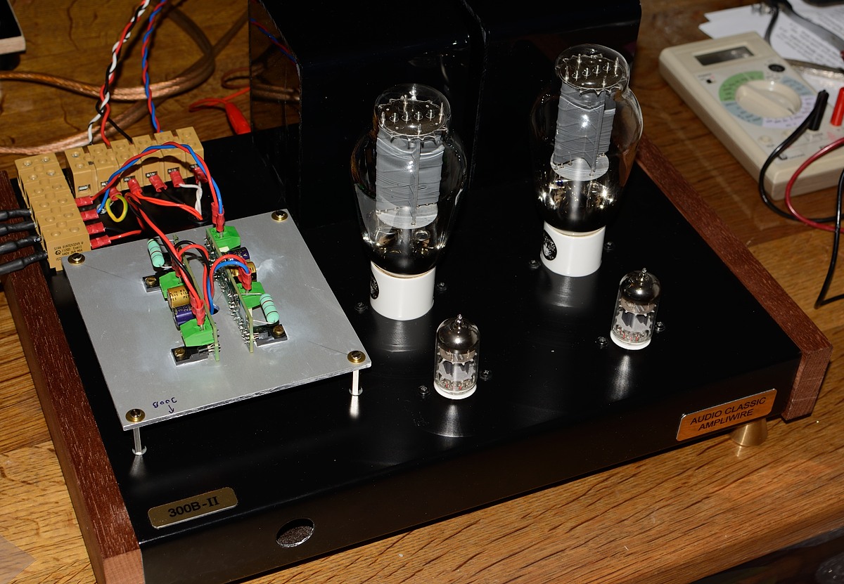

I finished the rebuild of external PSU and modifications to the main amp cabinet. The Coleman regulators was placed on top of the chassis on a 3mm piece of aluminium. Approx. 12 x 12 cm. It seems to be fine as heat sink. It never gets hotter than it is possible to put a finger on the aluminium.
For adjustments I started just by inserting the 300B and voltage was about 3.5 V DC with pot adjusted as low as possible. Then I could adjust it to 5 V very easy. When I inserted the small tubes and after a while turned on the B+ it was necessary to adjust the 300B filament by approx. 0.1 V up.

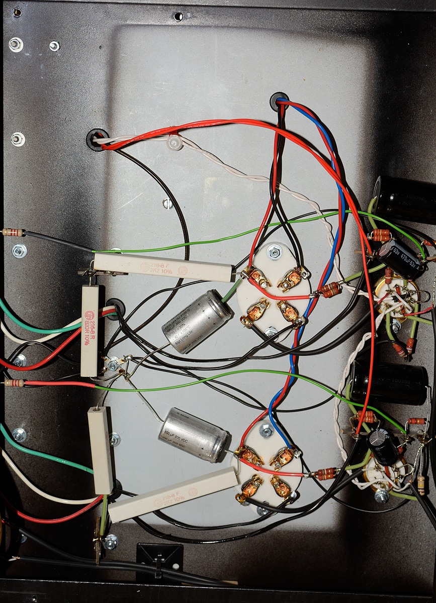

The voltage on the 300B cathode resistors is now 180 V - 183 V and before it was 177 V - 180 V. I guess this is OK. I use the filament + side for the cathode resistor.
I measured hum with RCA input shortet on the 8 ohm output. I measured 0.0 - 0.1 mV AC so very little. I have a head phone adapted mounted and it is 100% silent when I insert a head phone. Before the modifications the hum was very audible.
So far so good.....next step it to hear some music on it. I am confident that it will be fine.

The question is now what the main cause was for the 3-4 mV AC hum on the output. 120mV Ripple on B+, 55 mV ripple on 5V or was it that the PSU trafo was too close to the OTs and 300B tubes? .....maybe a bit of each.
The look of the underside of the amp is now much cleaner.......
55mV on the filament is enough to cause problems, without any help from the anode supply. But the others probably added something, too.

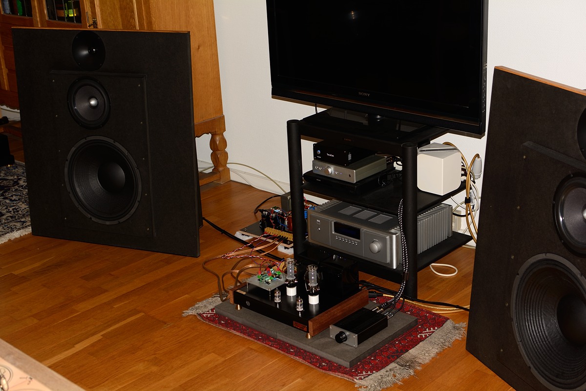

Now I tested the amp on my speakers. It is 100% silent (94 dB speakers). No hum/noise even if I put my ear as close as possible to the speakers.
They also plays amazing. Very clear and transparent high/middle and really good bas. This is with Electro Harmonix 300B and Tung-Sol ECC83. So there are possible upgrades for the future.
So a DHT SE triode amp can be 100% hum free....I was a bit in doubt in the begining......
I stream 16 or 24 bit music and use a passive preamp (24 step attenuator) to have the signal path as short as possible.
