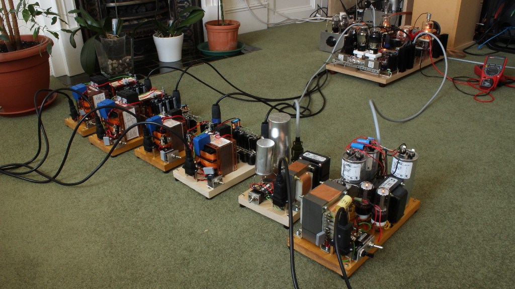

I discovered that all the bords in the front seems to be the PSUs for the amp in the baggrund. Compared to this I agree that my distance is at the "short side"!
A nice idea to build an amp on a piece of "furniture wood".
This was a first test of the full madness before racking them on the shelves. I mostly all times separate PSU from my amps. Mainly for flexibility to swap out sections and reuse PSUs but also to ensure I make it dead quiet
So it is your PSU's and Amp's!
It looks really impressive!
I don't think I will ever reach that level in DIY tube amps.
Even as DIY is looks quite expensive. But good that we can get some advices when we run into problems.

You are right that it looks a bit like "madness". You need a "good wife" or "no wife" to have this permanent in the living room 🙂
It was originally a 4-65a SE Amp in Class A2 which morphed into the 814 in triode mode. All DHT and DC coupled. A fantastic amp and experiment which lasted for a couple of years. I pushed it out to the loft where it resides now when my daughter was born.
