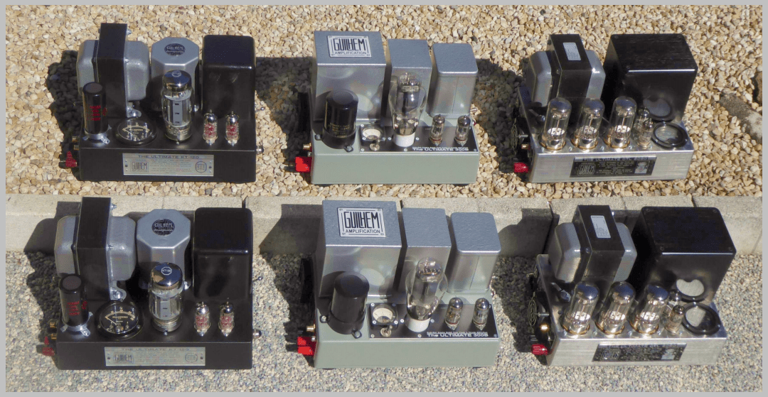

Thanks @6A3sUMMER !
I of course installed a filament bias on other SRPP preamp circuits, but I wonder if I did it on my U-300B 🤔... Not even sure 😕, since my schematic doesn't mention it (not updated ? 😡) ! They work for more than ten years as is, though...

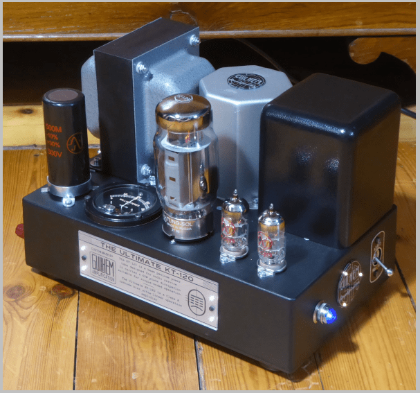

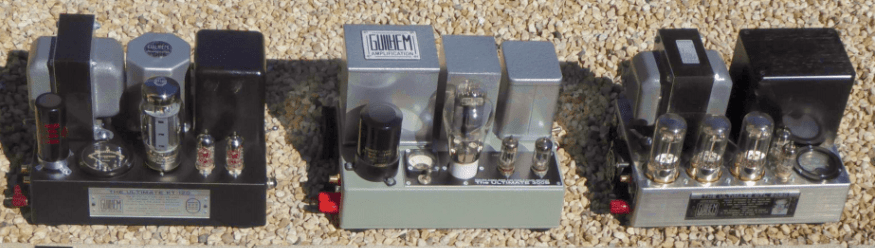

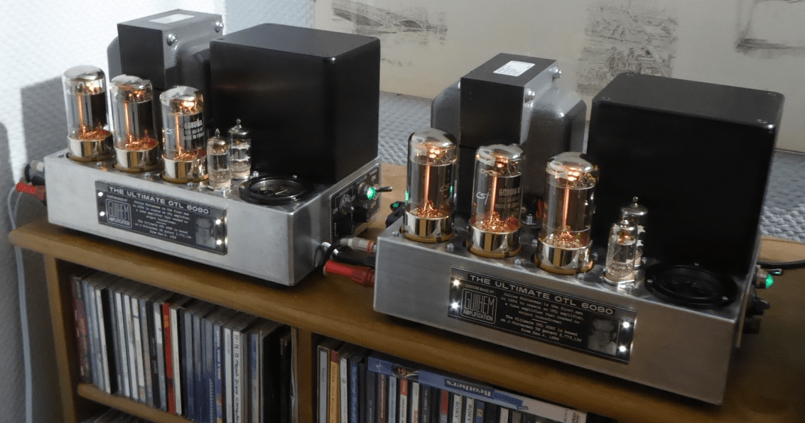

From L to R : U-KT120, U-300B, u-OTL
The U-KT120 - as its names implies it - uses a KT120 Tung Sol tube, in a single-ended, ultra-linear, cathode bias operation. The driver stage is exactly the same SRPP circuit as on my U-300B schematic a few posts above - AND with the filament bias ! 😉

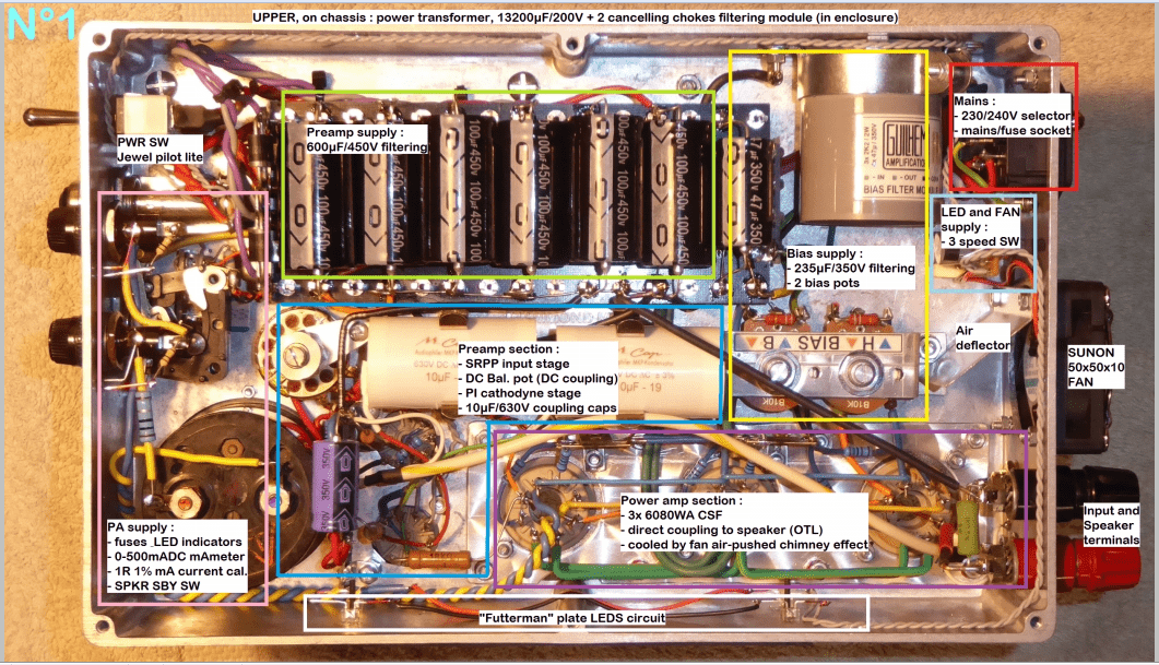

The U-OTL is an output transformer less amplifier, using 3x6080 at the output stage :

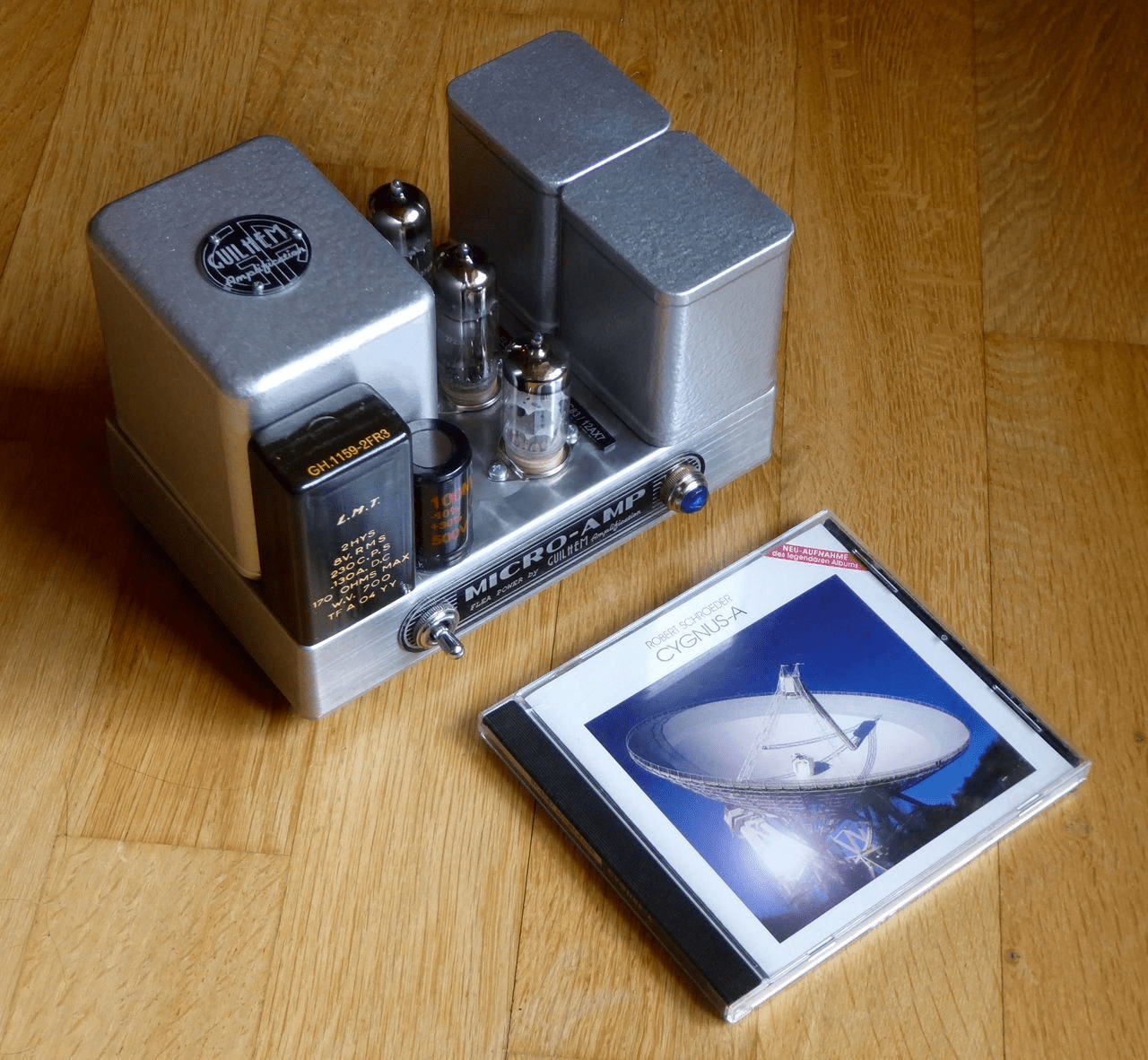

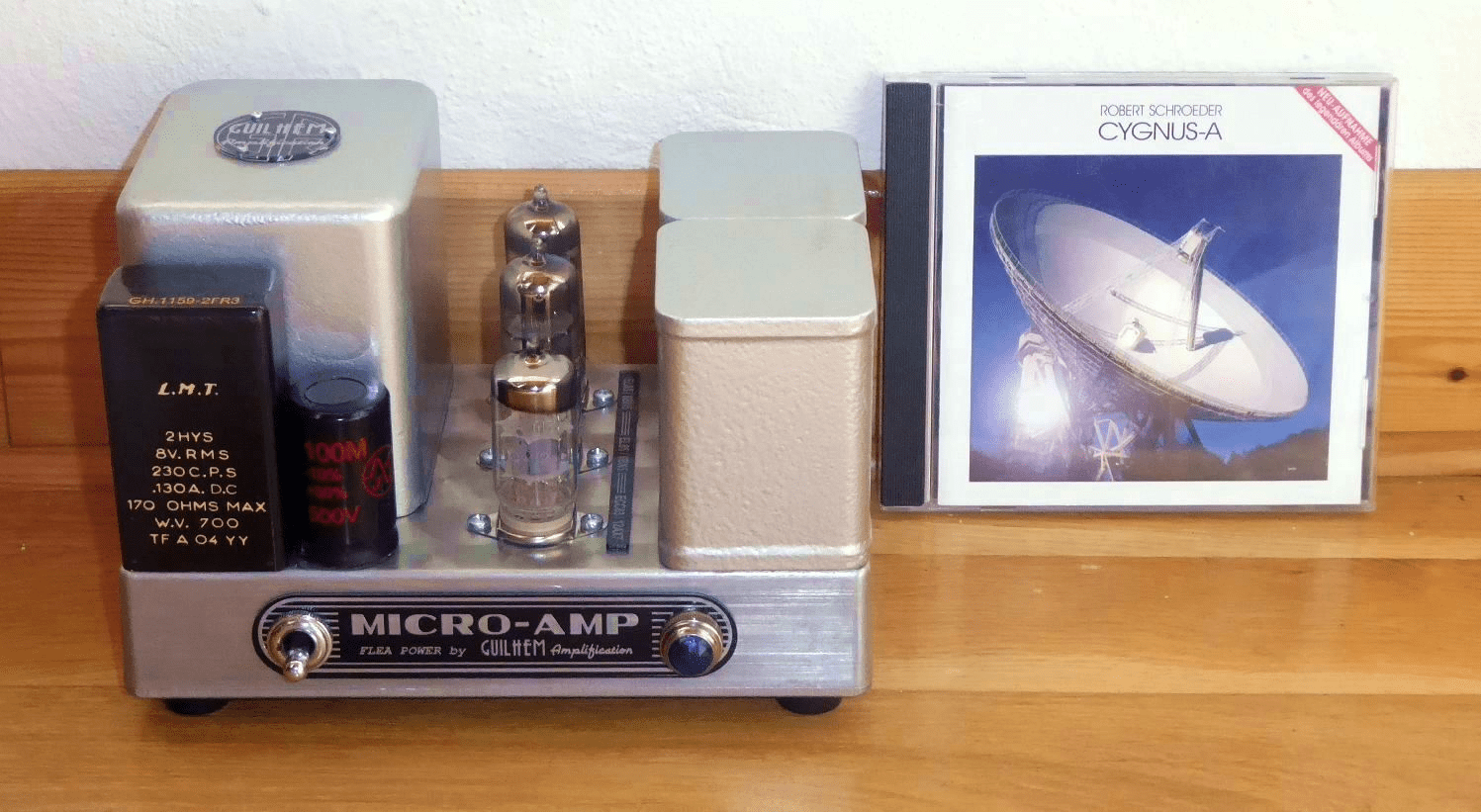

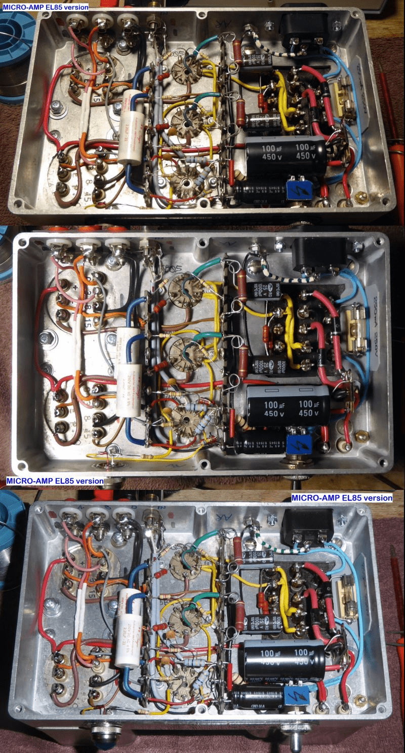

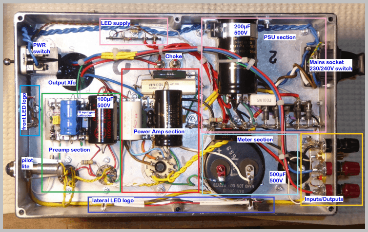

Thanks @Fuling !
I'd say no - assuming that you study very carefully the installation, the mutual disposition of the elements and the wiring configuration, of course - and possibly make a prototype, if you are in doubt, for checking.
The great advantage of the "compact formula" is that - if suitably designed - the connections are the shortest as possible, and then much less sensitive to inductions, coupling or losses. See below my Micro-Amp : at left Output section, center Amp/Preamp section, at right PSU section. It's not a very nice wiring per se, but it is efficient.
The CD box gives the scale of compactness of the unit - which is nonetheless perfectly hum-silent :
