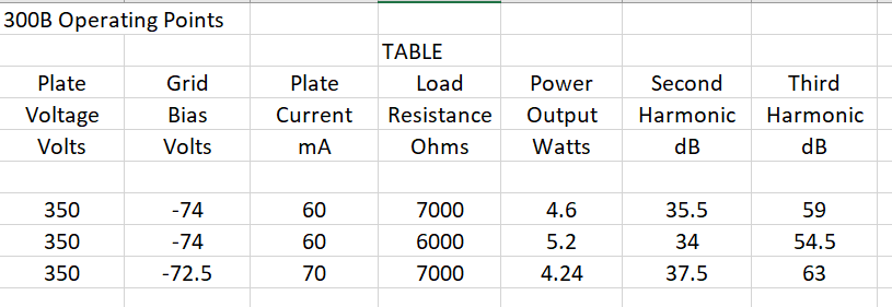

I envision using EML30A to drive WE300B, so I am considering either choke loading the 30A or IT coupling to 300B.
For choke loading I have ISO RC-160-15W; for IT I have Hirata Tango NC20.
I mentioned design points for 300B to be low power (4-6 Watts)...I have OTs that can do any of the OPs listed in the table attached, and also two 5K:8 OTs. (Slagle 49 Ni and Tamura F7003).
I have done some thinking about where to run the 30A, and my first sketch with the ISO plate choke has a design point of:
Va-k = 400v, Ia = 18 mA and Vg = -4.5v, so Va = 404.5v and VB+ = 425.4v. Ra for the 30A should be ~ 6.5K.
Any thoughts on these approaches would be greatly appreciated.
Very Best, Robert
