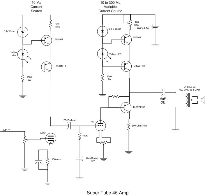

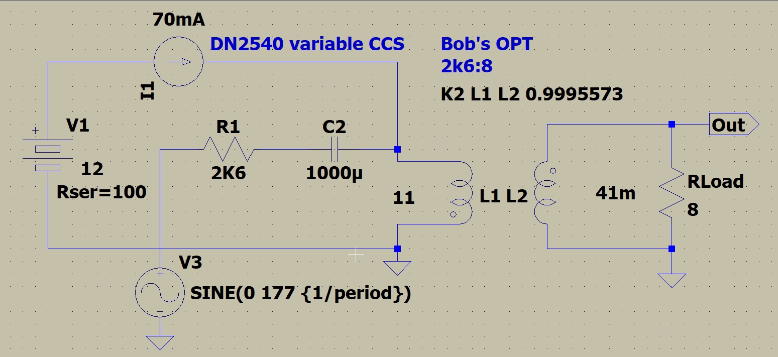

euro21, based upon these measured values I have changed some parameters of your simulation. I would like to implement this CCS but I can't get the FETs that are depletion mode, 400V and Rsdon = 25 Ohms.
How can make it with more standard components? This measurement setup is very interesting.
You are using a 450V sine signal applied to the transformer primary, but in my case this would be something between 177~200 VAC which is the value shown in the simulation and in the transformer calculation. Are you Ok with this value?
Also, can a lower voltage be used for the CCS ? (eg: 12VCC )
Try BJT CCS as in the attached schematic.
If the CCS has enough isolation (enough large impedance at given AC frequency), lower DC is enough, but it must be enough large for CCS plus Iccs*DCR of primary.
OK, thank you. And again:
"You are using a 450V sine signal applied to the transformer primary, but in my case this would be something between 177~200 VAC which is the value shown in the simulation and in the transformer calculation. Are you Ok with this value?"
In my example the 450V peek voltage generates -almost- full current swing (0-140mA) within the primary, so better represents the full driving of (70mA static anode current) tube.
Of course, any size of AC excitation can be used.
