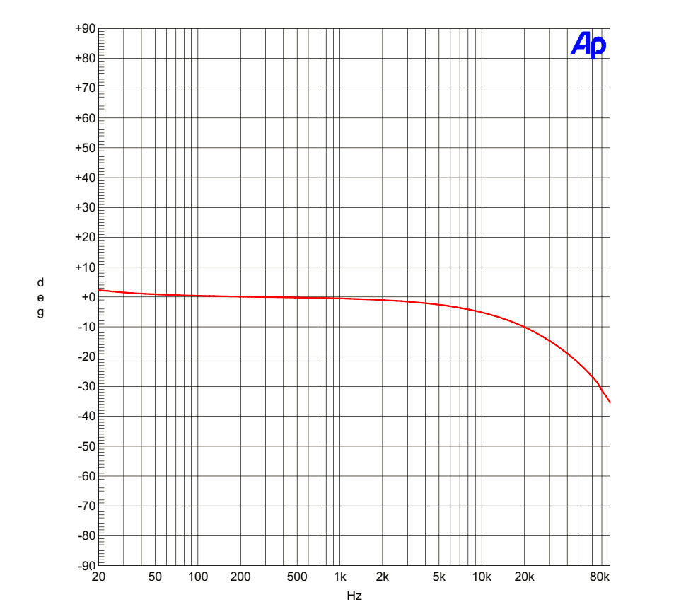

Because the phase angle should be negative.
Look at this as a reference: https://www.mennovanderveen.nl/imag...SE_______/3050-SE_vs02_290321_datasheet-2.pdf
You put a boubt
I restart with test and I made a previous error, stupid!
Wrong connection on AP!
Many thx for your observation even I had to put better attention
In attach the right graph
The shape is the same but revers
Also graph of phase on post 18 is wrong

What are your intentions with this transformer? Commercial products? Or stock for your own production of amplifiers?
The intention is to offer a list of trafos. Only nano ironWhat are your intentions with this transformer? Commercial products? Or stock for your own production of amplifiers?
But at the moment it is time only for test.
Also potting them is a goal.
Probably are involved also my project of amps done during the years
Walter
3k:5 transformer is applicable as 4k8:8 (24.5 ratio).
80H primary induction is unusual value for these OPT (even if the nano core permeability is much larger, than other core materials).
Air gap constructed for low primary current?
The ratio is around 25 timesk:5 transformer is applicable as 4k8:8 (24.5 ratio).
And I use always one single secondary at 5 ohm.
80 H are at 100 Hz

Euro21 has a bit of a point. Did you airgap accordingly for the DC flux density necessary? 80H sounds surreal, even by first sight picture. What are Afe and primary turn count values?
Nano cores -1.25T- (and amorphous too) has less saturation limit, that average Fe cores.
Practically never used its over 1T (for example 0.5T BDC, 0.5T BAC).
Too high exctitation (or too low air gap) delimits the maximum power at the low side, so at higher frequency available the desired distortion at given power.

You don't necessarily need DC, especially for nanocrystalline core, which is very linear,f you do the simple math of flux density distribution right. However, I highly suspect the core will saturate from the required Idc alone if the inductance remains 80H.
waltube,
Keep going. I am sure it will be a good SE transformer.
Exciting to hear about.
By the way, the graph phase reversal was, and is not, a big issue. I spotted it, but I did not consider that it needed to be mentioned.
Only in a complete amplifier does it have to be paid attention to.
Low frequencies alway lead, and high frequencies always lag.
When you have DC in the primary, if the phase lead is 26 degrees, that will be the -1dB low frequency.

Was an stupid error by meBy the way, the graph phase reversal was, and is not, a big issue. I spotted it, but I did not consider that it needed to be mentioned.

@6A3sUMMER , I not agree.
In the past i saw several output transformer with “big” differances measured in phase or out of phase, including a brand as Tango.
There could be also a difference if the transformers is grounded or not. Just my cup of tea.
The measurements of Walt looks promising but are incomplete. No test set up….

There are so many tests you can run for an output transformer. All good tests tell you something about the transformer.
For most tests, you can run the transformer forward or backward, and get the same results.
There are Tubes / Valves threads that show some of waltube's test methods.
I used to have access to a Rohde & Schwarz $50,000 vector network analyzer and $10,000 precision cal kit.
I tested input to output ratio, primary inductance, primary distributed capacitance, leakage inductance, phase, insertion loss, and of course used a DMM to measure the primary and secondary DCRs.
For SE 300B output transformers, I used a 700 Ohm driving resistance (just like a 300B's rp), and an 8 Ohm non inductive load on the 8 Ohm output tap.
The most often applications of an SE 300B output transformer, does Not use global negative feedback.
Therefore, the one dual test that tells you about 90% of what you need to know . . . is the input to output test of amplitude versus frequency, and input to output phase versus frequency.
The known driving impedance and load impedance, plus the input to output amplitude and primary DCR and secondary DCR allows you to calculate the primary impedance when the secondary is properly loaded.
Of course if you are winding your own transformers, and trying to get them to work more closely to your goal, before you modify the transformer design, you need to measure the input to output amplitude, primary inductance, primary distributed capacitance, leakage reactance, and primary DCR and secondary DCR.
Doing that will permit you to come closer on the next design results of:
Input to output ratio, and input to output phase.
Of course, the SE transformer's end bells and laminations need to be grounded in a real amplifier, and the primary B+ end is effectively at AC ground, and the secondary Common is to be grounded.
Safety First!
Yes . . . Grounding one primary lead, versus grounding the other primary lead, will give different results;
and grounding the primary common lead, versus grounding the primary output tap will give different results.
That is because of the capacitance between the primary to secondary, primary to laminations, and secondary to laminations.
Consider that those capacitances are different at the two ends of the primary, and thos capacitances are different at the two ends of the secondary.
Therefore, when you test the transformer, you need to ground those same items in the exact way you will use them in the amplifier, so that the tests are fair (just like the tranformer will be used in the real amplifier).
I hope some of the readers of this, my Post, can read through it all the way to the end.
There are other tests, but I will not mention those in this thread.
Art and Science.
Have Fun!
PS: Notice that the input to output phase of waltube's graph is Zero Degrees at Mid Range Frequencies. And that is where our ears are most sensitive (Yes, at mid frequencies). Nice!
