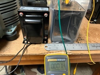

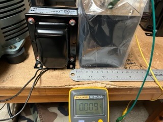

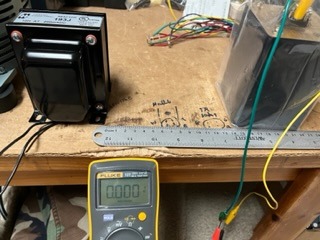

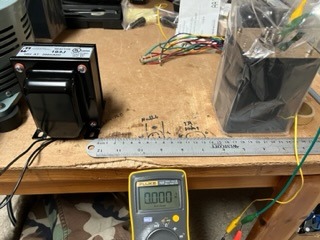

300B Board Layout question
@6A3sUMMER - THAT was fun, entertaining and educational. Seriously.
Results in order: far-near, turned OPT 90 degrees, close in and farther.
Got my answer. But I’ll play with the PT too (taping ALL non-connected wires) to be sure. Orientation of the PT core seems to be the same, but what the heck, I got time.
Thank you.

You can also do the same thing with a pair of wired earbuds. I use an adaptor from the 3.5mm jack to some alligator test clips. Hook those to the OPT (or whatever you want to test) fire up a small filament transformer/choke/whatever and play with the orientation of both the source and the OPT. Clearly can hear the results.
