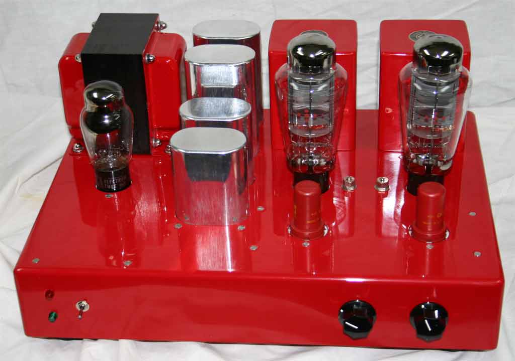

Or, up the middle go with PT then choke the Rec tube from back to front. Then out section on either side with the OPT in back the output tube, then input tube.
I laid mine out like this.

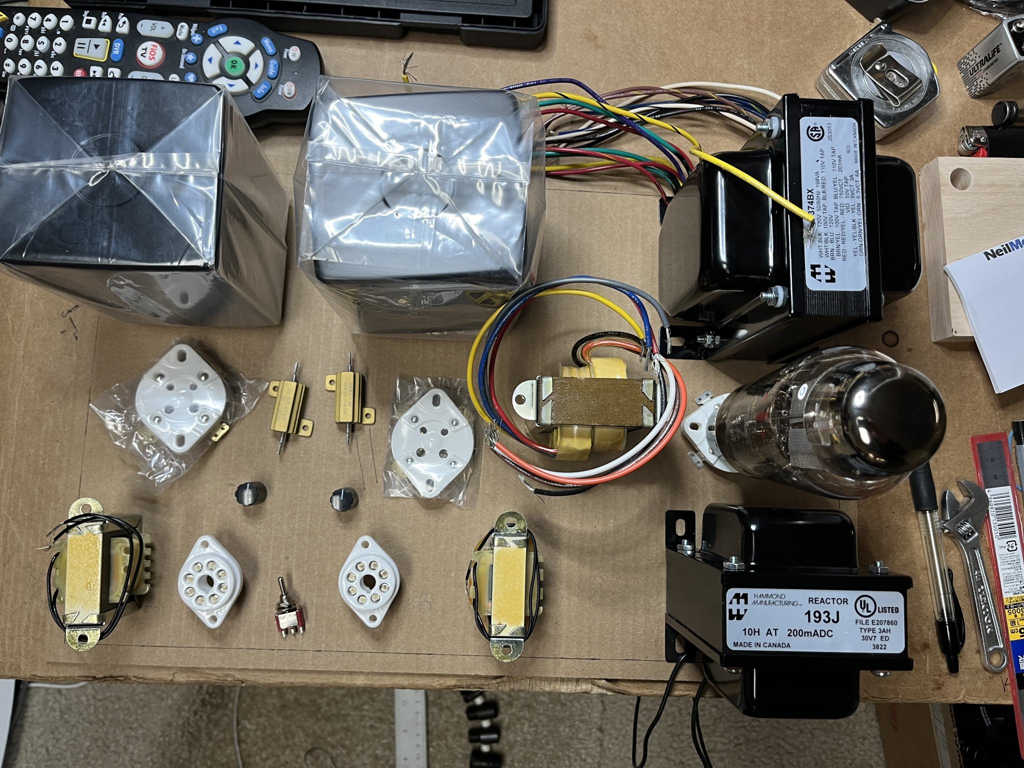

The axis that goes through the output transformer's coils might be vertical instead of horizontal.
Yeah, that’s what I’m afraid of. I don’t know what these look like inside. I bought them through a seller in Japan, language was a little dicey, I’ll write the company.

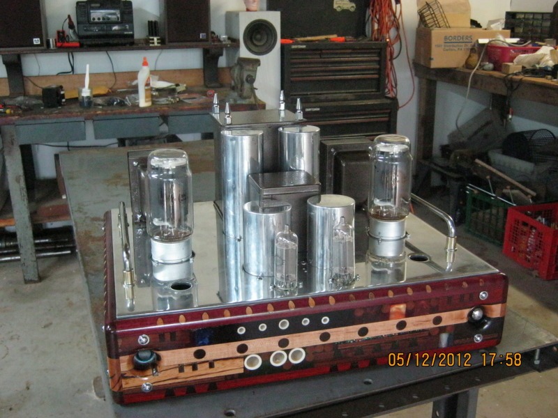

Going to use steel, not copper. I just thought it looked really cool on the Tektron amp I bought, but a suitably large and THICK piece is prohibitively expensive and is likely to warp over time under all that weight - or so my roofer friend tells me.

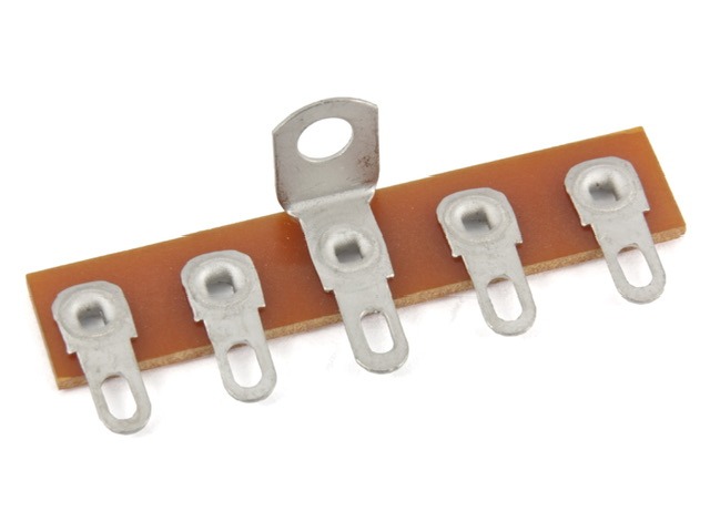

Yes, or mount on a metal plate, and attach the plate to the side.
You may need some tie points on the plate for longer wires.
Where are the filter capacitors?
The two smaller ones are PS chokes for filtering?

NormB,
From the pictures of the Hashimoto output transformers,
The magnetic field Axis appears to be Vertical.
Wth a vertical axis, you still have two other 90 degree orientations of the power transformer and choke that are not the same as the output transformer.
Test for this, activate the choke as I said earlier, and lay the output transformer on its side.
Then you should see the signal more strongly, versus when the output transformer is mounted right side up.
