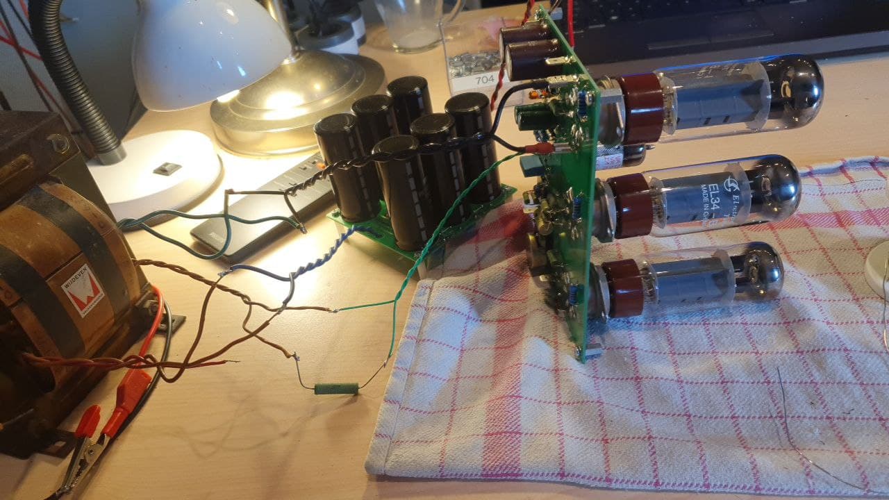

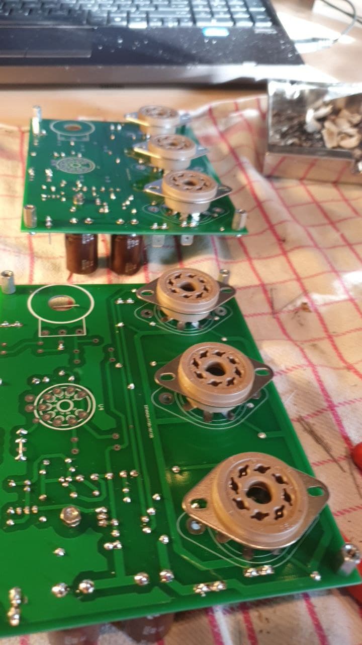

I have soldered mine to a cheap FR4 protoboard (like eg https://www.ebay.de/itm/13383145926...SojrH60eX7t2IZbjpDHC|ampidL_CLK|clp:2047675), some extension wire and holes in the board for fixing it to the chassis.
