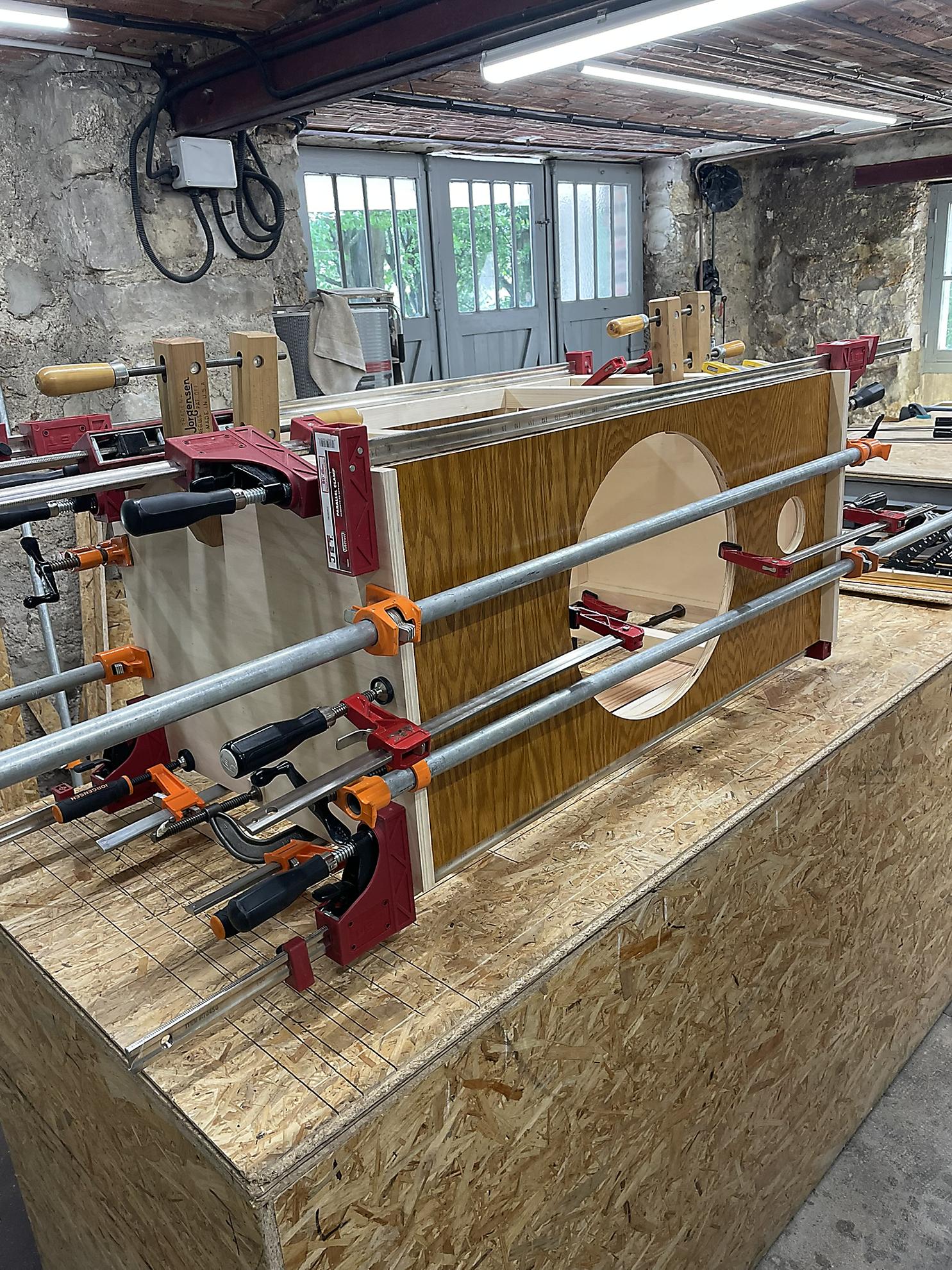

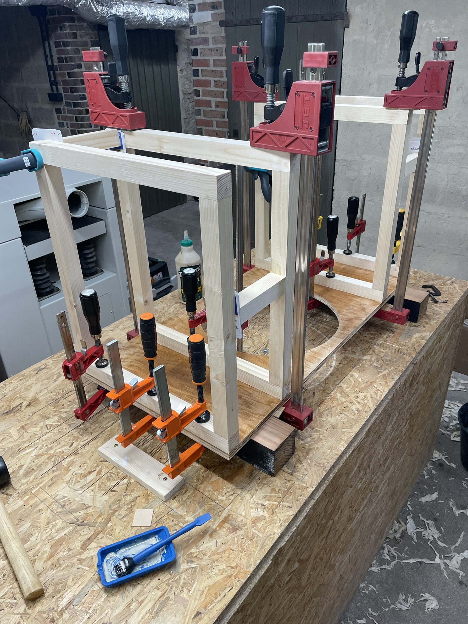

Last two pieces are gonna go on today for Subwoofer No. 1.

For now I will spend time building the second one...

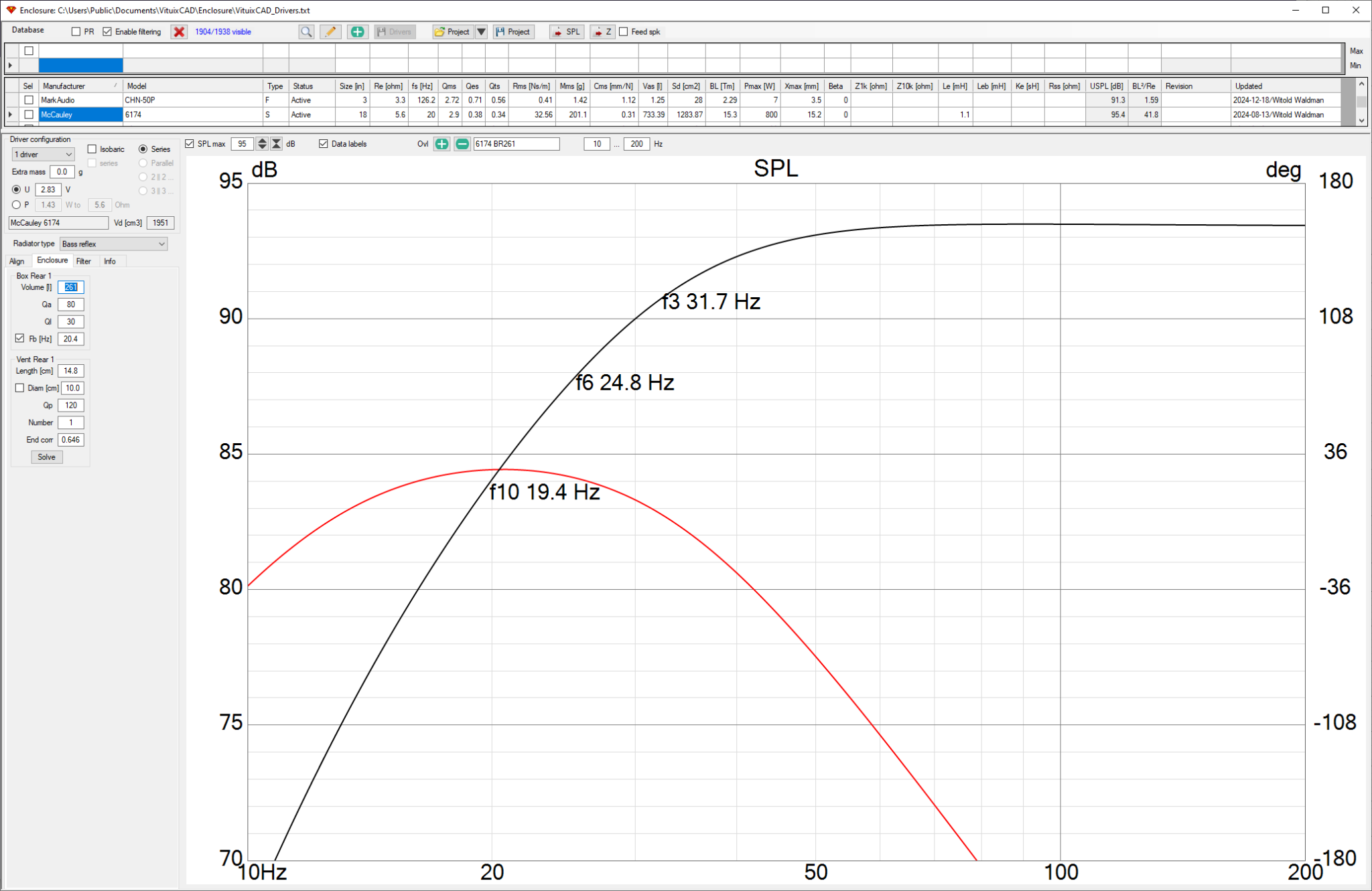

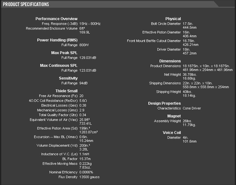

As for " It still puzzles me why this driver, which is supposed to have 95 dB sensitivity, needs so much boost" I must note those sensitivity (whether measured on whatever the heck the manufacturer is using for a setup, or calculated from Thiele-Small) are MIDRANGE sensitivity. The actual sensitivity at very low frequencies is quite a different matter for most subwoofers, whose boxes are barely big enough to fit the woofer. Yours is getting to a proper box size so per the sims should keep the sensitivity down fairly low, plus room gain. BUT

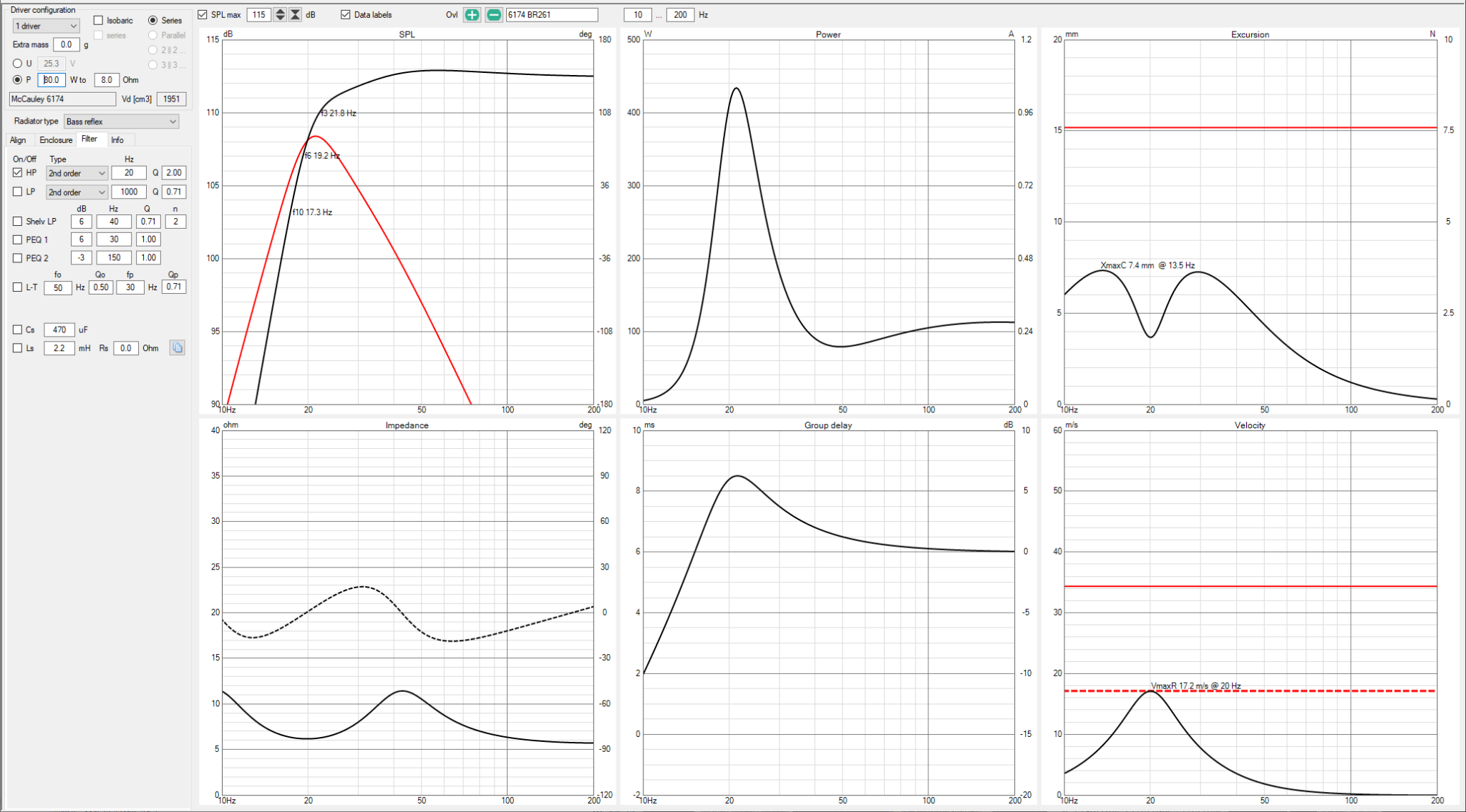

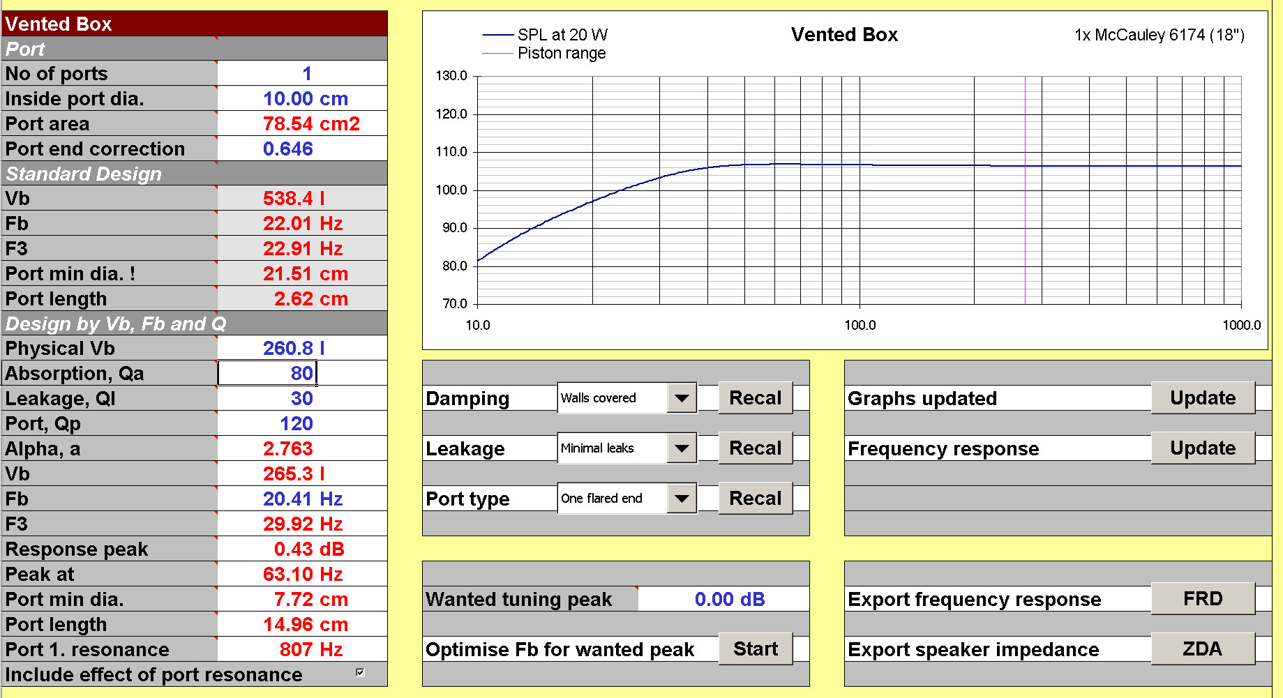

That's absolutely correct, and something that is possibly forgotten amongst the plethora of data. With drivers that tend to be well-suited to standard alignments, it's generally the case that the vented-box alignment's F3 is going to be pushed up quite a way higher than the driver's free-air resonance frequency, Fs. That's just the inherent nature of vented boxes, which give the benefits of a "smaller" enclosure for a given bass response with any particular driver. In the case of the McCauley 6174 driver, its Qts=0.34 lends itself to a natural QB3 vented-box low-frequency alignment. To some extent, this helps to keep its box volume in check, as its Vas=733litres is quite large.As for " It still puzzles me why this driver, which is supposed to have 95 dB sensitivity, needs so much boost" I must note those sensitivity (whether measured on whatever the heck the manufacturer is using for a setup, or calculated from Thiele-Small) are MIDRANGE sensitivity.

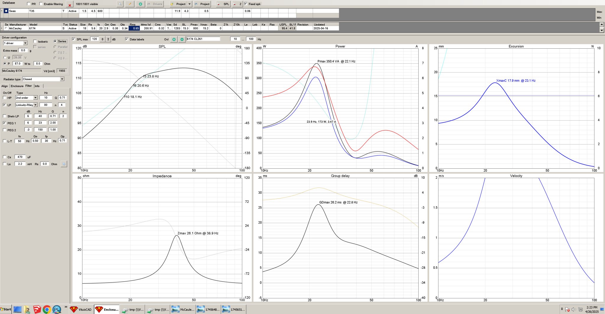

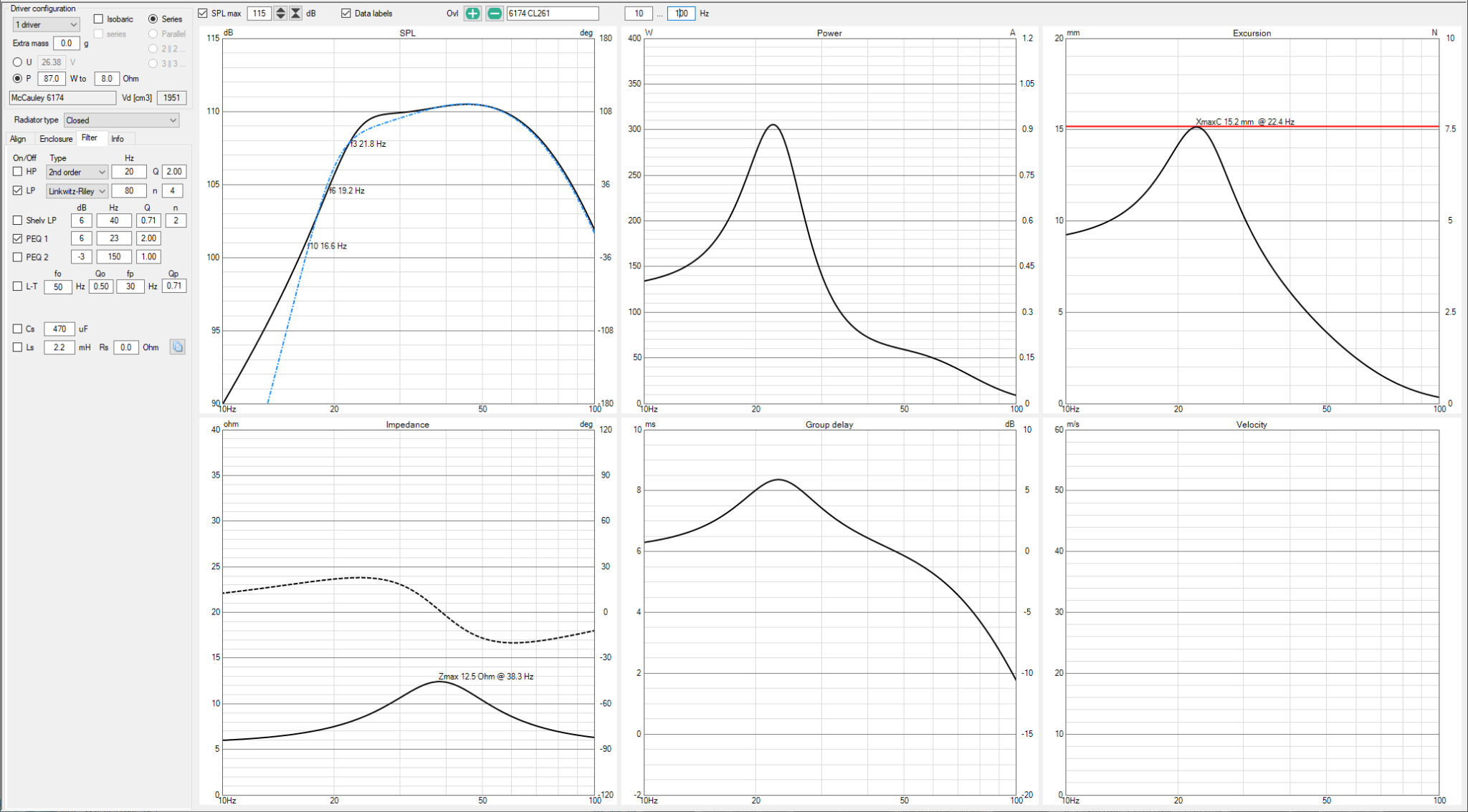

By way of example, a traditional QB3 alignment with Vb=357litres and Fb=23Hz will produce an F3=28.3Hz. Although a quite reasonable result, it's still hardly real "subwoofing" territory. Below is the resulting frequency response plot. Of course, the passband sensitivity is nice and high, being about 93dB.
In this instance, and also many, many others, there is no escaping the fact that a non-standard tuning will offer more low-frequency extension. Those that are less familiar with vented-box alignments will find that somewhat counterintuitive. To get more low-frequency response out of this enclosure, we can tune the system to a lower Fb.
Below is the same vented-box enclosure (Vb=357litres) tuned to Fb=12Hz, with a parametric EQ of +6dB with a Q=1.20 added at 23Hz. We have now achieved a substantially lower F3=21.5Hz, which is more in keeping with the expectations of this driver. Note that, with this driver, we have been able to maintain its natural passband sensitivity.

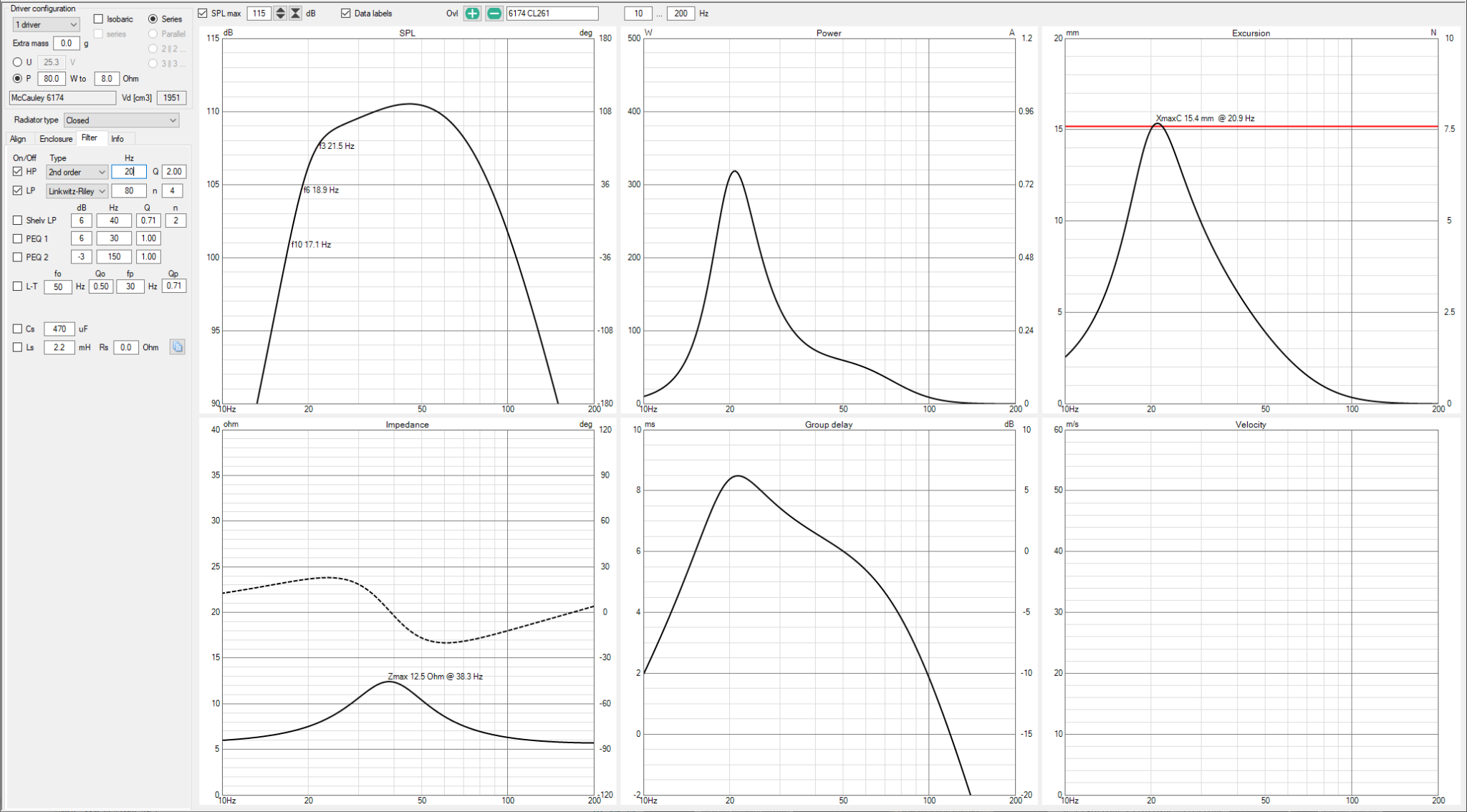

If we want to use the full potential of the driver in a 357litre enclosure, we can make use of an equalized closed-box alignment. We can achieve an F3=15.6Hz if we apply a shelving filter coupled with two lots of parametric EQ, one of which provides a boost of 9.5dB at 17Hz with a Q=1.9, while the second is applying a cut of 0.4dB at 47Hz with Q=1.0. Of course, with this heavily-equalized design, we have obtained excellent low-frequency extension by reducing the maximum SPL that can be achieved within the passband. Nonetheless, for some applications, this might be quite acceptable.
Thanks for the explanations. I guess one thing learned is that one should really measure a driver before designing... I would have realized that the 95 dB comes from the midrange sensitivity.Yeah, do that. OSB is not as internally strong...if it gets wet it swells up a lot more than plywood. Kiss of death in my opinion. Plus sometimes you can get some nicely veneered plywoods. What did you finally use for the build? I used to do business with McCauley, way out there in Puyallup, nice folks.

I will do some in-room measurements once the second subwoofer is done. I suppose with two subwoofers running, I should have a bit less room modes also.
What worries me about this kind of setup is, that I may get some distortion if I do the EQ and shelving filters digitally. Of course I can avoid it by taking the entire signal down before boosting, but that means less overall output. It's something I have often experienced when experimenting with EQ for open-baffle bass.If we want to use the full potential of the driver in a 357litre enclosure, we can make use of an equalized closed-box alignment. We can achieve an F3=15.6Hz if we apply a shelving filter coupled with two lots of parametric EQ, one of which provides a boost of 9.5dB at 17Hz with a Q=1.9, while the second is applying a cut of 0.4dB at 47Hz with Q=1.0. Of course, with this heavily-equalized design, we have obtained excellent low-frequency extension by reducing the maximum SPL that can be achieved within the passband. Nonetheless, for some applications, this might be quite acceptable.
An analog shelving filter however did wonders. I happen to have a Sony SE-P900, and every time I add it into the "mix", it does wonders to the low frequencies due to the low shelving filter. Only that this takes a lot more setup... the EQ runs on 100V, requires a step-down transformer, more cabling etc.
