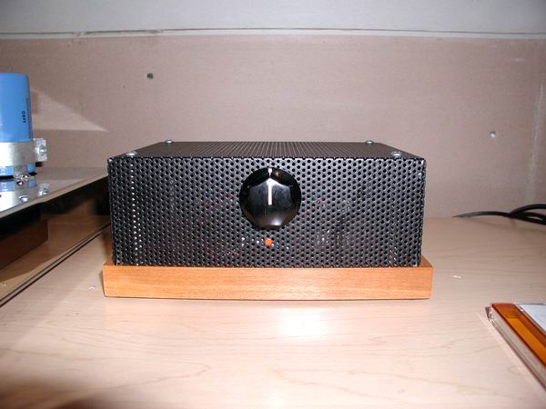

My T-AMP
Here's my attempt at modding the T-Amp. Its a mesh box screen that I found at work and I attched it to a nice wood base. Sorta looks like a tube setup??
Anyway, didn't do much, no real mods per se, other than RCA plugs and Biding posts. I run it with an old Laptop Power Supply - 12 Volts and 1.8 Amp (Amps are key here!) I will continue modding this later (upgraded Caps, Resistors, etc).
Currenently undergoing a serious Burn In...8 hours and counting...

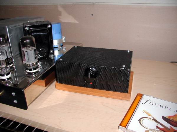

And one more
Here's the amp again next to my Other Project - a 45 wpc tube amp I aquired from a friend that I'm still fartin' with...The T-Amp was a good repreive - I don't think I can get myself killed with the 12v T-Amp, compared to the 450+ volts on the DIY Tube Amp...
Burn-In Music is Fourplay - great Burn-In CD...real dynamic, and lotsa percussion...

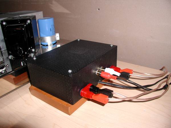

The knob is a $2.29 Rat Shack jobbie (comes in packs of two). The red dot is the one on the T-amp board. Just poke a bit bigger hole for it.
I got lots of Kudos for it. Looks neat. If I get my hands on a few more expanded metal grid boxes, I'll try a 20 wpc amp board from 41hz.com. Maybe the 100 wpc. The SMD soldering bothers me and the power supply on the 100 wpc looks a bit out of my skill set.

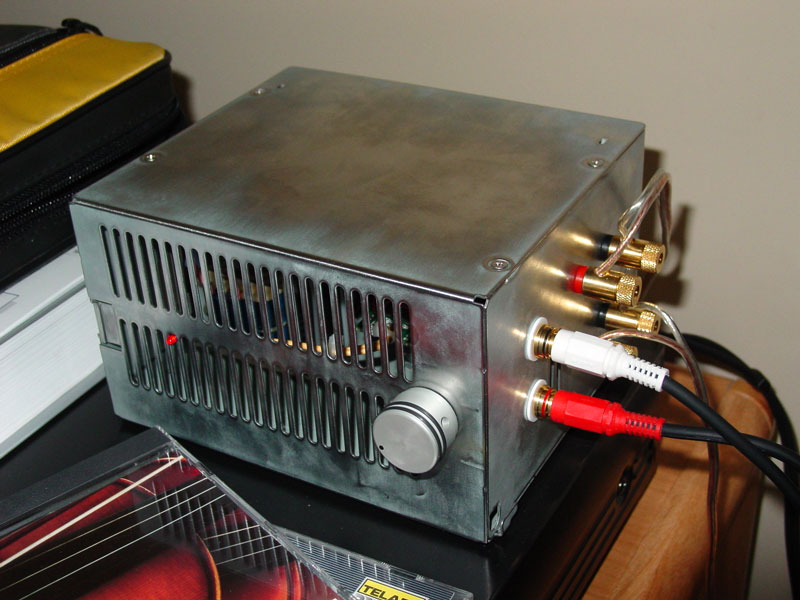

My brother has a birthday coming up and I figured it would be nice to give him a good present for a change, so I made him a one off T-amp consisting of parts I already had or acquired for free from other sources! I think you guys will like the case I used - it even has a built-in cooling fan 😀

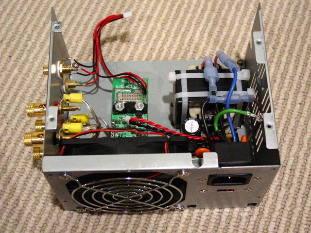

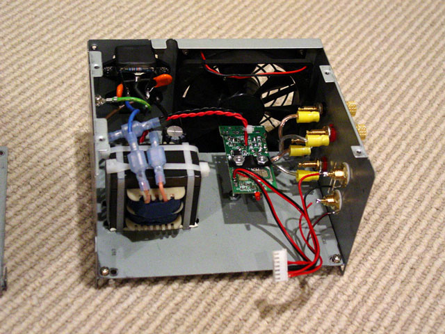

It's a gutted power supply case from an old compaq computer that bit the dust and donated it's body to science. That's a 9VAC ??VA transformer on the left wired directly to the IEC power jack with the 120/230 mains switch rewired as the amp's on/off switch. The transformer was sourced from an orphaned wall wart and it has a board with 3A rectifier diodes and a 3900uF nichicon HE cap for filtering. The DC output is wired directly to the leads of the onboard cap which is a brand new 680uF nichicon HE.

Since I took these pictures I've changed the wiring a bit. I soldered the input wires directly to the stock SI pot board. The original idea was to keep the input connector so you could just unplug it when you wanted to open the case. Now you have to remove the knob and unscrew the pot from the panel but the connections are better. The RCA inputs and binding posts are from partsexpress. I could hook the fan up to the power supply but the amp hardly gets warm during operation and I didn't want to decrease the supply voltage with the extra 0.2A draw from the fan or take a chance at increasing the supply noise that could possibly come from the fan. These PSU supply cases work great for the tripath amps and you can usually find spare ones from computer junkie friends. I did sand and steel wool the case to get a nicer looking brushed aluminum look finish even though it's steel. I just need to clean all my fingerprints off of it before I wrap it up.
For a decent case it's hard to beat at that price! You can also salvage some parts out of the PSU if it still has the internals. I collected some TO220/TO3P insulator pads, a couple aluminum heatsinks, a toroid core, a bridge rectifier, and some other misc parts while gutting the PSU. Interestingly enough I used the SI that I originally had in the aluminum case I ordered from you! The case will soon become the new home for an AMP3 from jan. I figured a great case deserves a great amp 😉
