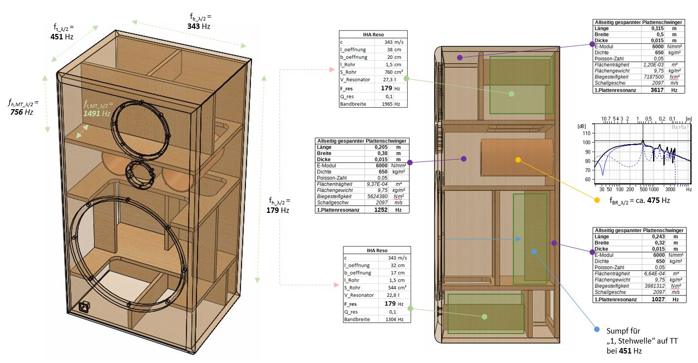

The phenomenon is real, but the term "standing waves" is not a good description. I prefer the term Acoustical Resonance.
An acoustical resonance will occur whenever an internal cabinet dimension equals the half wavelength of a signal. For instance, if a cabinets largest internal dimension is 20 inches, the frequency with a half wavelength of 20 inches is 338 Hz. The SPL inside the cabinet can rise as much as 20 dB at 338 Hz. This is very significant because the transmission loss (sound suppression) of a 3/4" layer of MDF or plywood is about 20 dB, so at 338 Hz, the sound coming through the cabinet walls can be nearly equal to the sound coming from the driver. This is not a structural resonance problem, just ordinary sound transmission.

Standing waves is the technical term and they do occur in all enclosures at frequencies small enough. Only damping material can prevent them.
Why do you think you can have standing waves in a room, and not in an enclosure, which usually has the same shape as the room they are in?
In short: Standing waves inside enclosures are real, it is the correct word for them, it can predicted at which frequencies they will occur given the dimensions of the enclosure, and there are proven ways to get rid of them.

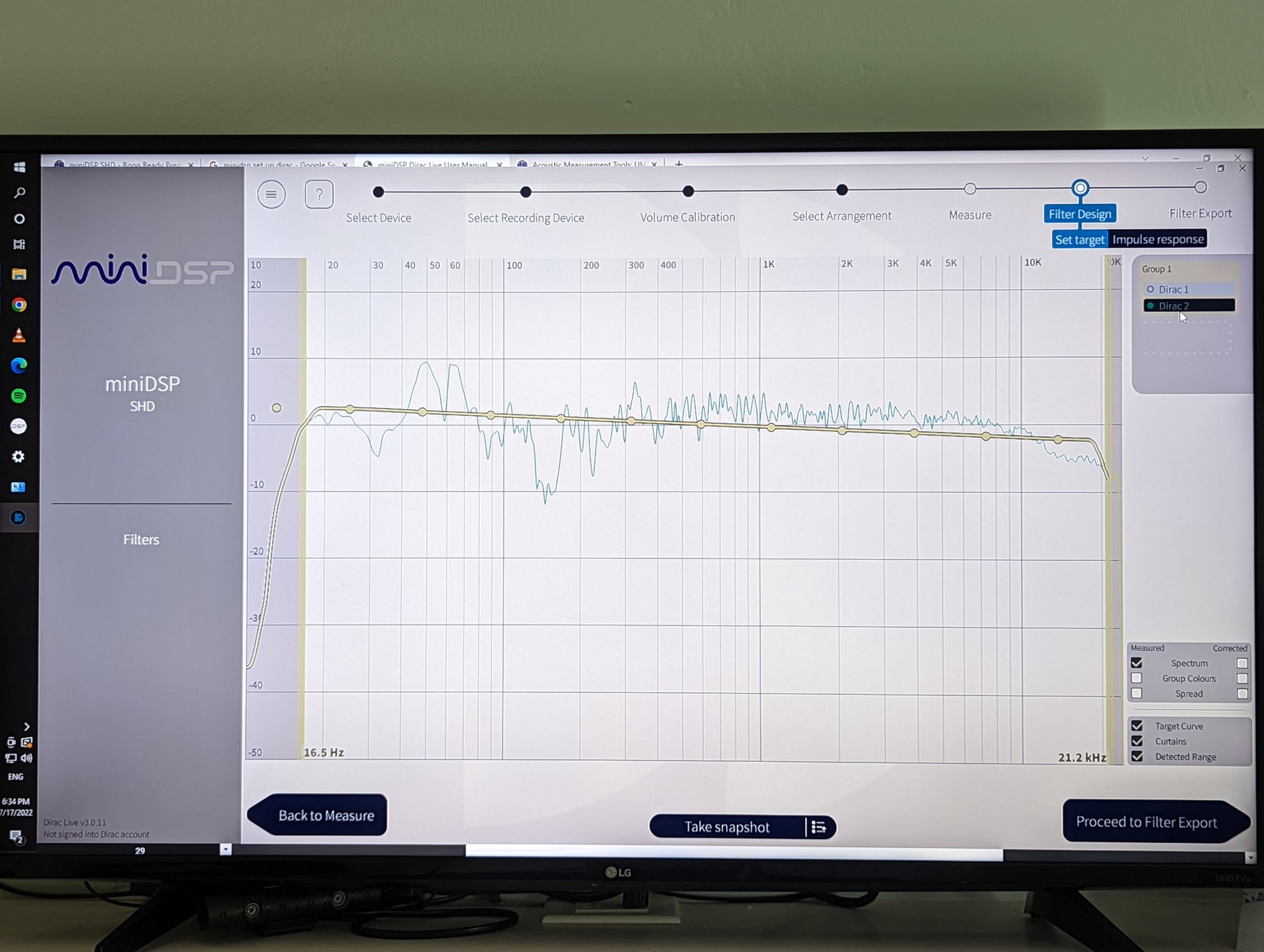

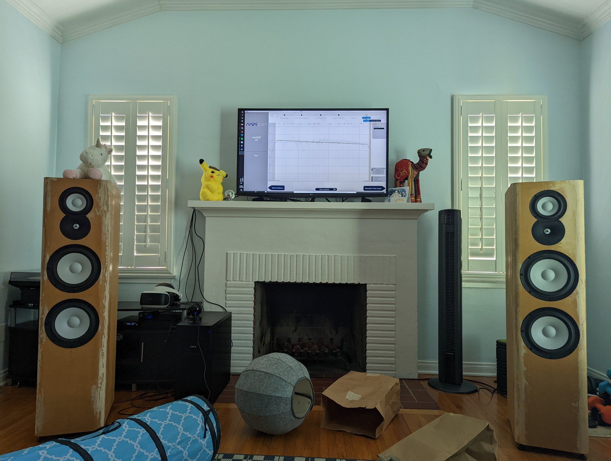

Hello floor bounce.
What gating does SHD use? You should look at impulse/ETC to see at what delay this strong reflection occurs. Then you can perhaps recognize the source - is it floor, backwall or perhaps ceiling. Then change position of mic or speaker and see how dip/peak change. REW is very easy with this kind of "analysis".

Wavelengths that are double that of a given distance between two reflective surfaces will create a standing wave. Same goes for discrete fractions of that distance. So low frequencies cannot set up standing waves in small enclosures, there is a lower limit for each enclosure.

Yes, standing waves in the enclosure are the worst source of cabinet sound, because the wave's pressure maximum is at the inner surfaces which heavily excites the walls to also make sound. It gets worse to handle the larger the cabinet is, because larger wavelength = lower frequencies are more difficult to absorb effectively. The cabinet wall panels also show resonances, I often try to set the internal braces that the first panel resonances are out of the woofer's transmission range, and that the resulting panel areas are unequal to distribute the overall parasitic resonance spectrum. Some rough analysis of that effects for a large speaker may look like this:

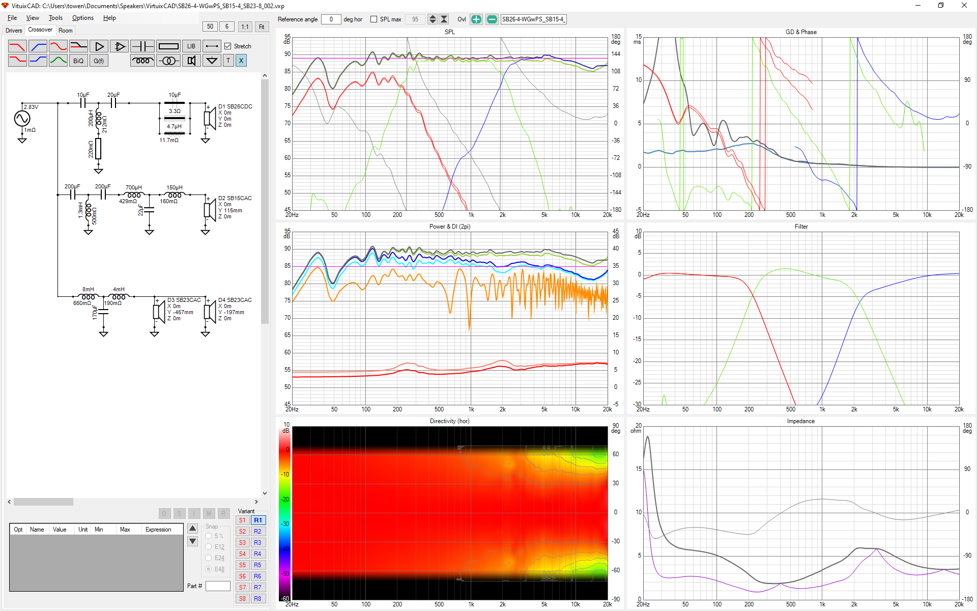

Would It be worth updating the woofer to mid crossover from 2nd to 3rd order? The speakers measure and sound great currently, but wouldn't mind pulling the breakup of the woofer further down if it made sense to.
I have been playing with this and the trouble I am running into is I can't keep the impedance reasonable. It is dipping below 2 ohms rather broadly in the lower mids. Looking for any tips or tricks I can employ to make this work, if it is even worth the effort. Things seem to work reusing my 8mH and 4mH iron core inductors, but I will be looking at getting another 370uF per speaker which is $$$ in poly.
How about 2 separate 8mH coils, one to each woofer, instead of stacking the woofers in parallel (directly) ? Adjust values as needed.

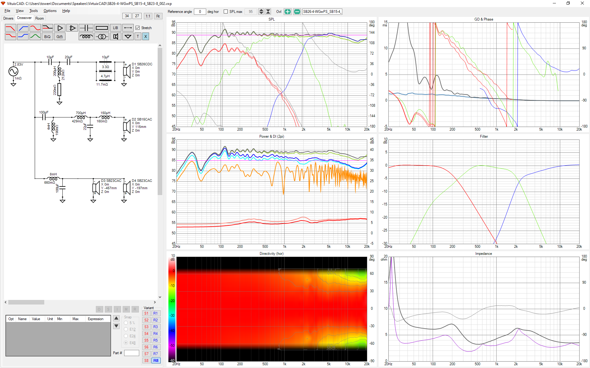

Maybe try the above idea in 1st order, then compare the result to what happens if you add capacitors.
^It has nothing to do with the woofer, its the mid. (BTW: If you make two separate lowpass for both woofers, you must double coil values and half capacitor values to achieve the same behavior as the woofer impedance per "channel" is doubled. But this overall makes no sense as you gain nothing but increasing cost and build complicity by increasing just number of parts...)
The 3rd order option looks much worse budgeted to me with the 2x 200uF in the mid highpass. There is correlation between the mid overshoot around 400Hz and deep impedance drop at that frequency, the filter overshoot/overswing sucks the current needed for that by the low impedance. Group delay gets worse bump there too (symptom of the filter overswing energy storage, and overall higher GD due to the higher filter order. This frequency range is most sensitive to GD distortion), phase responses of woofer lowpass and mid highpass match better with the 2nd order also. Stay with the second order, sizing of the components and result looks much more reasonable and nice to me. I see influence of the impedance at the mid's resonance frequency to the electrical filter response, but overall resulting acoustical highpass filter slope looks well.

Playing with the crossover I think the real issue is the sensitivity of the mid. With the higher order crossover I need to boost the high pass, and as you pointed out that just leads impedance issues. Not going to pad down the rest of the system just to get a higher order crossover. I wish SB Acoustics had a true midrange in the CAC series like Revel does for the Be series.
So I think the conclusion is leave well enough alone, haven't had an issue with the 2nd order cross in application.
For people trying to spot the issue (I missed it for myself earlier), look at the 2nd chart on the right in both images, see in the electrical crossover how much boost is required to make the mid meet the woofers on the 3rd order cross over as compared to the 2nd.
Also as to the excess energy in 3khz, that isn't so pronounced in the built speakers. It is just an artifact of my data for the waveguide in vituixcad not having the perfect level match to the drivers in baffle. Was able to shape the mid/tweeter crossover with just that shunt resistor on the tweeter.
