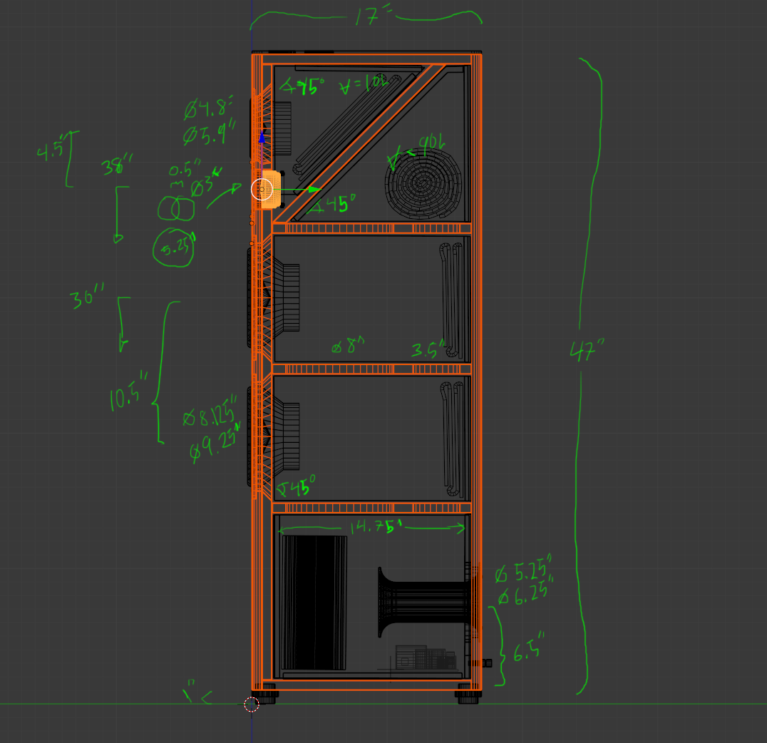

So I want to go for a large floorstander. My current conception is a 2x8"+5"+1" with about 85-90L in the base cabinet. The room it will be used in is on the edge of small, 13"x18", with a typical asymmetric opening to the dining and kitchen. Speakers would be on the short wall and about 18" from the front wall (already started building a diffuser for the back wall). The driver complement would be the ceramic range by SB Acoustics. The tweeter and midrange seem to be well regarded in what I am seeing on forums, particularly the midrange (SB26CDC, SB15CAC30, SB23CACS45). The woofer seems a bit spendy, but the matched aesthetic is nice. As an alternate I am considering the RS225, more on that later.
Gonna try to find some good baltic birch, shouldn't be a problem here in LA. If not I will use MDF. I am going to use buytl deadner, 1/2" felt and polyfill where appropriate for backwaves and standing waves.

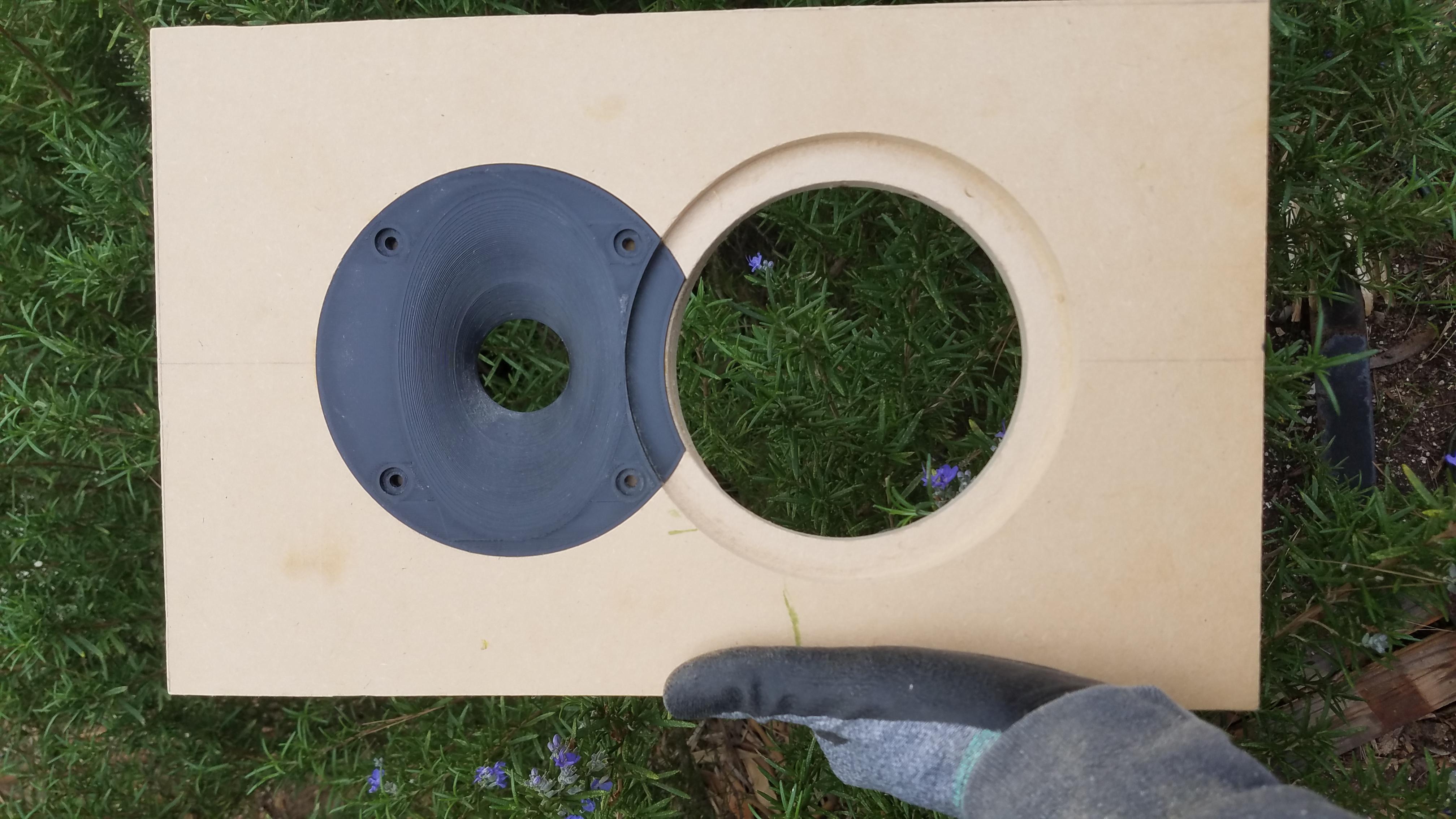

I want to try a waveguide for the tweeter. It is an edit of the Soma Sonus 5"x0.75" waveguide. They have test results already for the SB26CDC. I would have one 3d printed in nylon and then resin cast from that so I can make some extras if I get motivation to build surrounds.

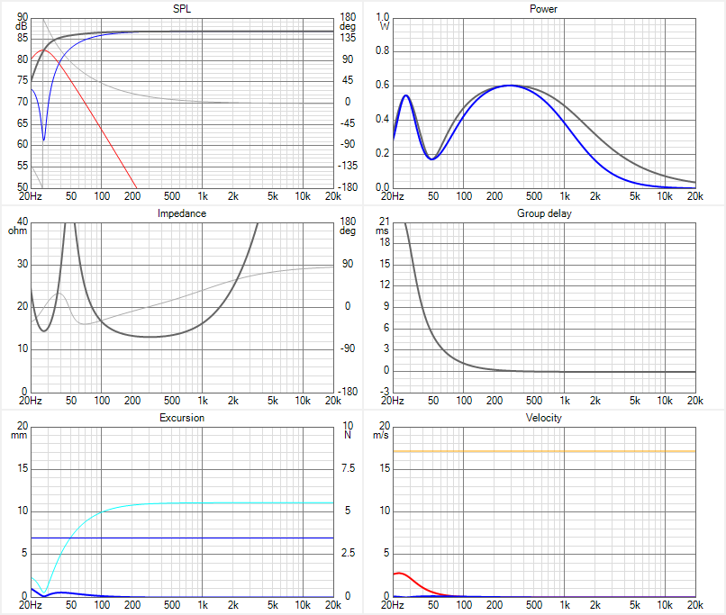

I have attached a rough of the measurements of the cabinet, 47x17x11.5" w/o plinth. Basically as big as it gets to cut each from a 4x8' sheet. ~10L for the midrange and ~90L for the base cabinet. Port would be a 3".

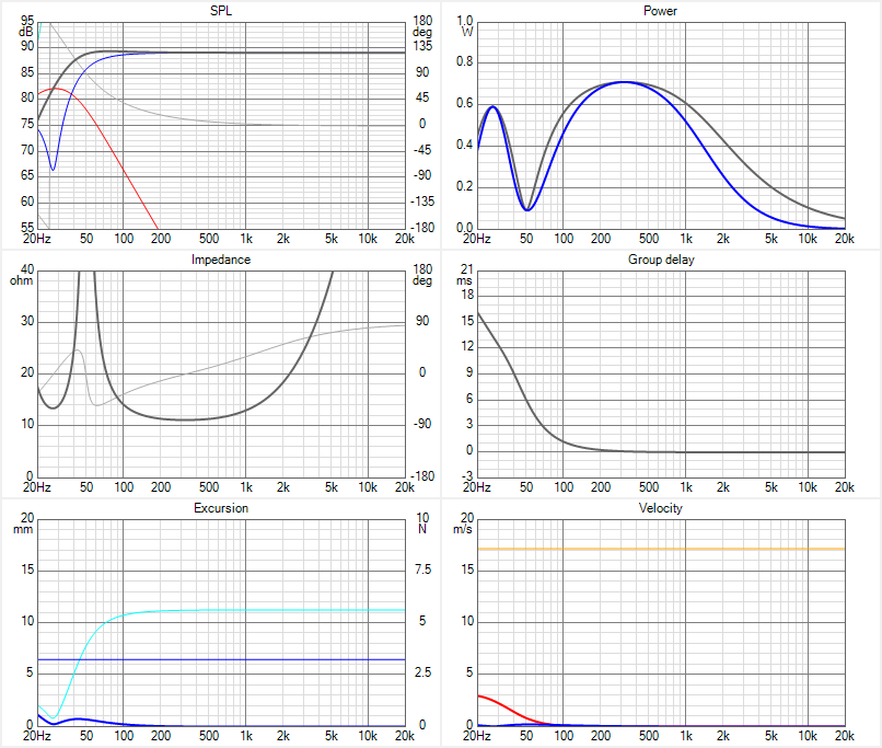

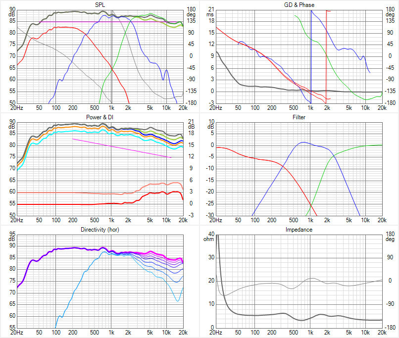

I have also attached some cross over and box responses comparing the SB23 woofer to the RS225. Generated from VituixCAD and traced curves. Cross over points at about 350Hz and 2200Hz, subject to change when I measure. Targeting about a 5dB slope from 100 to 10k. Only a resistor change on the woofer between the two. From what I am seeing the RS225 seems to win out on base extension (30Hz f3 vs. 35Hz f3) and price (saves $250 on the pair of speakers). Is there likely to be a benefit of using the SB23 other than aesthetics? I know the RS225 is well regarded and sees use with some seriously high end mid/tweeter combos so who am I to push against that.
Wouldn't mind some general feedback if I am on the wrong course. I have spent a two months now absorbing as much as I could from DIY sources, so no need to refer me to the basics and I should understand the jargon.
TLDR; RS225 vs. SB23CACS45?

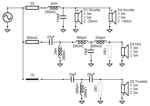

I see the pictures, now, after log-in: what about putting the crossover out of the box ?! Still it's about box environment...
Now let's see the Xxx-over...what's that 3 Ω resistor in front of the woofer??:whazzat: Maybe better to take a look at Jshadzi's design!
Take that 3 ohm resistor out! If bass efficiency is too high, then get a pair of 4 ohm drivers and put them in series - that will be 3db less than parallel 8's. And the RS225 is a very good driver. Otherwise I am impressed with your plan. But it is just a plan, and will require fine tuning once it is built.

In a larger cabinet volume, a pair of ported Aluminum SB23NACS45-8 woofers can produce -F3 = 30Hz - 35Hz bass. Good value.

Thanks all for the replies. Did my homework on the resistor with the woofer, won't be using that. I suspect it won't be needed given BSC, but still need to check with a 4 ohm.
I did a quick sim of the Ceramico's crossover and it looked a mess, so going to have to give it a second closer look. Maybe I got my curve traces wrong. I have seen those names around on some great speakers. Will use that as a basis moving forward, just want to cross the tweeter lower in the waveguide

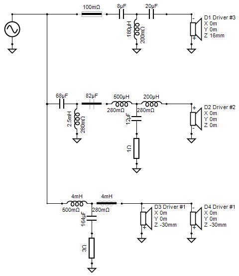

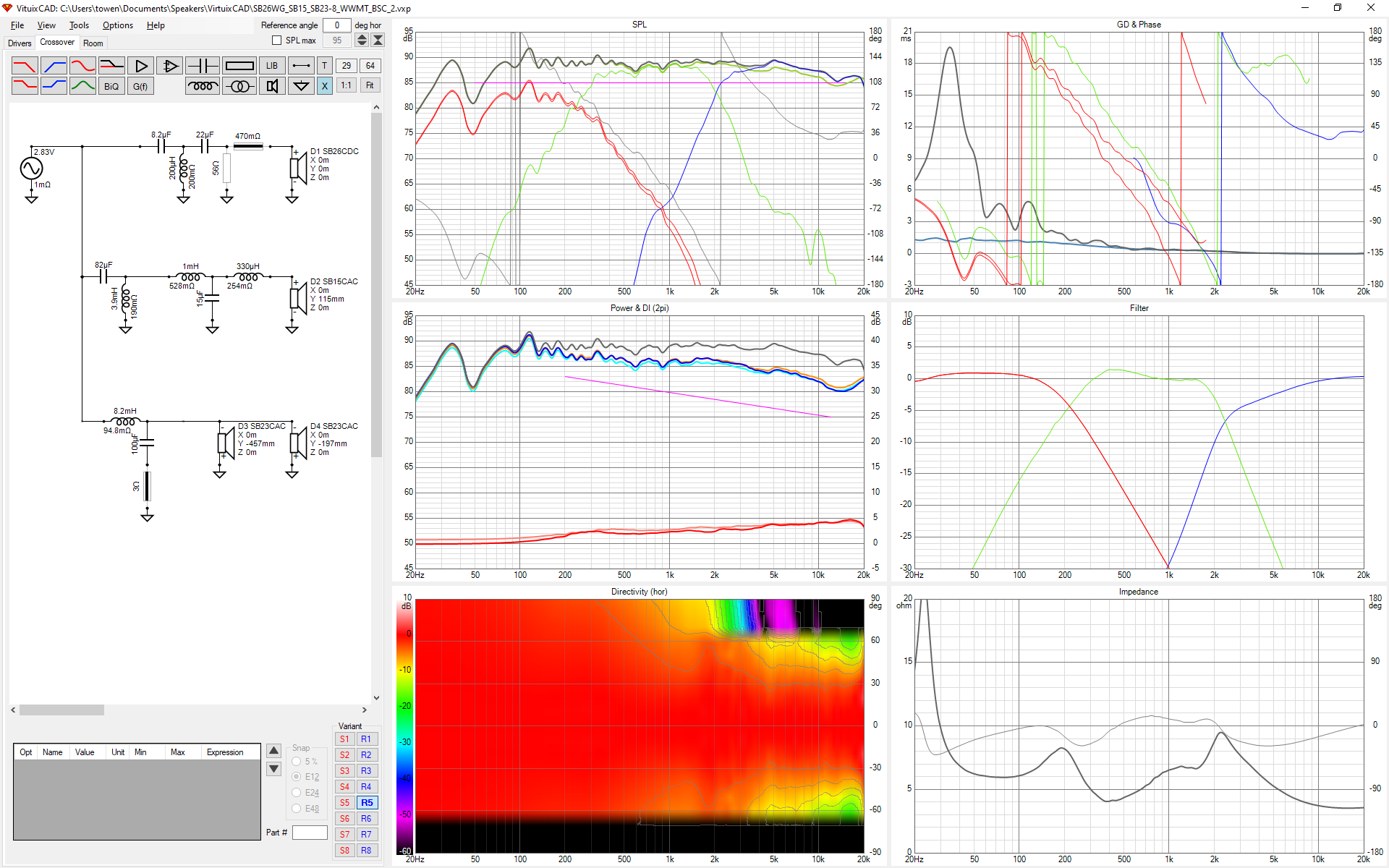

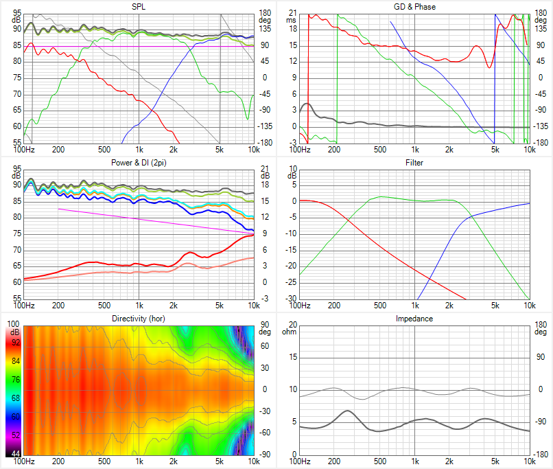

I had just switched from XSim and didn't know about VituixCADs other features and have poked about the diffraction module and come up with some more plausible crossovers. playing with both a wave guide and standard faceplate on the tweeter. Looks like I will be fine with the 8ohm woofers and no series resistor. Incorporated what I saw in the designs and feedback you all gave me (thanks a ton, always need a bit of a sanity check and confidence boost to take on a big DIY project).
The waveguide data I have is probably not normalized to the same sensitivity as the SB direct data, so gave it +3dB. Will have to measure in a test baffle myself to know where that stands. Attached what I found working with the standard faceplate. Crossover at 300Hz and 2.8kHz.
Probably enough simulating until I get the drivers in a cabinet, don't see any reason they won't perform well.

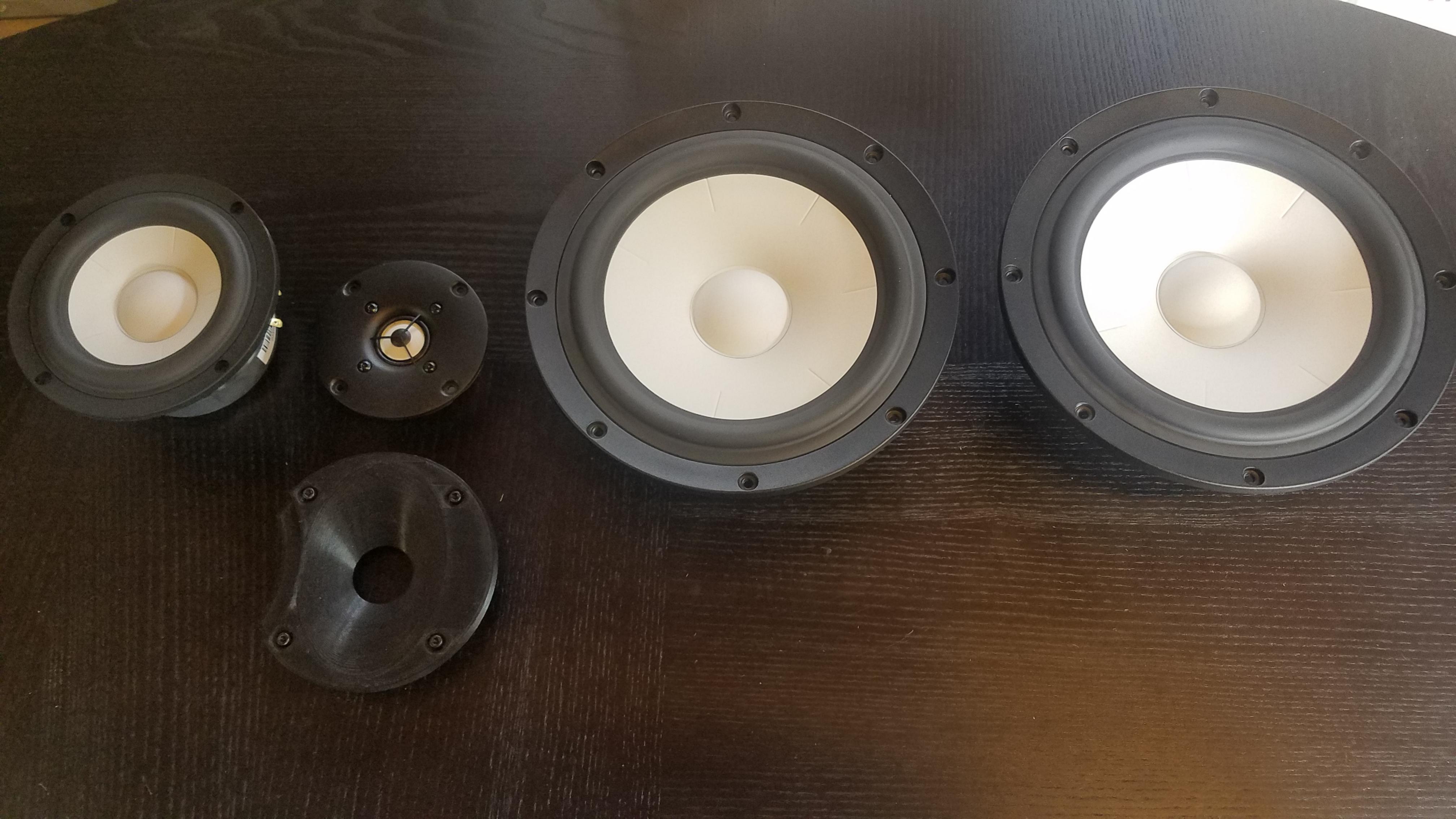

Been a lot of planning and second guessing over the last year and I am ready to start my build. The drivers are here and they look great! (one 5" does have a stray spot of glue on the cone, shame)
Done some more work on my crossover plan, will build cabinets and measure first. Directivity looks really nice, will have see how the frequency response turns out. Please let me know if I am missing anything obviously wrong.
Sill have some work to do on my planned waveguide with the phase shield. Might make the phase shield removable so I can try out some different geometries.

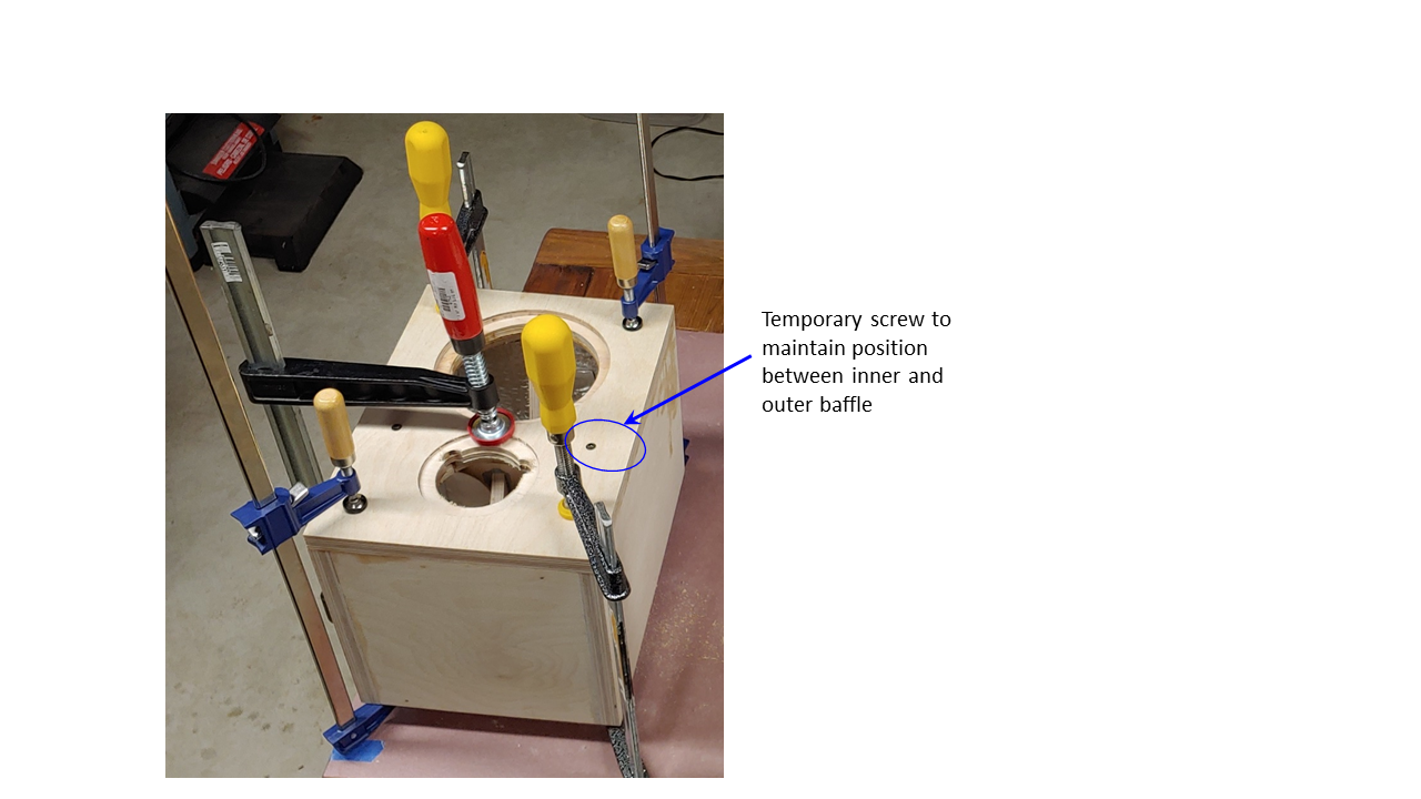

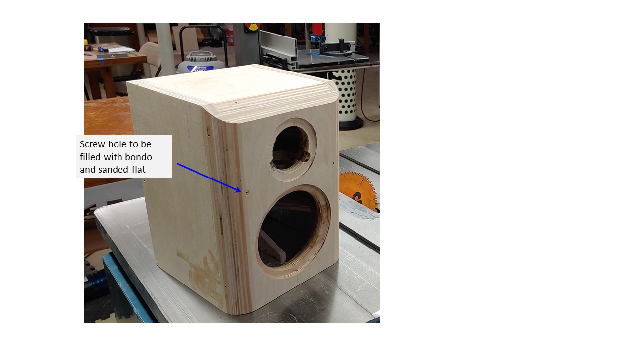

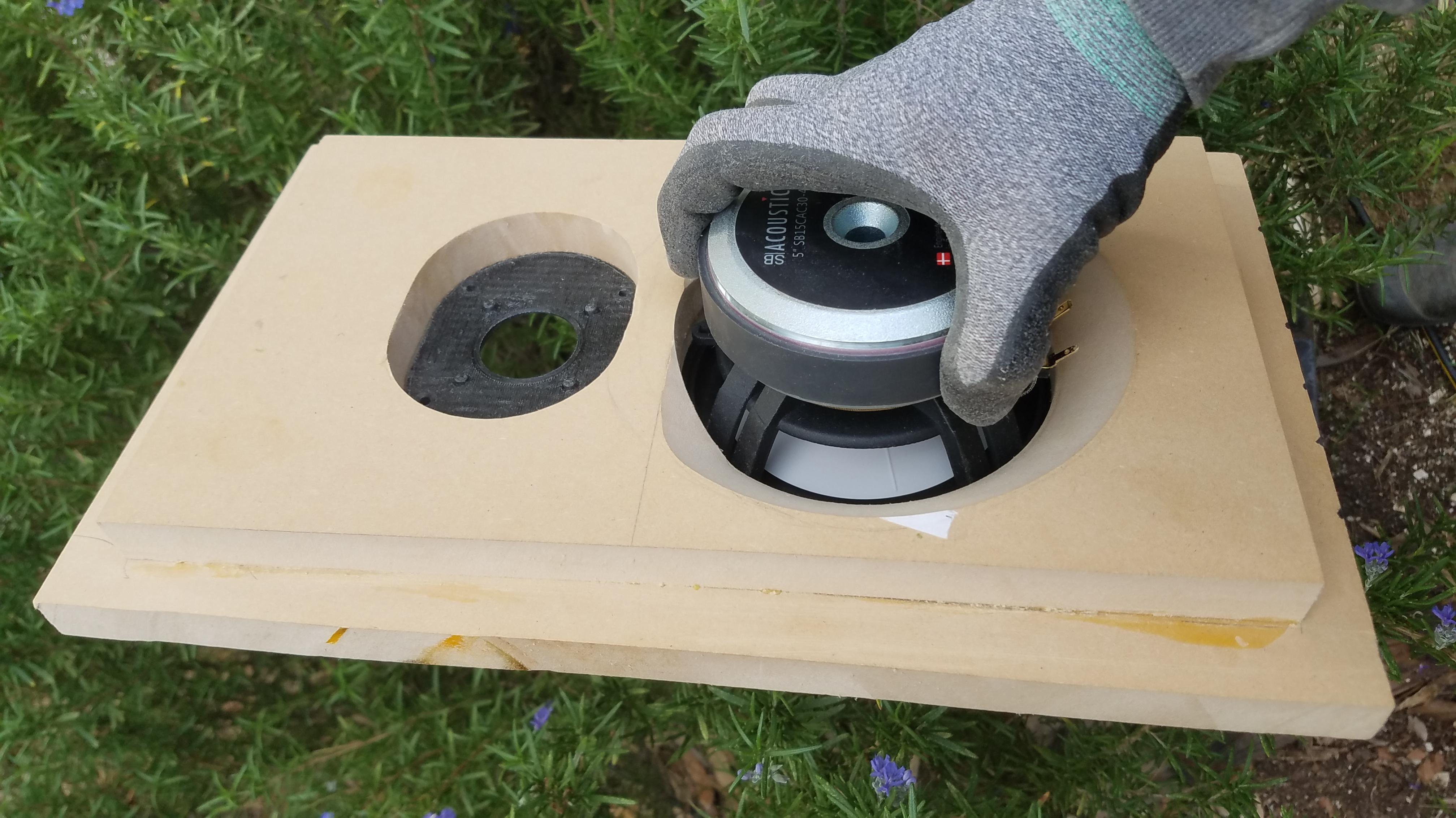

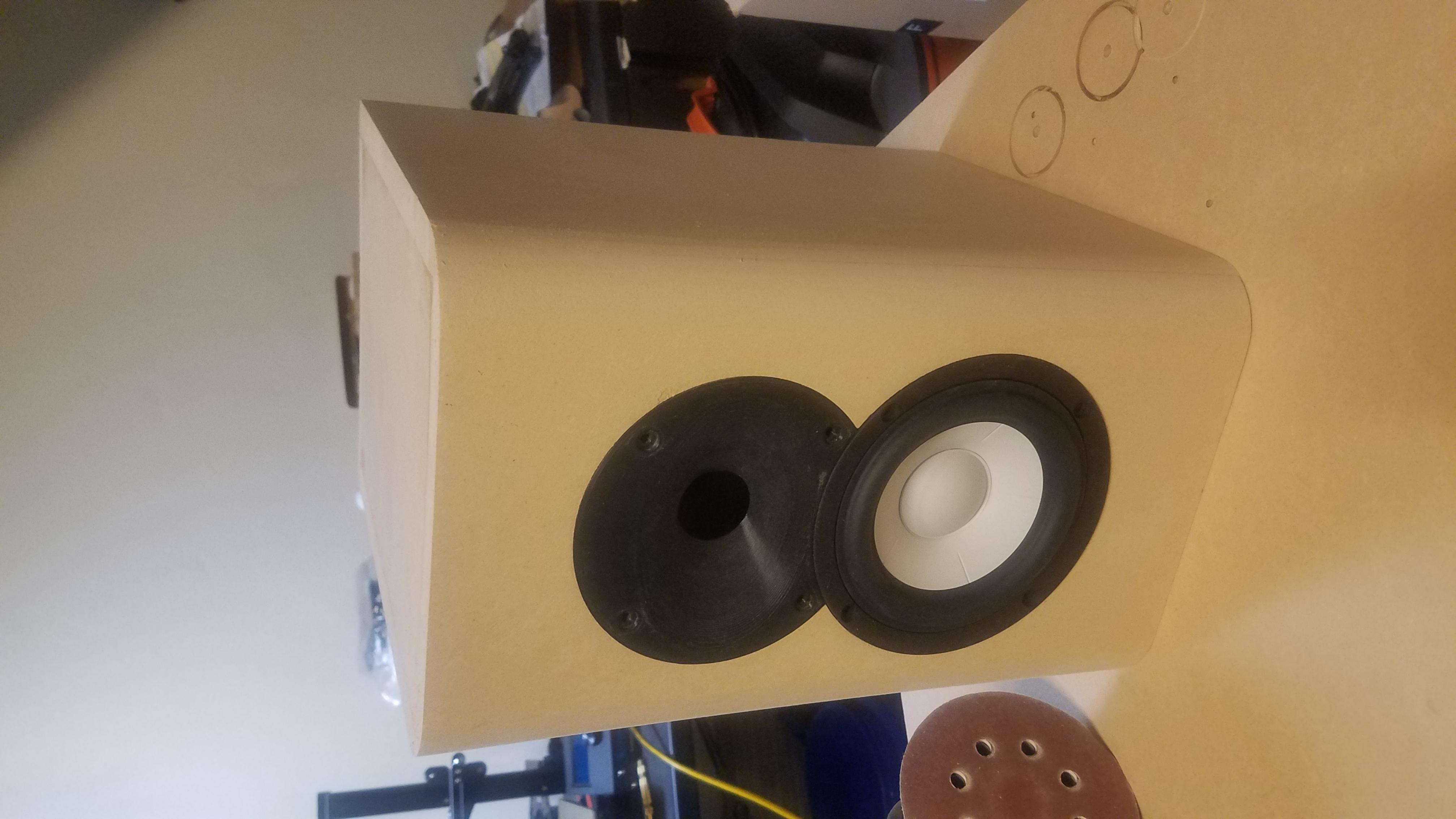

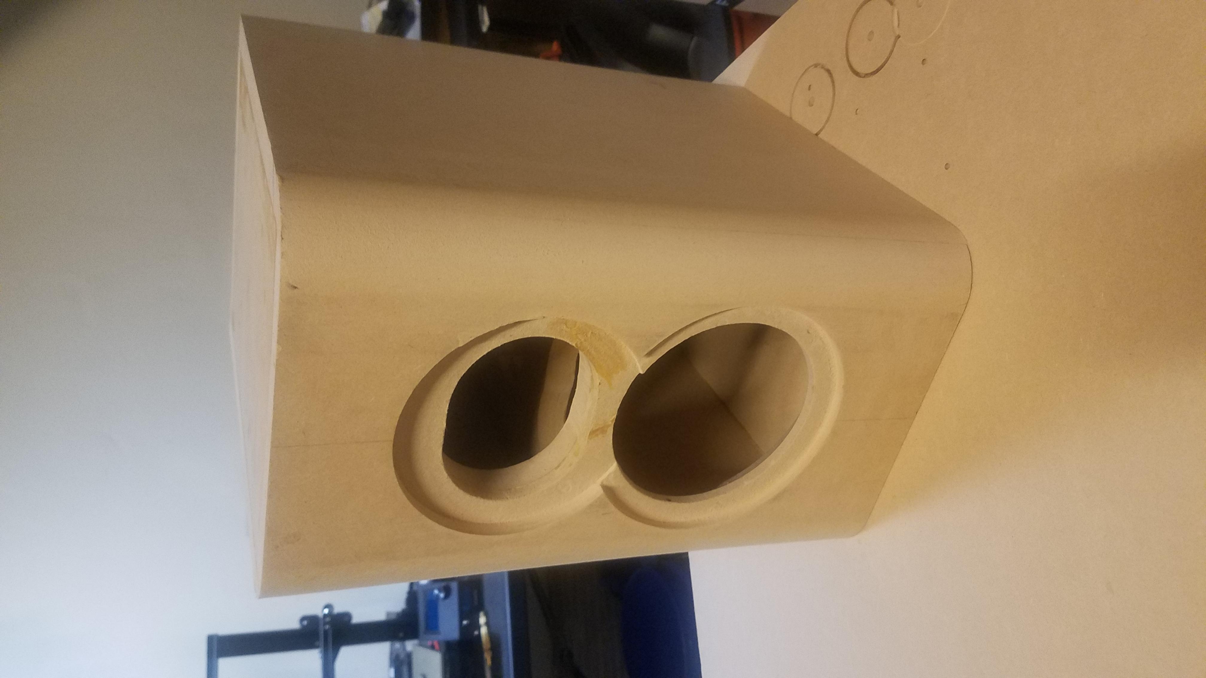

Decided to build a smaller test box to make sure I could get everything done with something easier to handle. Knew I needed more clamps going in, but really underestimated so basically doubled what I was going to get. Only issue I had was when I glued the inner to the outer front baffle it slid a bit. The waveguide and mid went together really great. Things are at an interference fit right now, not sure if I should open things up a bit more. 1.5 inch round overs look great, should make veneering easier and have a diffraction mitigating bonus.
Time to move on to the full sized cabinet!

... Only issue I had was when I glued the inner to the outer front baffle it slid a bit. ...
A common problem. Some builders will machine a dado and matching groove so that the outer baffle indexes to the inner. Another technique is to use small dowels as alignment pins.
A more simple approach that has worked for me is to clamp the pieces together without glue, and then drill and install several screws. Then I unclamp the pieces, and unscrew the screws until the pieces come apart. When it is time to glue, I rotate the screws until they protrude slightly from the first piece. This allows the screws to "find their hole" even in the presence of slippery glue.
I apply glue, press the pieces together and let the screws find their holes. Then I screw them down tight. Then I apply clamps to ensure even pressure and good glue up.
Later the screws are removed and the holes filled. Since everything is getting veneered, those small filled holes are insignificant.
