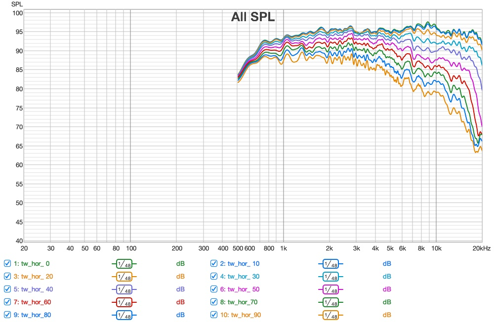

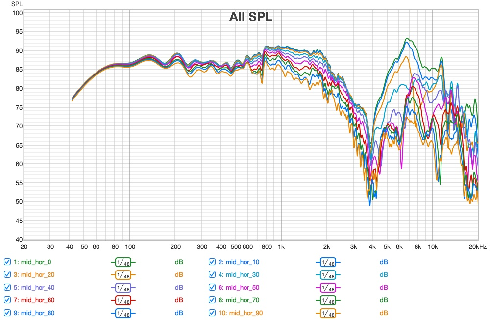

I don't think so: the tweeter output would be visible as more even and stronger output up to 20 kHz.could it be that I forgot to mute the tweeter? Would the effect be like this?
Also, phase is still all over the place. I must be doing something wrong. There seems to be no improvement from room size, so must be another cause.Will add full files tomorrow.

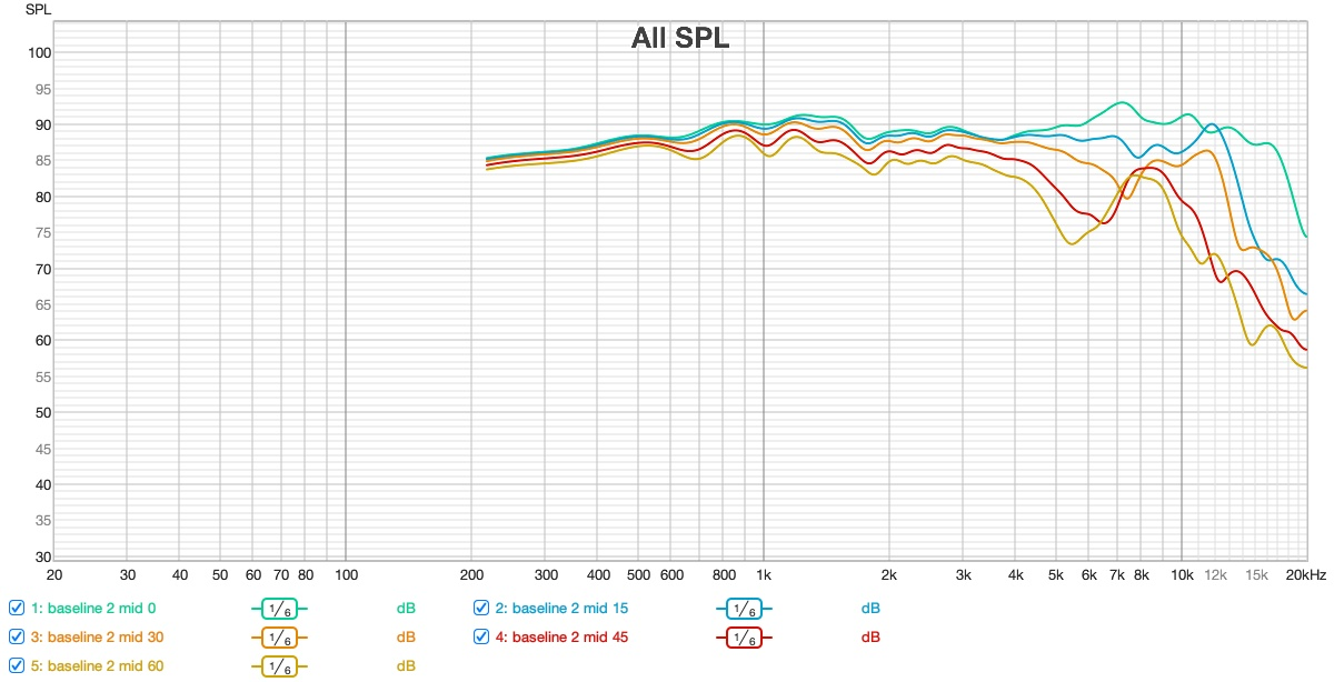

Indeed, I should have been checking more carefully during measurements. Such an opportunity lost! But I think with this experience I can manage a new set either in a similar large space, outdoors or even at home and it will be goud enough for final DSP setup. I am starting to have a good feel on behaviors of the three drivers. For example, I am now confident on polarity of all three channels. I can see where and how much EQ is needed and where the crossover points should be.
However, I am still completely clueless on phase. How to measure it, how to interpret the results, and what to do with it is a mystery.
I will add the files later today once I am back at home and would appreciate any help understanding the phase.

@LojzekWhat you fail to realize is that your whole problem is frequency response.
What is the whole problem with f response?

The problem is in making decisions which of the many ones is the most true to a real thing.
Your mid measurements are not of any use in the manor that you plan to use them. However, there's enough good information to get it done using "old school" techniques.@Lojzek
Don't take this too literally, but phase is mostly a result of the response changing.

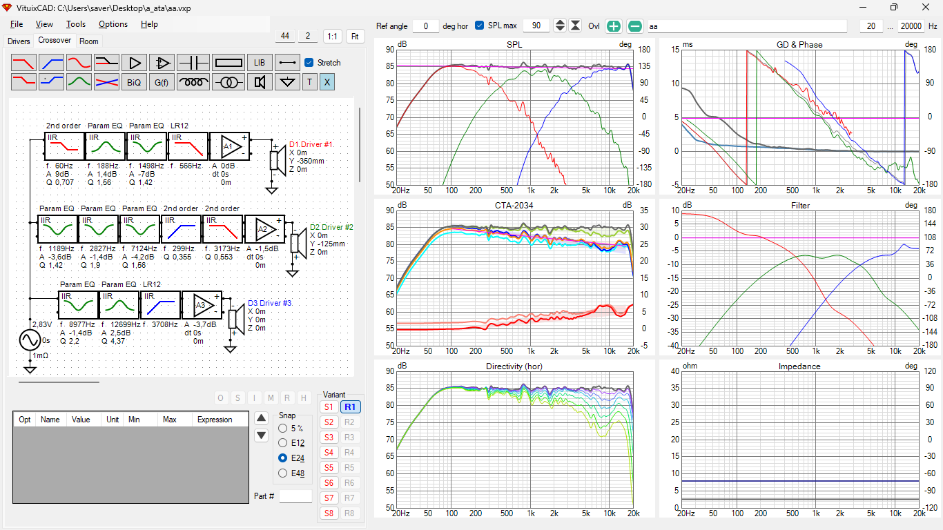

Of course you can load all of those .frd files from the drivers measured at 18" into Xsim4 or Vituix CAD and design all the filters in software. Adjusting the delay the exact same amount for all the drivers will flatten out the phase plots so they make sense. I did it with Xsim4 and then transferred the filters into Hypex filter design. The Hypex software also has measurement capability that works pretty well.
