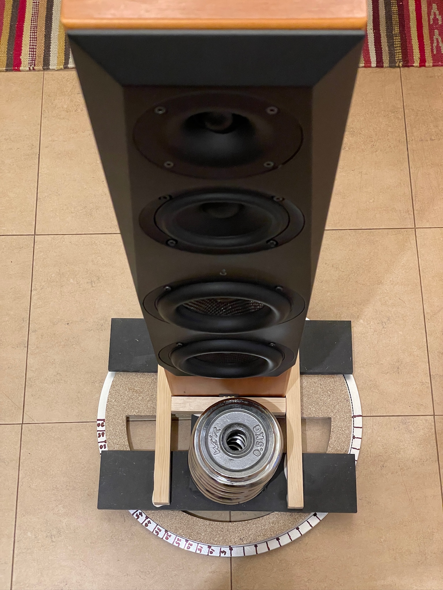

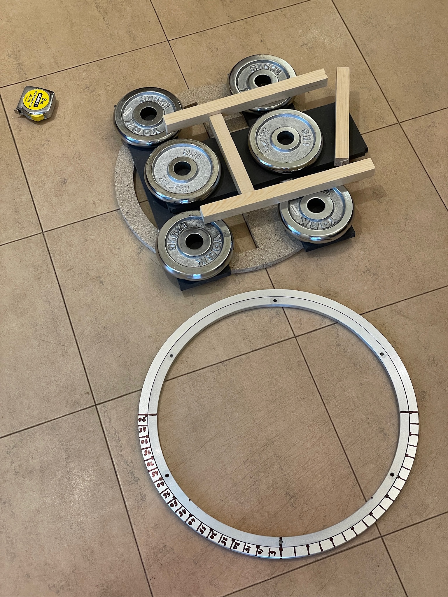

Improvising a turntable for measurements using a 40cm lazy Susan and leftover wood.
Can you adjust the pivot point still? Looks like you need to move the speaker towards the weights slightly, although that may be an optical illusion.
One option for getting the woofers up high is to turn the speaker upside down.
The surface of the front baffle is over the pivot point to within 2-3mmCan you adjust the pivot point still? Looks like you need to move the speaker towards the weights slightly, although that may be an optical illusion.
Depending on what furniture acrobatics we manage on the day, we may well need this option.One option for getting the woofers up high is to turn the speaker upside down.

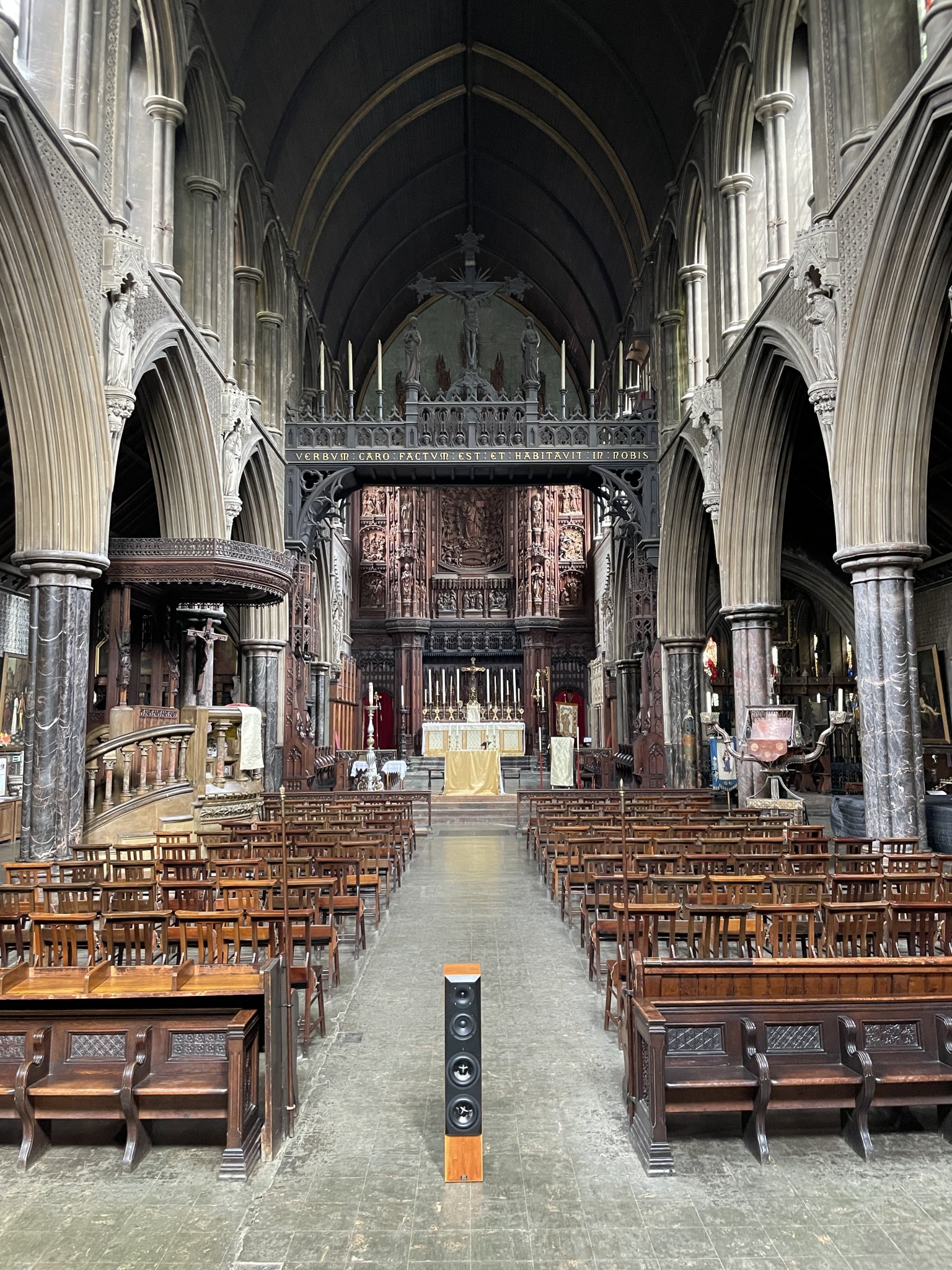

Yes, but I was not planning to do that. Will do 5deg step to 90 or 120deg. 1.5m mic distance.Will you be able to make x-over adjustments during the measurement session?
I understand priority one is off axis set for each driver.
If we have time left I was then planning to do full speaker with a certain crossover set. 2m distance, 10deg step.
To be honest not sure why.
Third priority would be nearfields of each driver, but as I thought I could always do these at home, priority is low.
Or do I need to do something else while in this large indoor space? We would have about 4 hours (incl. setting up/down).

Maybe too late to change, but that column looks rather close. Also the thing the speaker is sitting on is close to the woofers. I know it would be awkward, but I'd flip the speaker. Hope everything works out! Be really careful. a speaker falling from that height would cause a lot of damage.

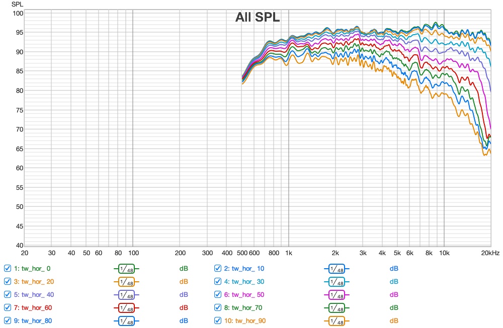

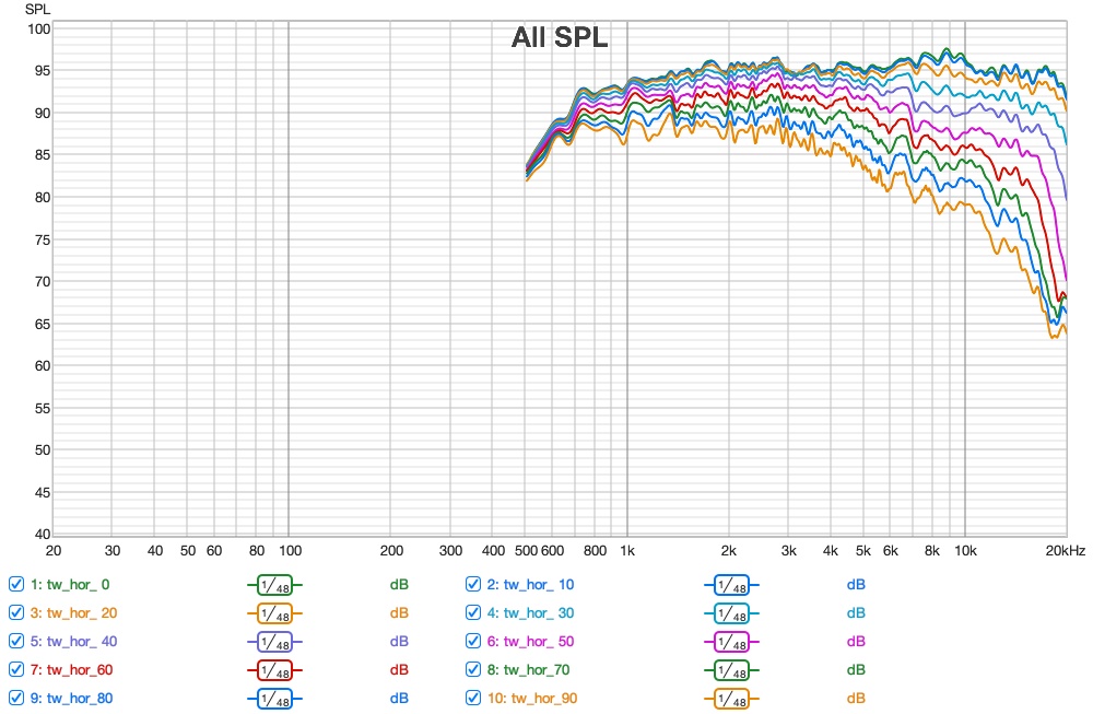

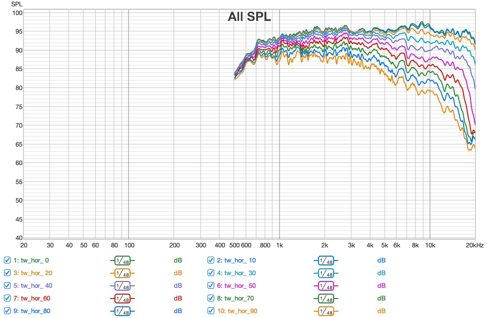

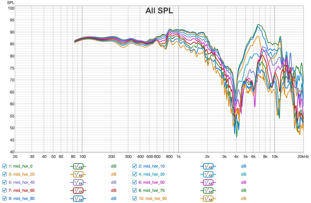

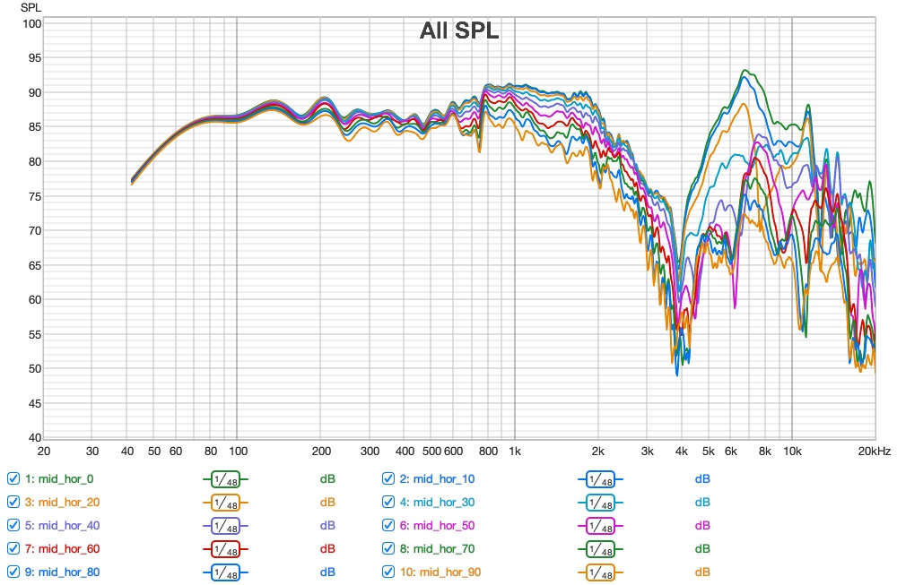

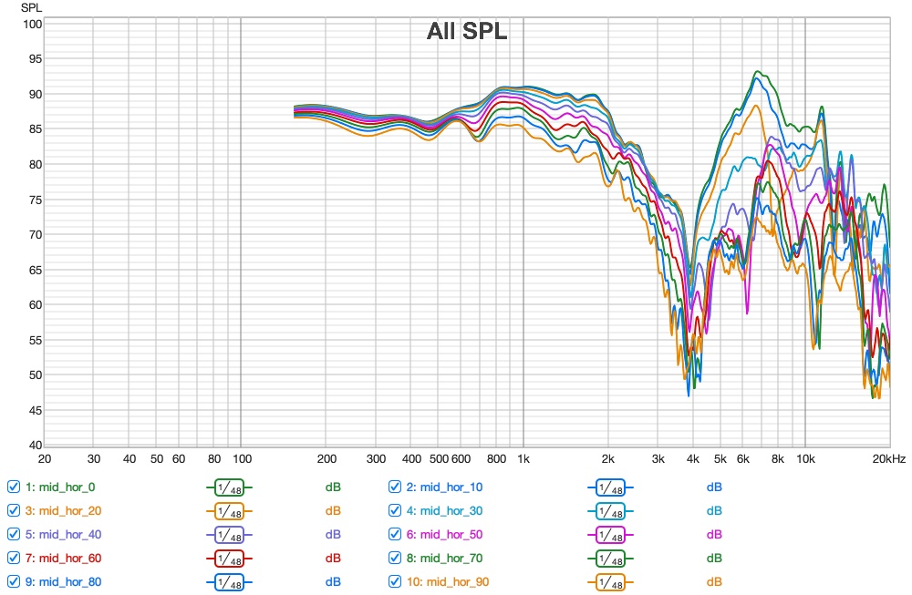

Midrange:
The massive 4kHz dip is a complete surprise and I have no idea what has caused it. No such dip was showing on two previous attempts (I think I used the other speaker). Hmmmmm.
Edit: could it be that I forgot to mute the tweeter? Would the effect be like this?
6.5ms
12ms
24ms
6.5ms
12ms
24ms
Overall experience of measuring in a much larger room:
- noise and reflections were easier to deal with (both in the setup and to see where the reflections are on the impulse response)
- completely puzzled by the 4kHz dip on the mid (which is unlikely related to the room)
