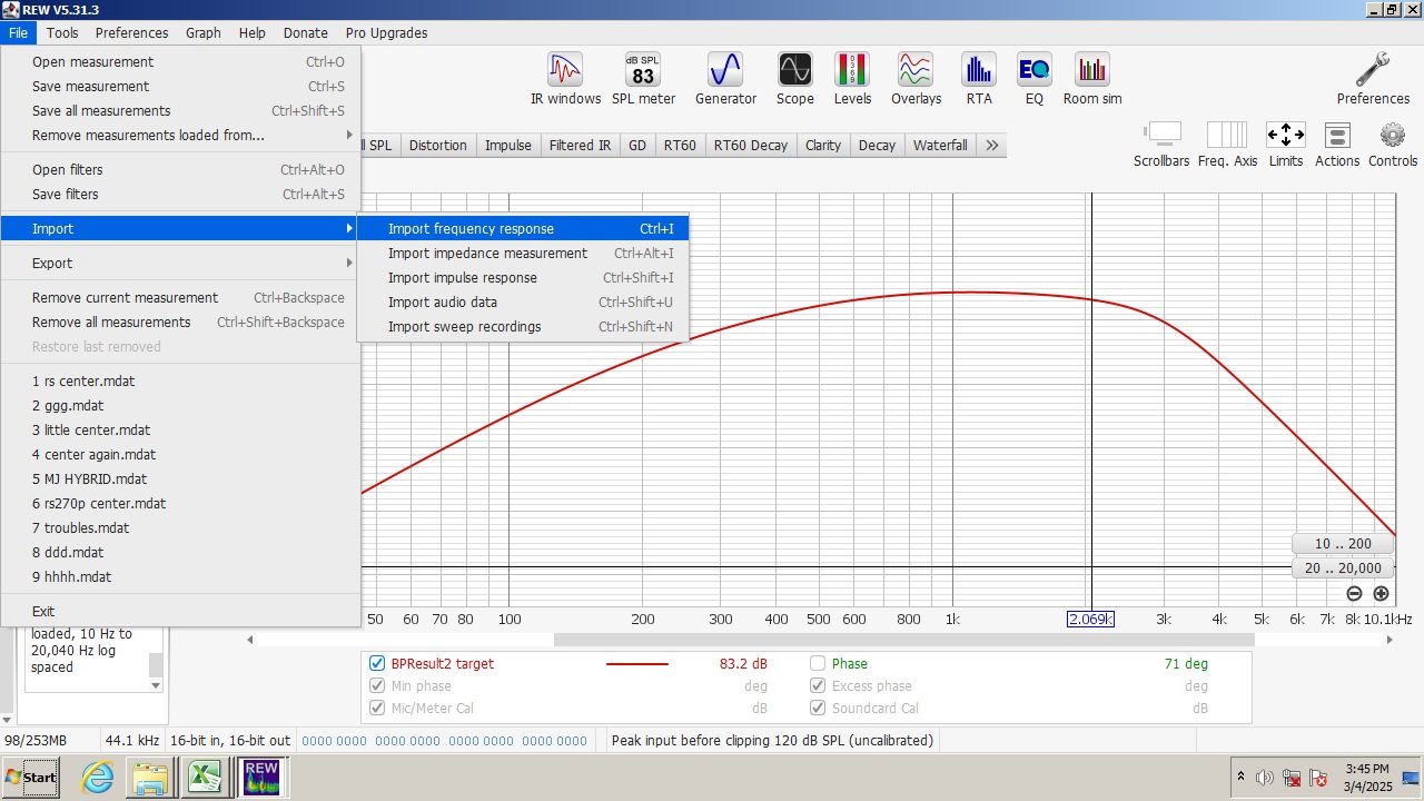

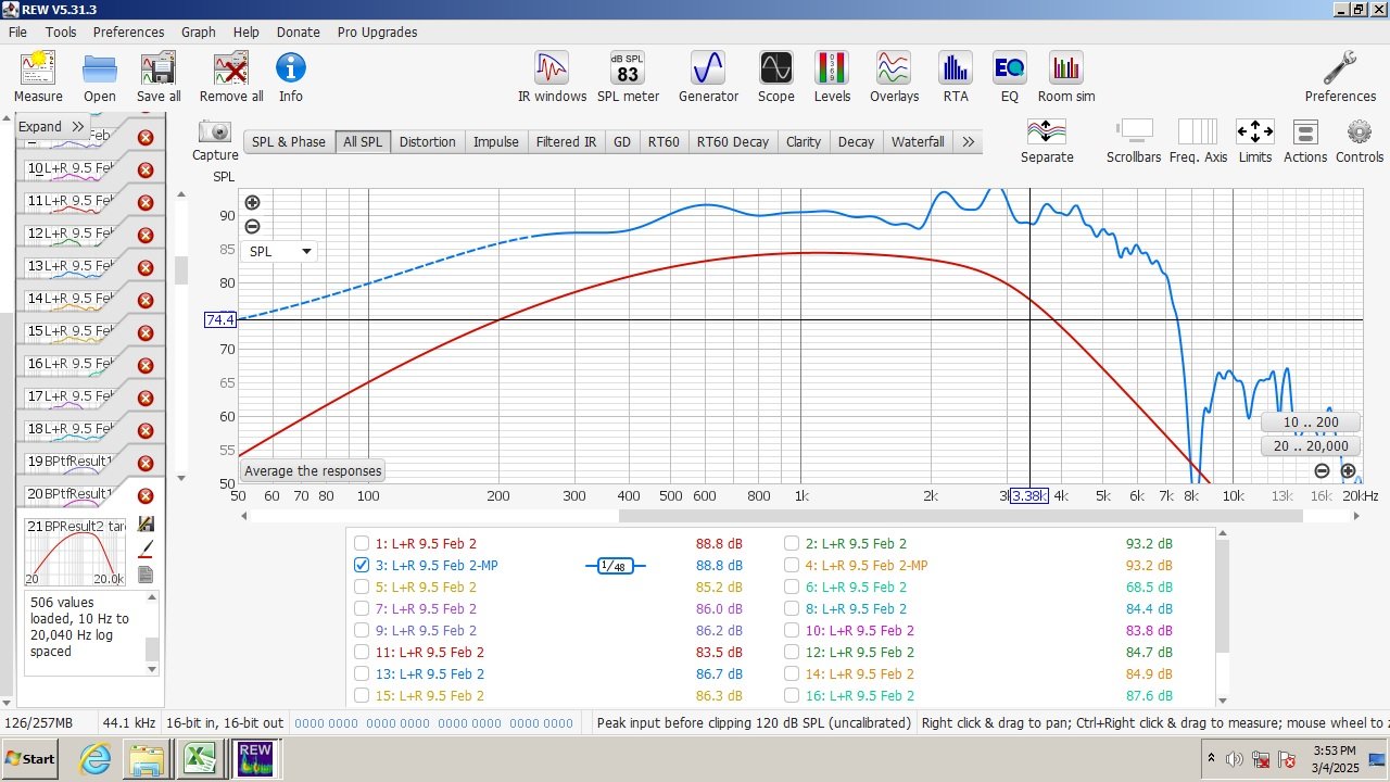

I was able to make a target response using PCD. It's simple to import an frd into REW. Here's a target, and a raw woofer measurement to use as an example. Basically, I would add filters to shape the woofer response to match the target. So maybe to start I'd select a 1st order filter on both high-pass, and low-pass, and see what it looks like. Second adjustment would probably be reducing the gain 3 or 4dB. Then adjust from there. Odds are in this example, neither the high, or the low-pass filters would not be a 4th order, which is what the other suggested method might suggest. The other methods may also be excellent. (I didn't read them all. ) I'm just pointing out a different way of doing things.
Now that I have learned how to do this target for REW, I may use it with my trial and error passive x-overs on occasion.

Just to make sure I understand correctly: I create (not sure how) an arbitrary target response curve and import it into REW. REW will assume it is a free-space response target and will generate a set of filters that will modify a previously measured response to match the target as close as as it can. Then implement these filters in HFD and hope the response will also match the target. Right?
I am not sure what frd is. Is it a text(?) file with a dB response value per frequency? so I could just type one up? or is it smth else?
I sent a PM to someone who knows REW much better than me. I made my above posted target using PCD. I'm not sure if REW will match that target, but there is a section in REW that appears to be made for doing targets.I'm pretty sure the subwoofer guys do this to match a room bass target. This is under the EQ tab in REW. It's probably easy once someone tells you how. I've not attempted to use the feature.

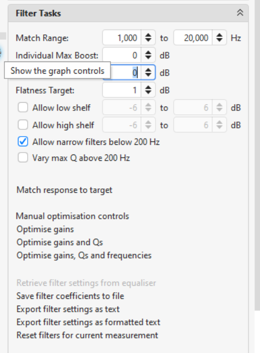

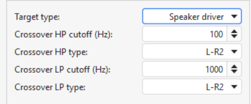

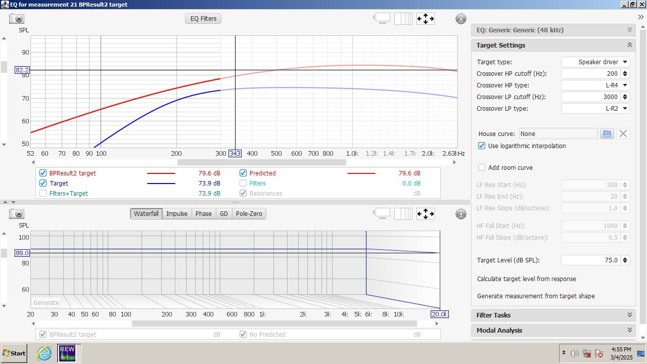

Marty sent me this for using REW to make filters. I've butchered it trying to copy, and paste, but here's the reply.
Yes, but it depends on what filter results you want, such as for a specific DSP or just generic filters, etc.
With your measurement loaded and selected active,click the EQ icon:
Right side, start with generic or select the DSP you're going to use these with so it generates filters that are useful. Your choice. Lots of choices here.
Usually you see people use this for subwoofers and house curves, but it has a full suite for full range drivers. Select the type, which really just enables bandpasses for use:
If you do a speaker, it will have new parameters with crossovers:
If you do a full range, it will have different options (less):
Then the typical tools to effect which bandpass and slopes:
Then tell it what range to effect and how much boosting or cutting, etc.
Match.
Then save.
Very best,
~Marty
