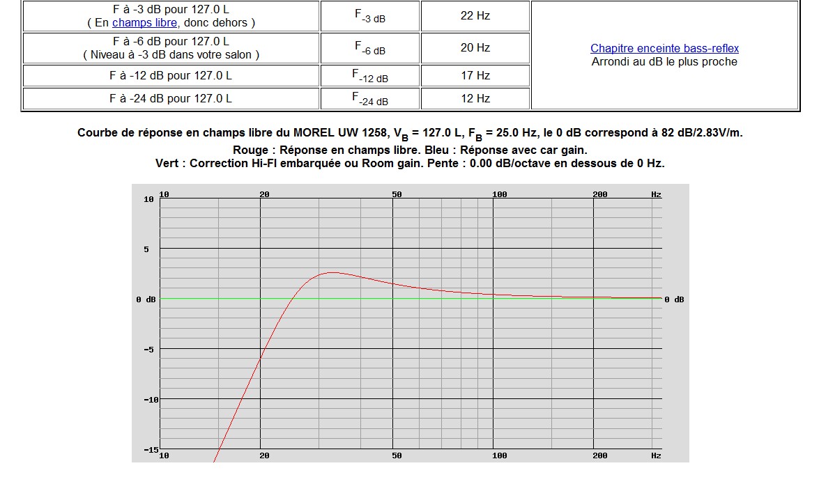

THIS IS WHAT YOU GET!
(And is not the same you posted.)
The alignment is different, as you can see, and I'm working with your values that you mentioned.
Internal = 127 L (127L = 4.4850ft³)
Port (diam x length) = 4" (10cm) x 8/9" (~22cm)
This port, besides having a small diameter - for the air speed/noise at max. volume only - but it's fair because large ports need longer extension/length - is not the alignment you mention or is required.
This alignment, you can check with any simulation I'm only checking here for the first time everything else being fine, giving 127L/25Hz tuning for the size of port presented (4" x 9"), with a frequency output curve that is not ideal as the one I'm posting below (25Hz vs. 20Hz) and far from the above. Look at where the lines cross for F3 and how abrupt the curve is with a low frequency extension and Fb higher than it should be (I would use 20 Hz or lower as was mentioned, close to ideal) for driver MOREL UW 1258.

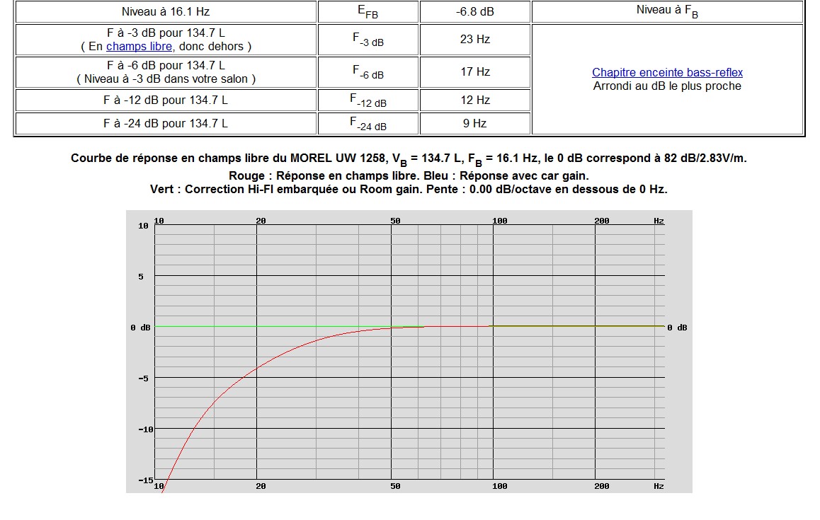

Sorry to say, and thanks for reporting back (you didn't mention 😕 the power of your amp by the way).
You need to review your system if you are looking for the right performance.
1. The first picture is what you have now.
2. The second picture is what you should have or an ideal alignment with the same mentioned driver (Volume/Fb) and with an ideal lower frequency extension.
Have fun. 😀

No it was not, for me.I think this was a bad thread to start.
We just need to be more specific some times.
In this case if you look at the graphs I posted, what can be a small difference in the driver/speakers output @20Hz of ~2dB if you observe thoughtfully you can find that the difference is ~7.5dB @15Hz, a big difference in fact (from alignment #1 to alignment #2) for the low frequency extension only (and you were right). 😉
