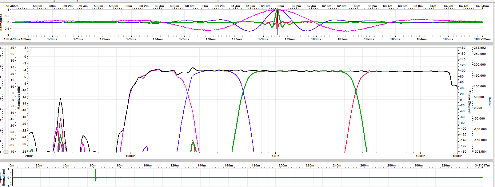

Give a man a passive crossover and he frequency-divides and level-matches one simple design somewhat painstakingly over days or weeks. Give a man a DSP active crossover and he frequency-divides, equalizes, level-matches, and signal-path-compensates many complex designs with instantaneous audibility of adjustments. I, for one, am :note:never going back again:note:.
Most of the work (at least for me) is in the calculations and simulations common to both types of crossover.
For me, no calculations or simulations.
Just measurements and putting filters, crossovers, levels, and delays directly into the processor from those measurements.
A 4-way main like below takes less than an hour to measure and construct all four sections.
Acoustic responses and impulses of each section, with black trace being measured summation. 1/12th no gating.
That's a beautiful tune you're singing 111dB! :note:never going back again:note:.
