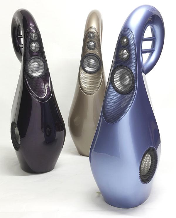

Well designed 4way example is vivid audio giya g3. And its not 3way with sub either.

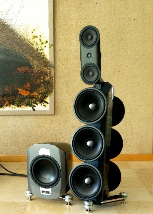

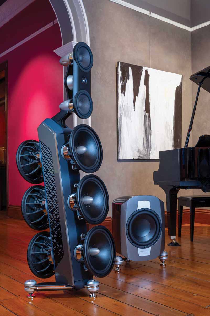

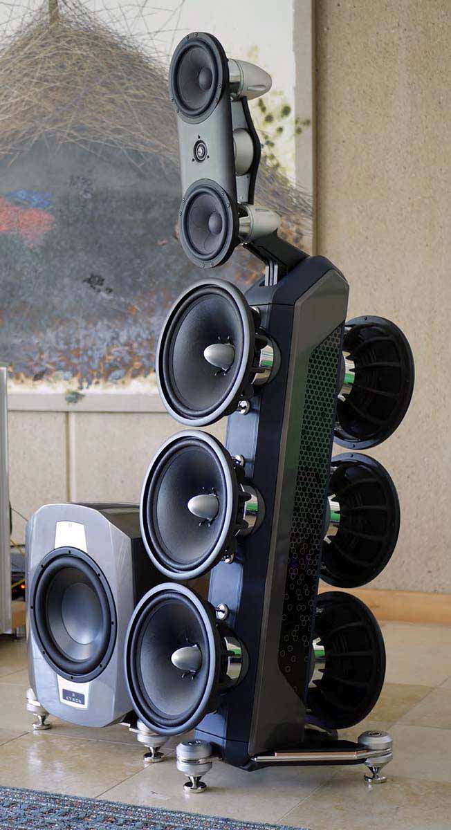

This is 3way with sub. They started selling the main speaker without the sub first, only later added it. Kyron Gaia.
Sub is sub when its crossed low enough that can no longer be localized. Then it can theoretically be placed anywhere. Sub itself should not be heard, only noticed when turned off as some bottom missing. But system should be able to perform just fine without sub. Most of the time i noticed incorrect setup for the sub, too loud or crossed too high. Or not steep enough.
