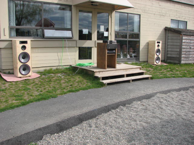

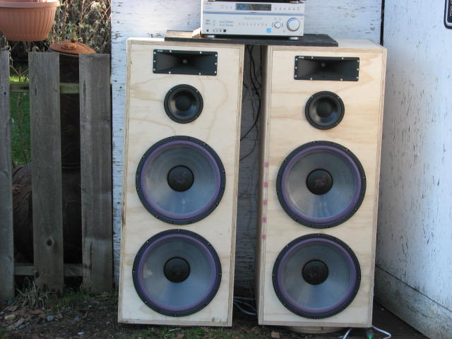

Did these with two 15's, a 6.5" and a horn. XO's at 800 and 4K IIRC.
The midrange has it's own cabinet. Works quite well but is intended for what you see, not really indoors.
Better to stack your mids not side by side.
Good luck with your project.

Ok, my crossover frequency suggestion was based on that. So that just leaves the earlier suggestion to set your crossover where the TPL is comfortable with power handling.Hello, we are planning to put the mids next to each other horizontally
