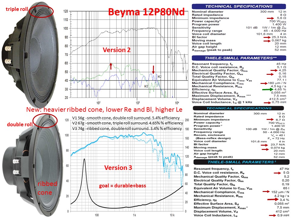

PS... The latest Beyma 12P80ND-V2.5 uses a ribbed cone. You may want to try to purchase the 12P80ND-V2 with a smooth cone for a high frequency midrange.
The frequency response as per the data sheet for the 12 inch midrange is from 50 hertz to 4000 and for the pleated horn tweeter from 1000 to 23 K. The crossover point could be anywhere between 3000 to 3500. Do you still see a problem in using a 12 inch for the mids? Am I missing something. Please advice.

By the way we are using the beyma 12p80ndv2
Yes, it's a problem, because of beaming (very low dispersion, high directivity) of the 12 incher at that high.
Rule of Thumb 1: You want a speaker with either constant directivity through the frequency range (difficult) or one that smoothly narrows as you go up in frequency (doable).
Rule of Thumb 2: A driver beams at 90deg when the diameter equals the wavelength.
It radiates wider below and narrower above.
For a 12" that happens to be 1200Hz.
The horn of the TPL200H has 80deg dispersion so you would look to crossover at 1200-1300Hz. While that is within the ability of the TPL most here who used it report that it sounds better and less stressed if crossed at 2000-2500Hz.
So to keep the dispersion smooth you should be looking at a 8" or 6.5" midrange.
