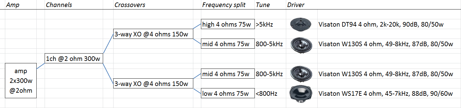

I would like to make a 3-way speaker with all 3 drivers being 8 ohm individual.
If i connect all 3 drivers to 3-way crossover designed for 8 ohm drivers will it require 8 ohm amp output or 2 ohm amp is just fine?

If i would connect 2 x 8 ohms crossovers in parallel on one channel would it make a total of 4 ohms load?

Makonga wrote:
810742d1579696797t-3-speaker-8-ohm-crossover-2-ohm-amp-2x3way-png
I strongly suspect the midrange speakers you show in that diagram are the same, and you are connecting *one* speaker to *two* crossovers.
If so, that is nonsense. Sorry. (or "crazy" as picowall would put it).
Besides that, you are connecting your crossovers wrong: using only 2 outputs from 3 way crossovers leaves unterminated strongly inductive/capacitive elements, a mess and it may even damage your amplifier.
Again you believe "crossovers have impedance" which is wrong.
Did you notice you talk of three speakers but show four in that diagram?

one XO would produce 8 ohms impedance, in my scenario i would lose some power.
WRONG. Read above.
Doesnt 2 x4ohm XO makes bass and treble also 2 ohms?
WRONG. Read above.

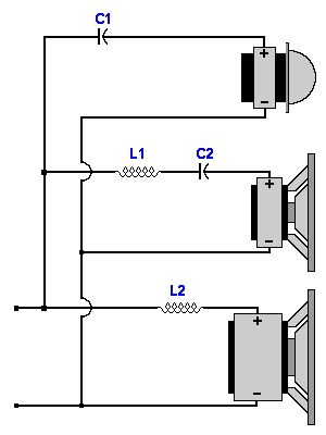

Good day, community. I would like to make a 3-way speaker with all 3 drivers being 8 ohm individual.
Hi Makonga!
When the members of this community think of a 3-way speaker, they think of a high frequency driver, a dedicated midrange frequency driver and a bass frequency driver, all powered via a 3-way crossover.
Choosing 8 ohm drivers will result in an 8 ohm 3-way combination - for 4 ohm choose 4 ohm drivers.
You have confused the issue by showing four drivers which don't adhere to the above pattern.
The attached diagram shows the simplest 3-way arrangement possible.
A single capacitor directs the high frequencies to the tweeter, a series capacitor and inductor combination directs the midrange frequencies to the midrange driver and a single inductor directs the low frequencies to the bass driver.
I hope the above information may assist you in designing your 3-way speakers.

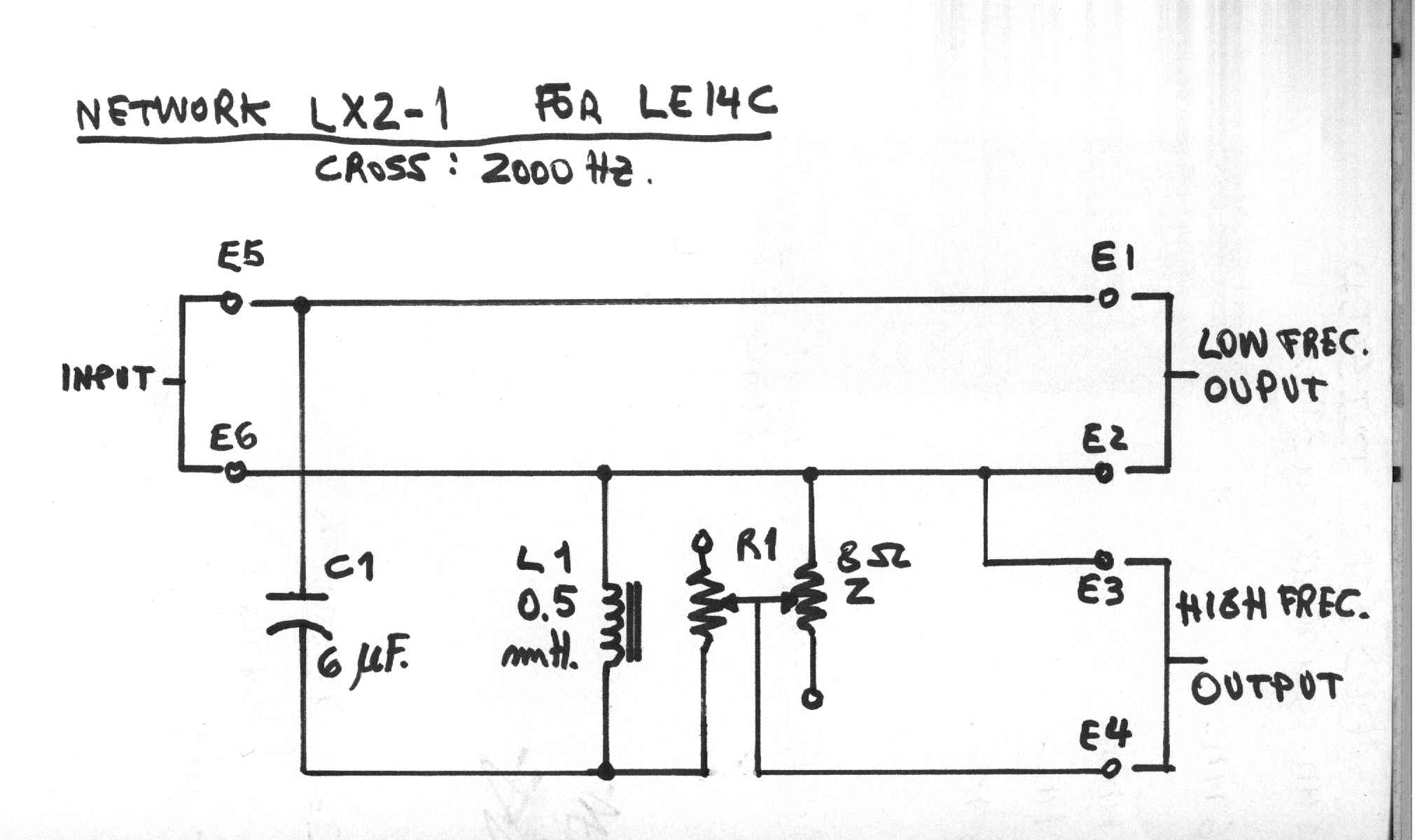

Actually, if you want to reduce it further, it is not necessary to use the inductor in the bass speaker.
There have been "high pass / mechanical" media filters since long ago
My JBL LE14C is like this, the signal with all the frequency content goes to the speaker cone, then, the undulations filter the treble naturally (cone break? CSD?) To a sector in which the average frequencies reproduce in the smooth sector which is close to the center of the speaker.
I never designed a crossover, although today there are programs to do it. But not everything is as the books say. For example, something very accepted is that the media speaker must be isolated Yes or Yes from the twoofer and tweeter ......
Troels does not do it in the DTQWTII, JBL did not do it in the LE14C, and I attest that both have excellent means, with a lot of impact and naturalness.
