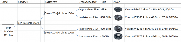

Any thoughts about this setup below? 😕
I have no idea - yes, the halving of output is theoretically right, going with double Z load.
You have to chose the specific drivers - woofer, midrange- tweeter and make a crossover tailored to them. Or find a specific design with drivers and crossovers already tested. Nothing particular difficult ( the latter )
A 4 ohm crossover does not make the speaker 4 ohms. Instead it is called a 4 ohm crossover because it is designed to adjust frequencies better with 4 ohm drivers, that is all.
Doesnt 2 x4ohm XO makes bass and treble also 2 ohms?
At each of bass and treble frequencies you have one driver, the tweeter is 4 ohms and the woofer is 4 ohms. At midrange frerquencies you have 2 drivers, both 4 ohms=2 ohms total.
You have this for left and again for right. Dont add them together, you use a separate amp for each side so work them out by themselves.
