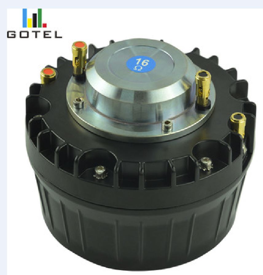

AND NOW: Time for something completely different!!
There are internet ads from China speaker companies selling an under $200 clone of the BMS 4592 coaxial compression driver. Build a wood horn and add a 15" woofer and you have a nifty 3-way speaker and some education. A USA group buy might be worth exploring. Any experience with this China coaxial compression driver?
