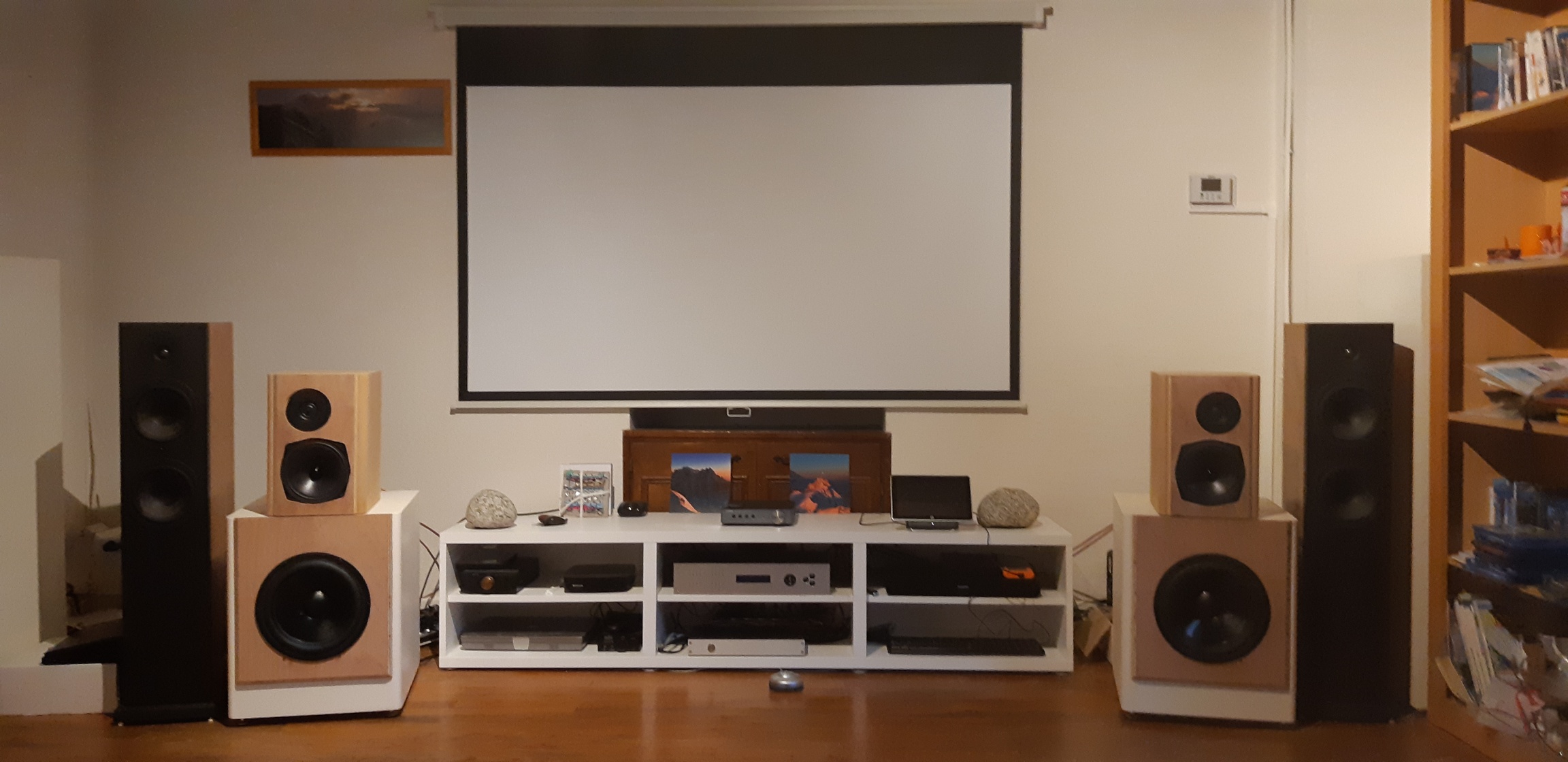

I was looking for a 10" in a three way project for home use. After reading the whole thread, I've built the bass section with the CA26RFX, reusing an existing sub case 65l/BR tuned to 30hz. I'm very pleased of this choise, flat response and more than enough SPL for a 25 m2 room.
The 3 way is active LR2 at 250hz/2100hz with SEAS CA26RFX + PHL AUDIO 1280 +R2604/8320, active crossover Najda DSP.
Speaker is powered by IcePower 50AS2 modules en Hypex UCD 180 for the bass section. See picture
This combo is sounding very good IMHO.
/Pascal

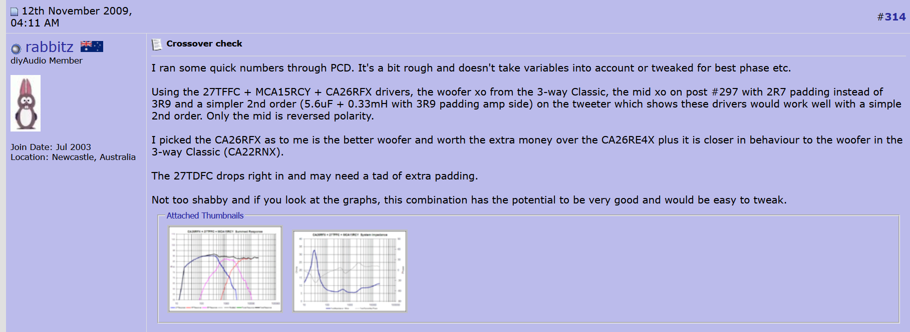

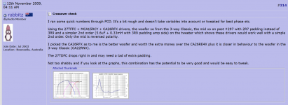

What was the tweeter and mid driver that was decided upon? Can you link to the post # which summarizes the configuration?
j.
Hi HifiJim
You can find a summary post #314 and few before, between post #297 and #331.
In attachment screenshot of the post #314.
BR Pascal
