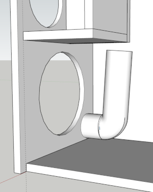

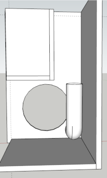

thanks to your suggestion I was able to calculate this
and then design this
Using this tube on the side the speaker should be something like this
What do you think?
What do you think?

On the back is not an option considering that speakers will be near the wall,

It has mostly positive effects:the side position has any difference (from a sound point of view) rispect the front position of the tube?
less diffraction for the baffle mounted drivers, eventual port or enclosure noises are less audible. Because of the low frequencies exiting the port the direction has a very low (no) influence.
If you use a tube port with roundovers inside and outside and you chose the same exit diameter the tube port will be longer for similar tuning.Which are the main difference between a straight tube and a horn tube?
Without roundovers the tube will excite chuffing noises and compress already at low levels.
Same for edges in the port, so probably better avoid sewage pipe joints.
You can use the optimizer tool to find the required diameter (Dext) for a port tube, allowing ~1 dB of compression at SPLmax. Just disregard Dmin and length in this case, for the tube port.

in this way the port length is too much for my 3d printer. So I have to consider again a PVC tube with a diameter of 10 cm. But now I know that I can put it on the side or on the back. So the dimension is not an issue anymore.
As alternative, I should print the tube in 2 pieces cutting it in the middle.
