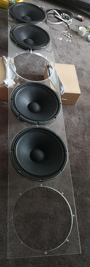

Bass array drivers arrived! Mounted, 3 in parallel and then in series. Measured RE is 4 Ohms.
Must work on the xovers measurements ect. Just finished the mechanical so was eager to get in a test session. Everything is sub par right now but........ so far sounds really clean. More to come later.

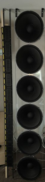

OK now I can see how it goes together. My first thought was some kind of coaxial arrangement. I like that clear baffle, shades of Soulsonic. Nice thing about OB is you don't have to build boxes...
Thanks! Decided to bite the bullet and get those made clear, didn't want them to look too imposing but they are still quite big to look at.

The PT minis are not running dipole right now. Going to see how they perform subjectively before doing the back to back PT minis in dipole config. In the past I've had trouble with treble dispersion in my room so I wanted to try something ultra-wide this time. The PT mini fit that bill perfectly and has great form factor.
The drill holes for the terminals are spaced at roughly 83.5mm. Of course my hand drilling is not that precise so manual tolerances observed but everything fit nicely with PT mini frames touching each other. I drilled all the terminal holes at one time before mounting any drivers so it should be doable. It was relatively painless to do. Sticky tape worked out great for mounting, gave a bit of wiggle room. Also didn't have to drill holes or screw in a large # of screws! Much easier. The home depot red double sided sticky tape holds them pretty strongly. I have to work at it to get them off the frame but they also provide some damping between the hard BB surface and the pack metal plate.
re "The drill holes for the terminals are spaced at roughly 83.5mm".
So you just bent the terminals flat against the end of the package? Reviewers at PE said this risked damaging the part
I bent the terminals back 90 degrees from their original position using needle nose pliers. It is totally doable without wrecking the part. Seems they use that liquid black tape or sticky black glue to put the back metal panel together. If one pulls too hard you might rip it off, just be careful. Also I used pliers to hold the terminals when I put on the quick connects. It wasn't too difficult........but be careful. Soldering the SB drivers was an order of magnitude harder.

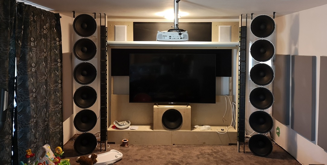

Thanks! Pics and measurements will be coming when I get the space cleaned a bit 🙂 also they are a bit too close to the side wall but this is the only place they can go.

How far off the back wall are these going to be? Some damping or diffusion behind the mids might get your imaging cleaner without detracting from the "boxless" sound. At least that's what I noticed when playing with open baffle.
Awesome build! Looking forward to further developments. Has a lot of potential to be a very high resolution system. Great choice on components.
Thanks for the tip! Currently they are 3 feet from the front wall but only 15" off the side wall (LA OB woofers closest to the wall, mids and tweeter on the inside). There is some bad stuff (TV and screen) between the speakers. It is a multifunction room so no choice here.
Had some dampling panels on the front wall behind the speakers but had to move them out as they were better suited in another location. I should order a few more or temporarily move them back for some testing. I do have damping on the side walls though.
If the woofer panels can be rotated the side nulls can be manipulated to try and mitigate the less than ideal placement. Worth some experimentation if you haven't already.
