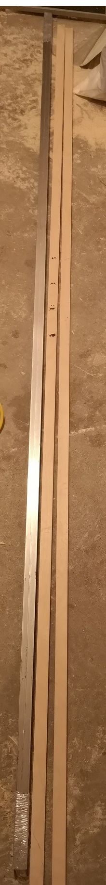

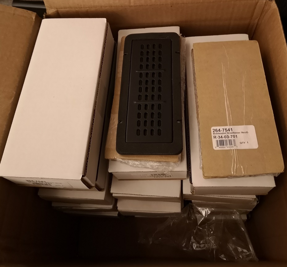

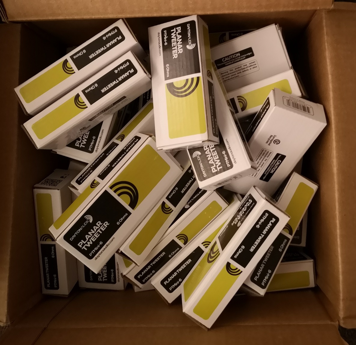

Some pics. Box full of drivers, aluminum square rods and some 1/2" baltic birch. Will try to start tweeter array first.

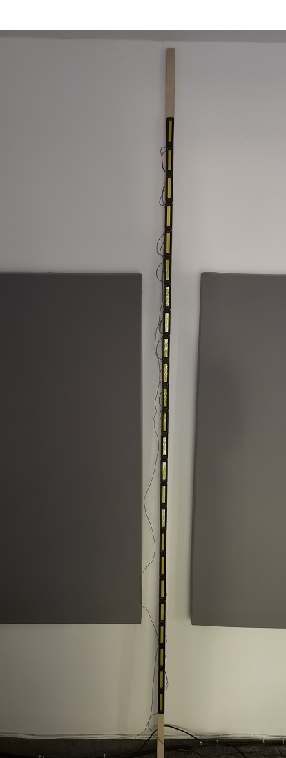

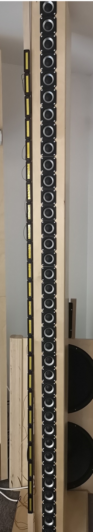

Finally got some time on these!! As per first post, 1" piece of wood cut. Drilled holes for wires. Bent the leads 90 degrees and used strong sticky tape for driver mounting. All in all pretty straight forward.
6 drivers in parallel and 4 sets in series. Should be nominal 4 Ohms, measured 4.1 ohms.
Tested 2 Tweeter arrays with my existing fullrange driver line array. The tweeter array adds what was missing. Very different presentation in the treble. The wide dispersion changes/makes the sounds easier to listen too but also with more treble detail. Sounds better when standing up too.

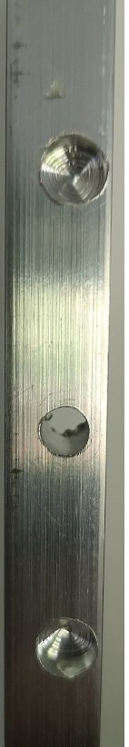

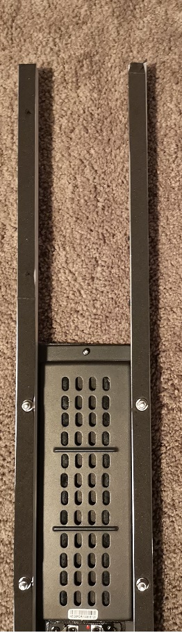

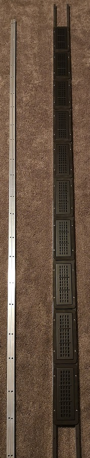

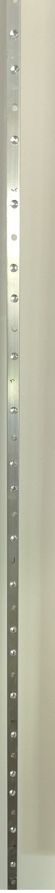

Progress is slow. Finished drilling the half inch aluminum brackets for the midrange sections.
After measuring out the holes, looks like 12 drivers (NEO8-PDR) per side can be accommodated. Currently I only have enough for 10 per side so I'll first make up the wiring harness for 10, 2 in parallel and 5 in series for around 9 Ohms. The 12 config sets up better for 3 in parallel and 4 in series for around 4.8 ohms. Some duplicate work but it will be a while till I can acquire 4 more drivers.

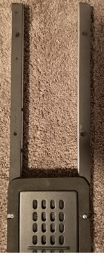

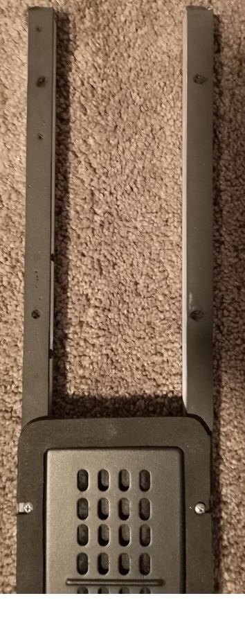

In the spirit of minimal baffle drills were made half way though the brackets to all for mounting of the NEO8 with rivets. Pics show a bracket and the cleared out sections for the rivets before 1/8" foam installed. I did not want to front mount the drivers as that would increase baffle width. Would it matter in the end? Probably not but drilling a few more sections was easier than using 1/8 inch strips with backing material. Would have be close to the same number of drills so decided on the cleaner look.
Driver center to center spacing is the 7.875" driver length plus 1/16". Tried to get them closer on a test baffle but the frames eventually push out the mounting hole spacing a bit. If only doing 4 drivers it might be doable but more than that require some extra spacing.
Fingers crossed on the driver mounting. Must sort out ceiling mount before installing the drivers.

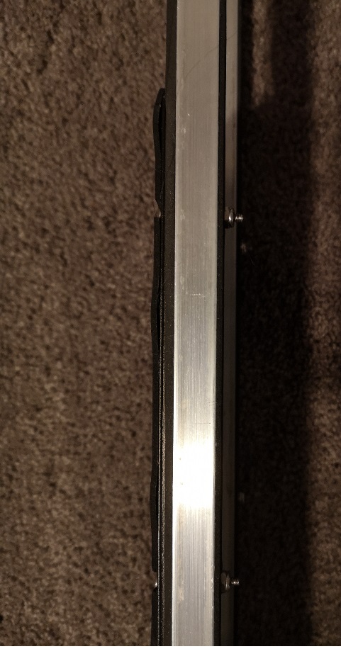

1 Midrange assembled. 1/8" board on front, 1/16" foam on back. 4-40 screws with nylock nuts. Feels good in hand, hopefully not to much resonance when the last of the drivers are installed. Might install some dummy wood for stiffness.

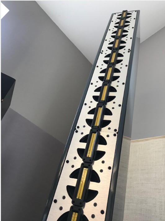

Have you thought about trying them like this? I appreciate that your SB drivers are pretty small but it would be interesting to see what it does to the full range line having the drivers in front.
attachment.php
Have you measured any of the setups yet?
Is that your build too fluid? Looks great!
I did not think about mounting them like the pic as the Xover was quite high and the SB line array had different goals. This was a quick add on.
That said maybe its worth a quick investigation as with the offset tweeter array and high Xover there should be problems with off axis and other measurements. Even though I know there are problems I do like the presentation better than with just the SB drivers. I did a quick tweeter integration with the SB array so measurements were short and I was eager to hear the results. So much so I've just left them up and been happy to not investigate their flaws. If time permits I might bet back to them and do some better sweeps but got the bug to do the OB LA project. With the OB project there was not way of mounting the arrays like that, with the SB sealed array that would make more sense.
