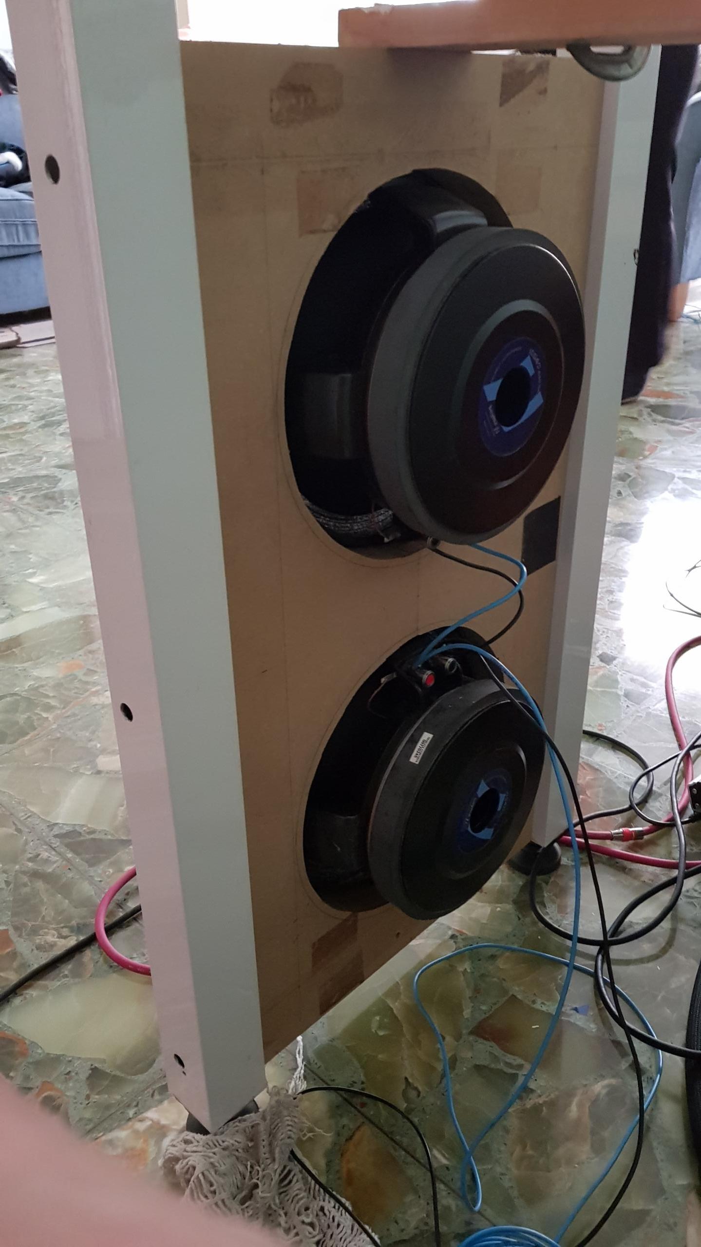

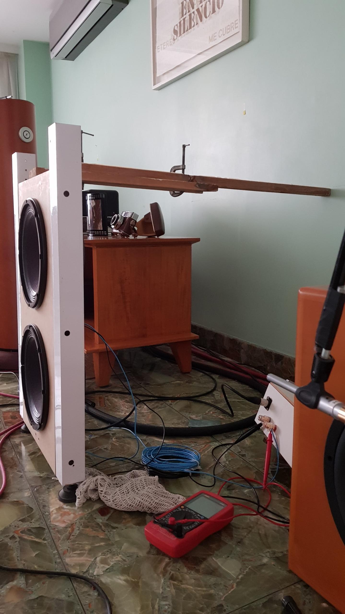

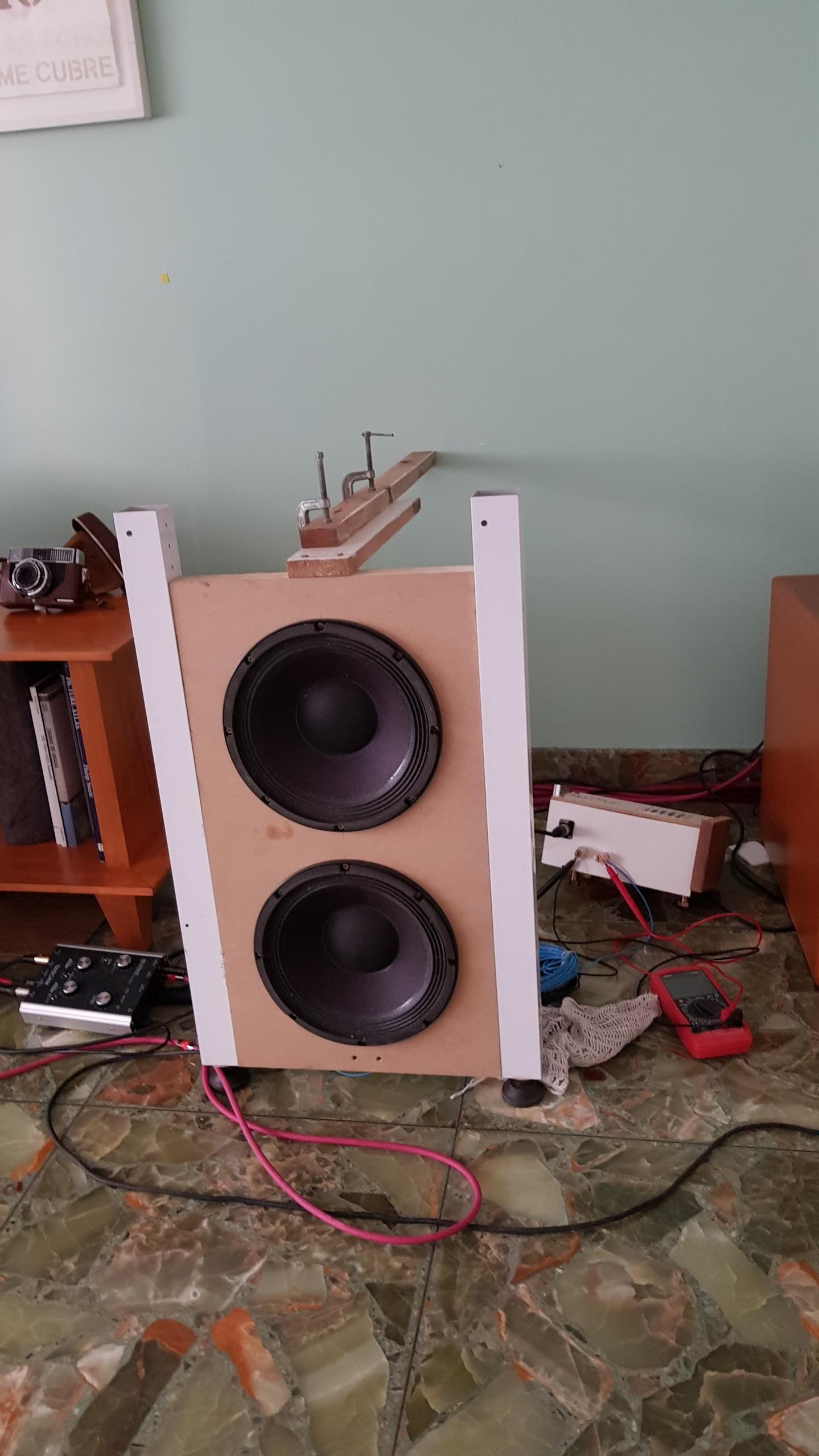

Understanding if I need twin 15", or one, or 12", or 10" is kind of confusing so I assembled a quick OB with a couple Beyma 10G40 I have (Qts: 0.3, Xmax: 7mm, big motor). The MDF baffle is 32mm (2x16mm) and added the aluminum square tubes to gain baffle width, reaching 45cm. Placed it 90cm away from the wall, and took some measurements.
The room is pretty nasty: 5 x 4.85 x 2.4 meters, so basically square and height is almost half the length/width. This creates problems with bass response and I'm in the process of treating the room mostly with bass traps. Linkwitz recommends no treatment on the front wall...but mine is being processed, so I will have treated front wall and the speakers can be placed out up to one meter from the wall.
Pictures of the experimental setup 🙂

Sorry the pictures show up sided. Don't know how to adjust that.

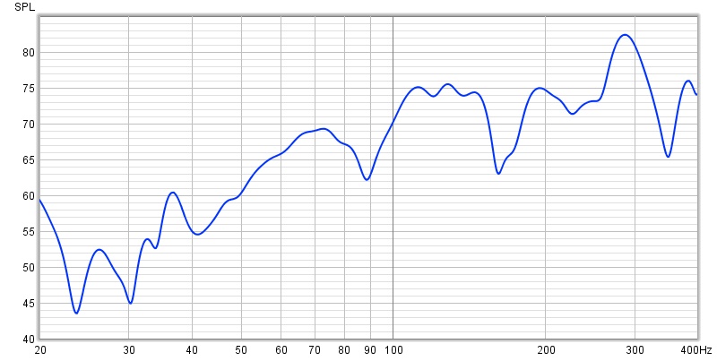

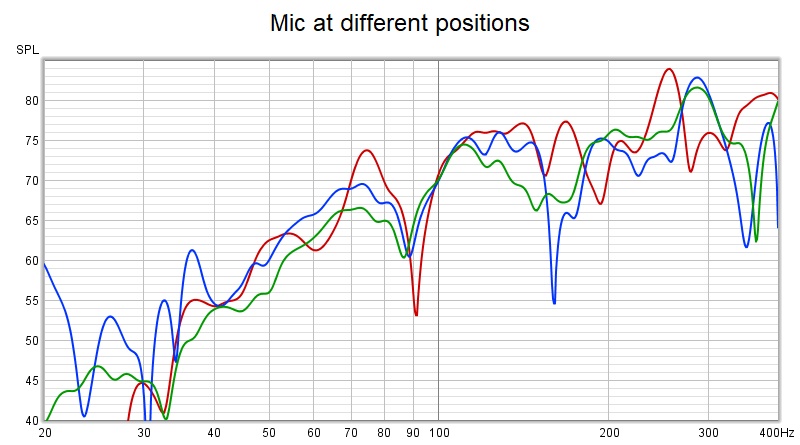

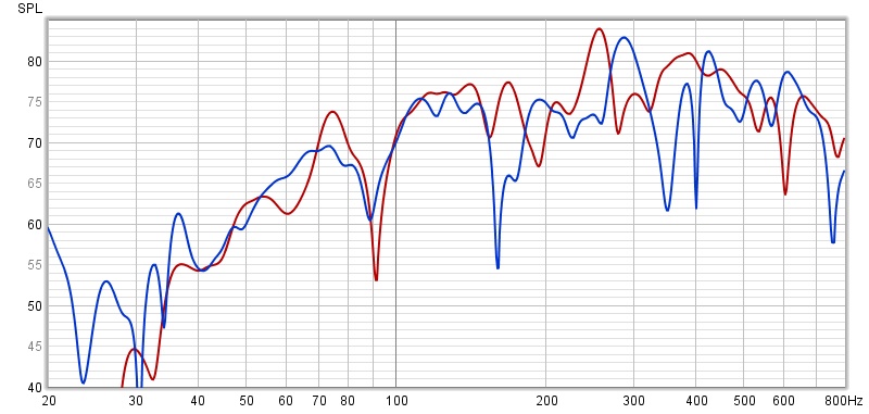

Here are some measurements.
First I wondered about windowing...in OB we want the reflection...so tried FDW at 10, 15 and 20 cycles with the mic 1 meter away and 35cm from the floor (at the height in between the woofers), on horizontal axis. I decided to proceed with FDW: 15 cycles.
Next question was where to take the measurement? I measured:
I think the best option is #2, but would appreciate feedback.
Last picture is 1 meter away on-axis horizontally and at ear-height, smoothed to 1/12. I guess this could be usable from 40 to 300Hz, if I could address the troughs at 90 and 160Hz.

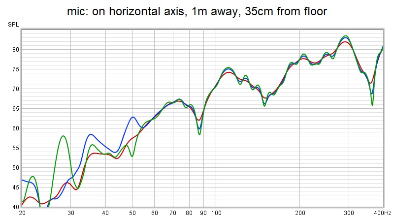

- 1 meter away on-axis horizontally and vertically (thus the mic was 35cm from the floor). The floor bounce must be an issue.
- 1 meter away on-axis horizontally and at ear-height.
- At listening position, at ear-height.

If you care to rotate the images, viewers like myself would appreciate more of the work(time and effort) you put in. if you spend 5sec to rotate each image before uploading them otherwise we(each one of us) will have to download all the images then rotate them ourselves and that will take us more time.

Measuring bass indoors is difficult, yes.
Your measurements show many reflections and room modes. I can't be sure where first dipole null is, simuated freefied response helps, I use The Edge for that.
Remember that you need 12dB/oct equalization below peak. Remember to check distortion and excursion below 50 Hz after eq.

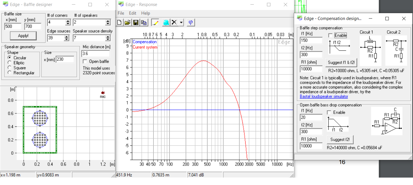

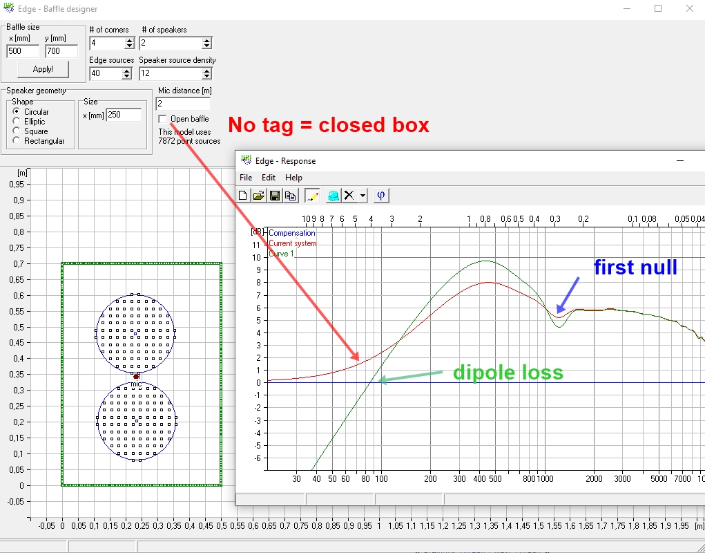

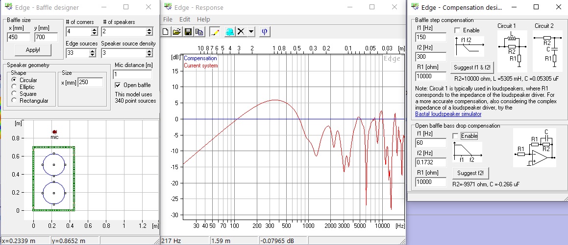

Initial shot at The Edge attached. Please note: mic at ear-height and 1m distance, on the right panel I have disabled baffle step compensation and open baffle bass drop compensation - as I don't know what they mean 😱
Is the dipole null the one at 1300-1400Hz? How should I use that info?
I use Acourate to generate my digital filters. The process is to measure response, set a target curve below the measured response, then the filter reduces response down to the target curve. Envision a horizontal line from the 50Hz response, and everything else will be brought to that. So that would equate to the equalization you refer to, correct?
And then what you are saying is I should set up the xo and filters, run the system and measure distortion at 50Hz while running with that eq applied. Did I get that right?
your Edge sim is 30 deg upwars off-axis, and open baffle (tag in box)
You have those list on the edge of baffle, they add width so I used 500mm width, on-axis mic at 2m and the sim is below. Dipole null at roughly 1200Hz (and closed box has same baffle diffraction null but not so deep)
Yes baffle compensation must be 6dB/oct and in my sim we can see how dipole loss continues 6dB/oct below 130Hz. Baffle boost 2-3dB happens around 1kHz.
To make crossovers work as intended, both low- and highpassed "ways" must have straight response at least one octave past the crossover point! (unless one uses brickwall filters) acourate can do that, but it must be done for each "way" individually!

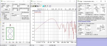

I think you intended to include a simulation that didn't come through. Not sure why you added width to the baffle, but I did the same on the new sim. Mic distance is 3.6m, which is what it would be if I were on the back couch. I kept mic height where my ears would be, but not sure if I should.
I added a graph showing response up to 800Hz. Not sure I can tell if there is straight response with everything going on.

Sorry attachment forgotten
Thank you!
In my first Edge sim I had "open baffle" tag on, but the second time I neglected it.
So I want to stay in the linear area for about two octaves. So maybe I shoot for 50 - 200Hz, and see later if I can raise it to 300Hz. I guess I should look into the 8" midrange now, probably baffle-less in the midrange and tweeter, with hanging drivers.
The most burning question is the suitability of my room for OB/dipoles, though. What do you think? I took away from the paper that an equilateral triangle with speakers and listening position is not suitable for this kind of speakers.
