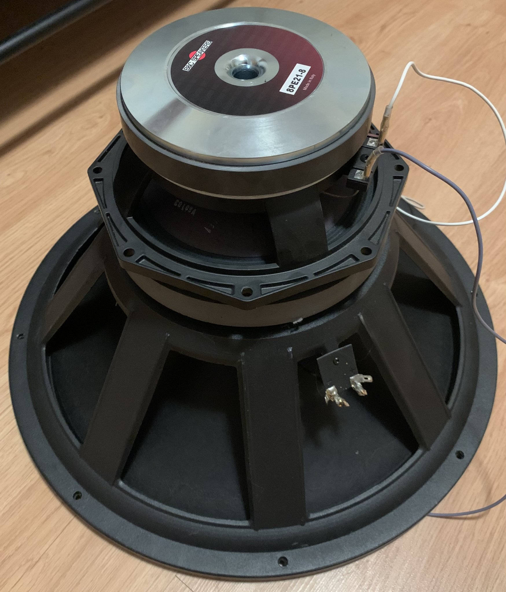

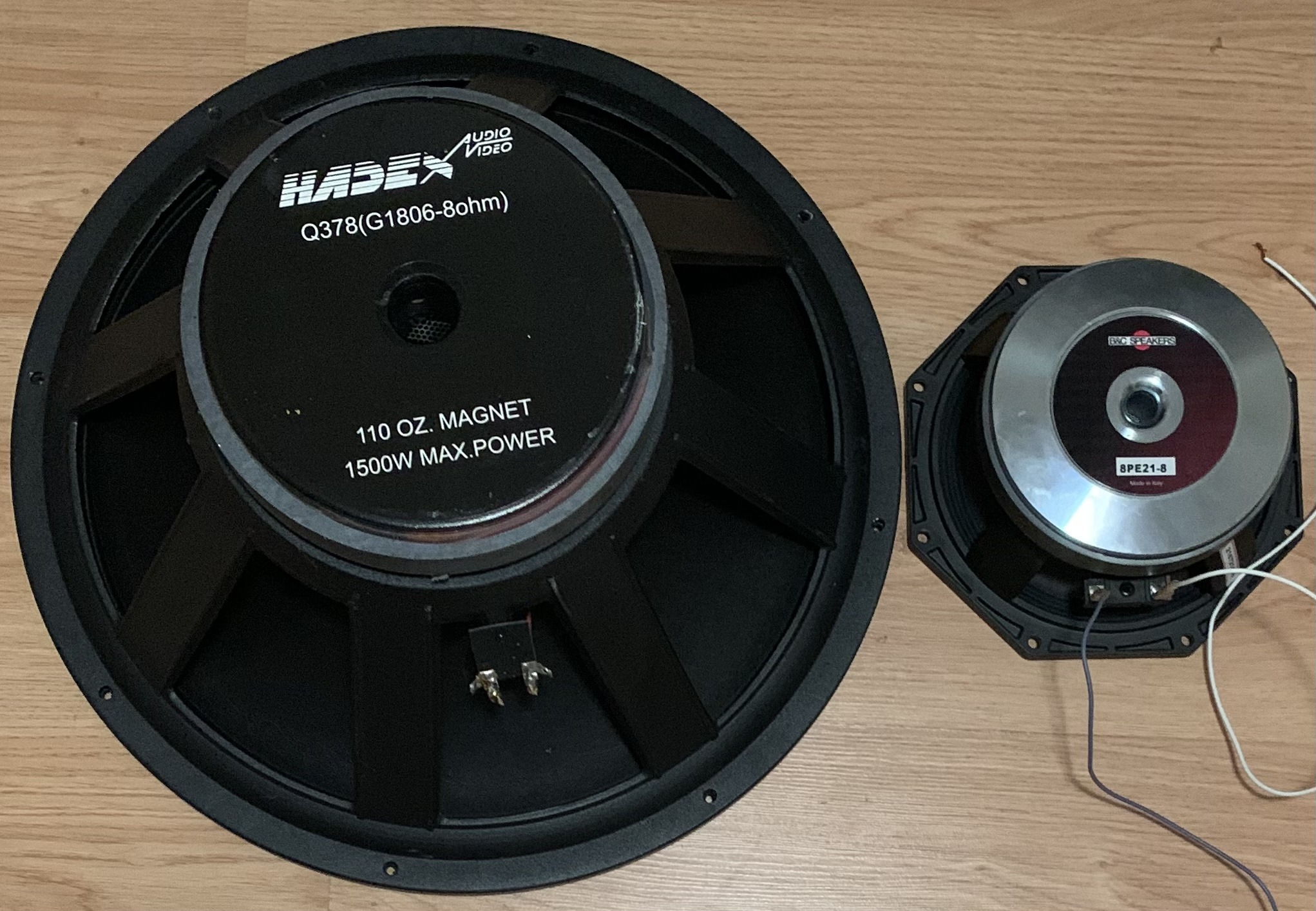

Time to measure and weigh the drivers. The 18" is 10.8 kg, the 8" 4.3 kg, CP755 3.2 kg and DCX464 3.6 kg. That is 18.3 or 18.7 kg for the drivers only. I wonder how much the box will be. I am pretty sure I will not get below the legal single man carry weight of 30 kg total. 40 kg would be nice though, that one can still pretty easily manipulate with - like my Marshall 1960BV guitar cabinet.

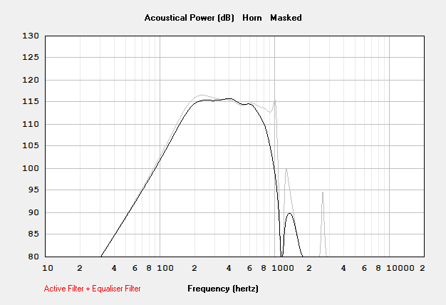

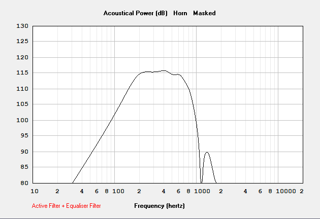

Well, it seems that 3 cm make a huge difference. Instead of 800 Hz at 10 cm, the cancellation notch moves down to devilish 666 Hz at roughly 13 cm. That is for center placed circular port. I hope I will be able to bring this back up by shifting the entry port closer to the throat. Definitely worth having a few extra mounting plates for experimenting with the port placement.
Edit: No, this is something else - most probably front or back chamber resonance, that should be possible to handle.
Where does this resonance come from? I did not have it before.
The resonance does not show when simulating the mid as offset horn.

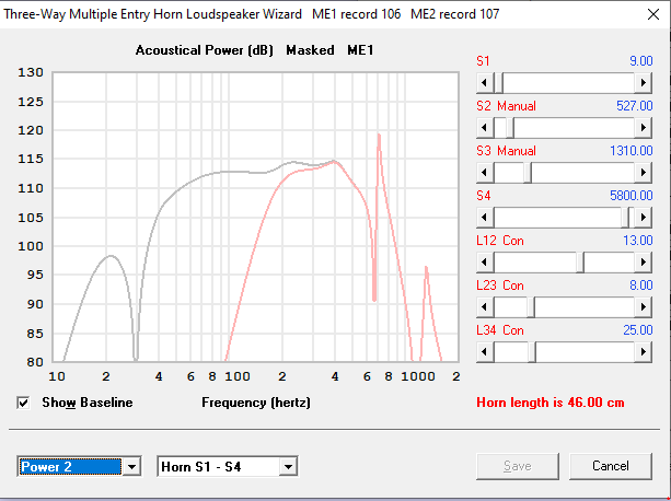

Edit: It does show up somehow. This is with unmasked resonances (in grey):
I still do not understand the down/up jump from the previous post. HornResp records attached.
I had a 16 cm port instead of 1.6 cm port on the mids. The resonance gets smaller, but I still do not get it why it was not there before.
Edit: I have just discovered something. When using only mids, the notch disappears (simulating as 2 way MEH only). Could the notch be from interaction between bass and mid chambers?
Heureka! The resonance in mid response comes from the bass chamber. When I reduce the volume to something small, it disappears again. I hope I will not see this in the build. If yes, filling the volume below the bass cone as much as possible should help as well.

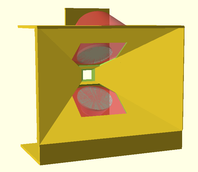

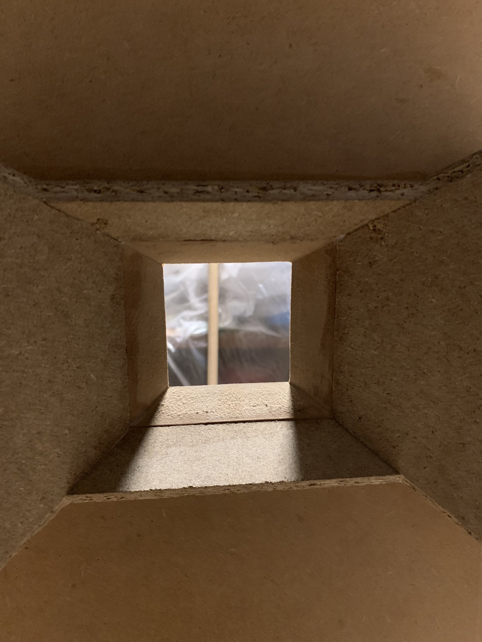

This is just a preview of the arrangement. 18" will be on the bottom, 8" on the top in a small internal enclosure. The bass reflex ports will be placed on the sides of the front extension panel. The bottom panel will be in 3 parts, the middle part being the access opening for the 18". This approach will need some extra bracing at least on the bottom. Maybe 12 mm birch ply could be used then.

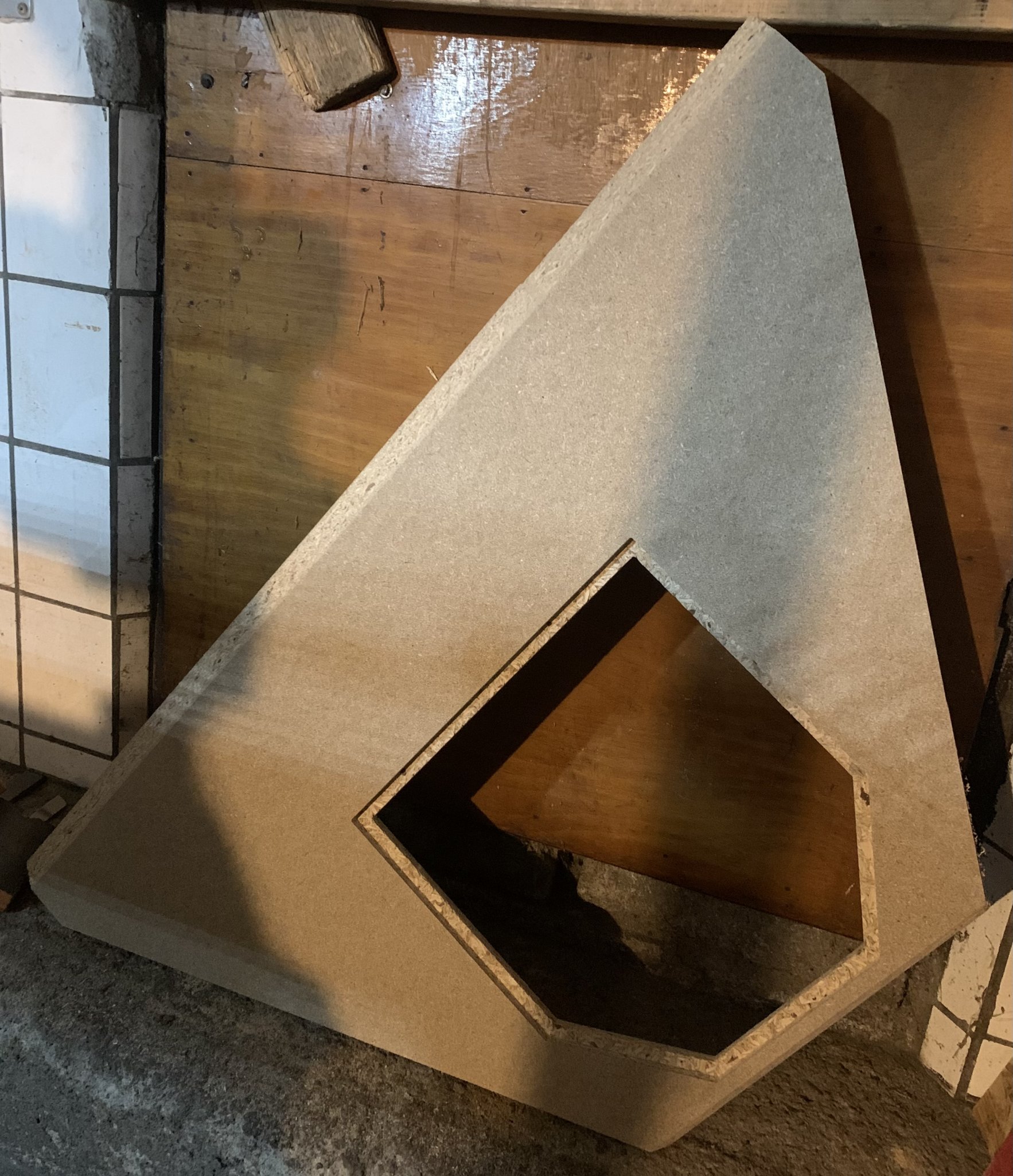

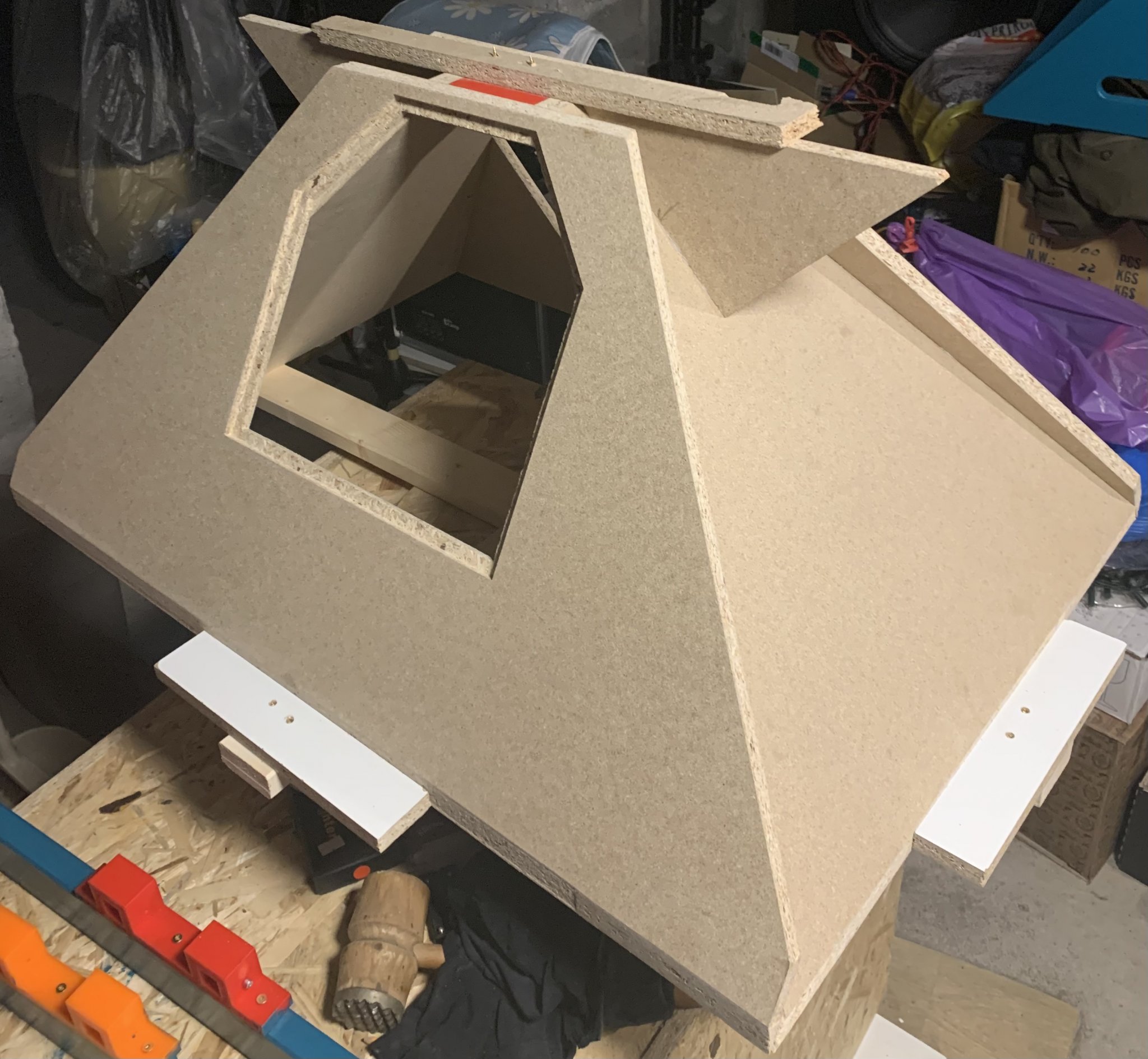

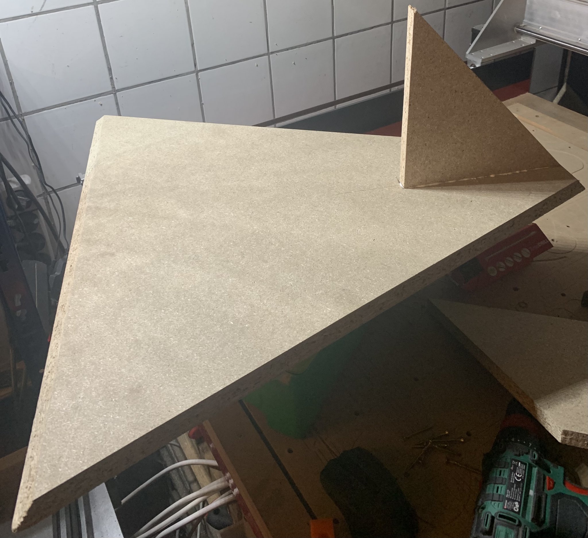

First panel was cut. This was for the first time trying to cut something longer than my CNC is in 2 steps using alignment pins. It worked quite well, the error over almost 1 meter is around 0.5 mm. Mostly due to the board bending, I need to fix it better to the wasteboard.
While tuning the new CNC spindle for another project, I tried to cut some more panels. I made a mistake with the panel shown above - I used a wrong STL. It had to be fixed by hand.

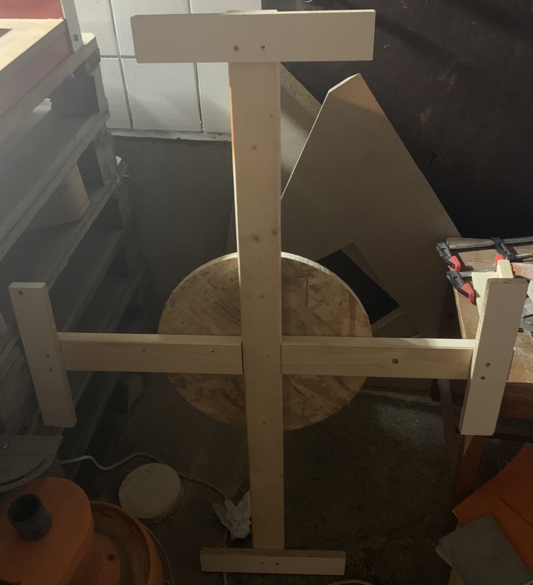

I made a fixture for the glue up (the cross like thing) and 3D printed spacer for the top. It worked really nicely, the glue up was a breeze with these. A battery powered brad nailer helped a lot to hold everything in place.
I will slowly continue to glue the other parts while the CNC is cutting another things. Some sanding will be needed, but not too much, since it is just a test model from cheap material. I also want to try out bracing strategy so that I can build driver access doors on the top and bottom.

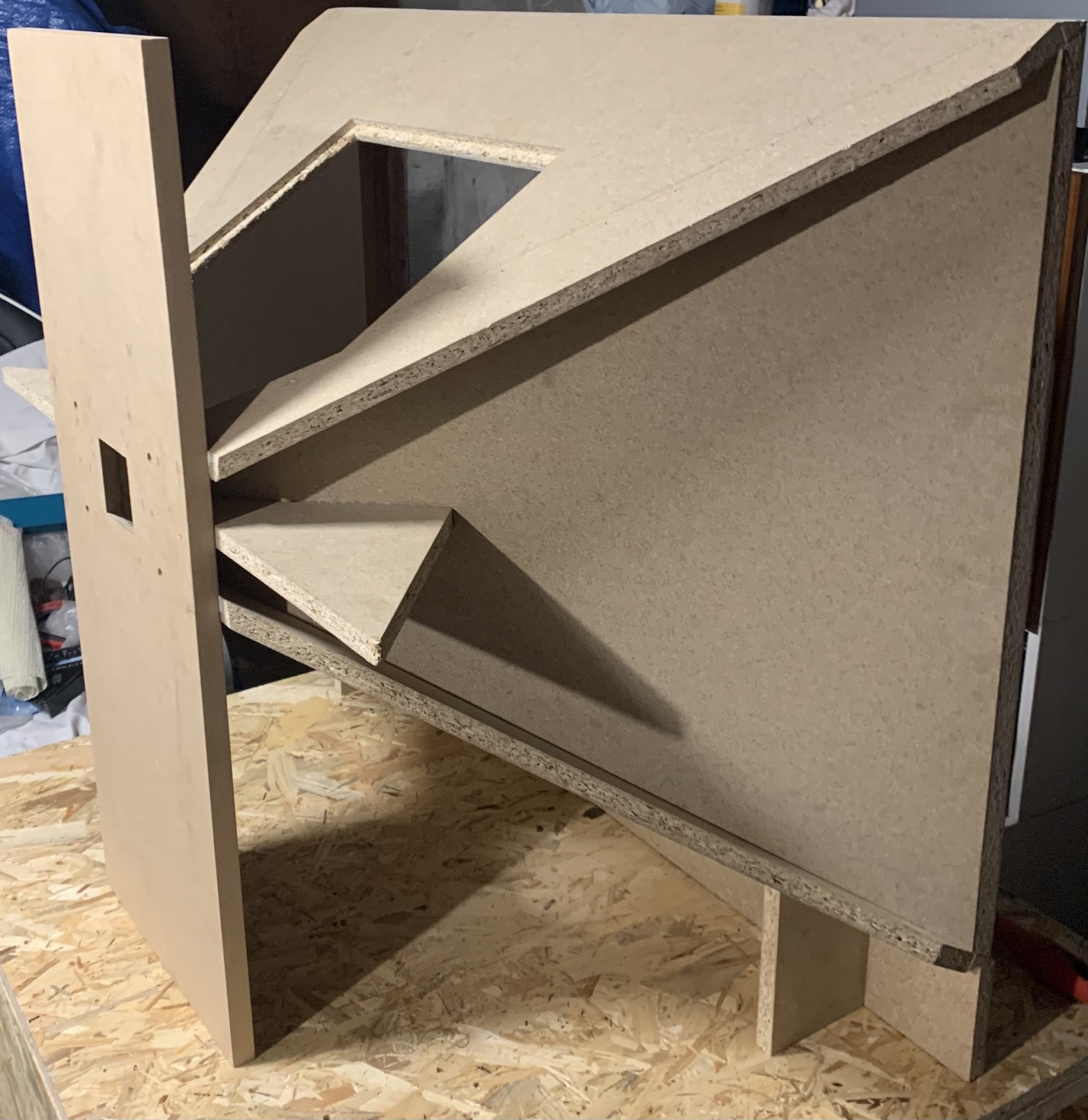

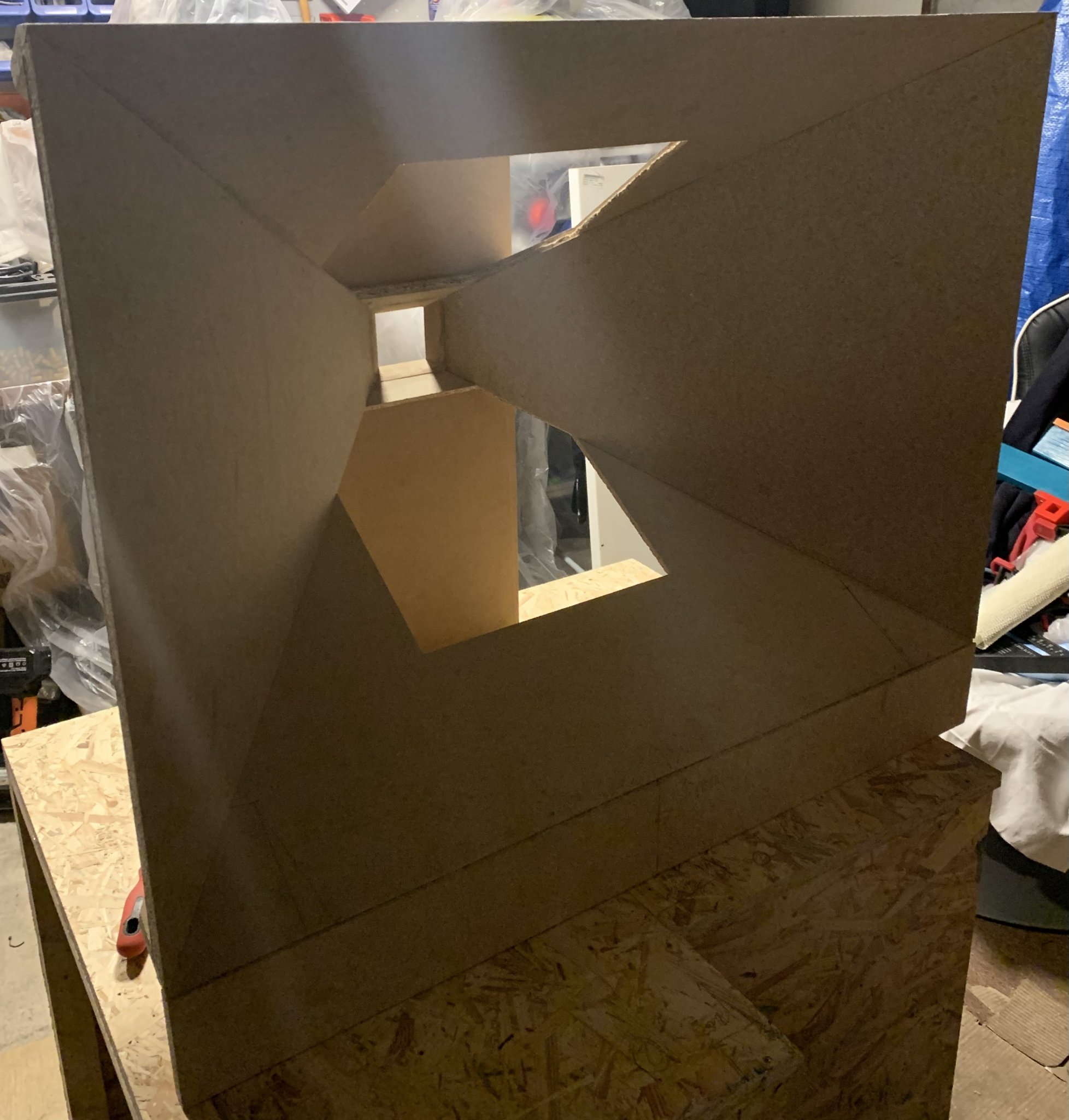

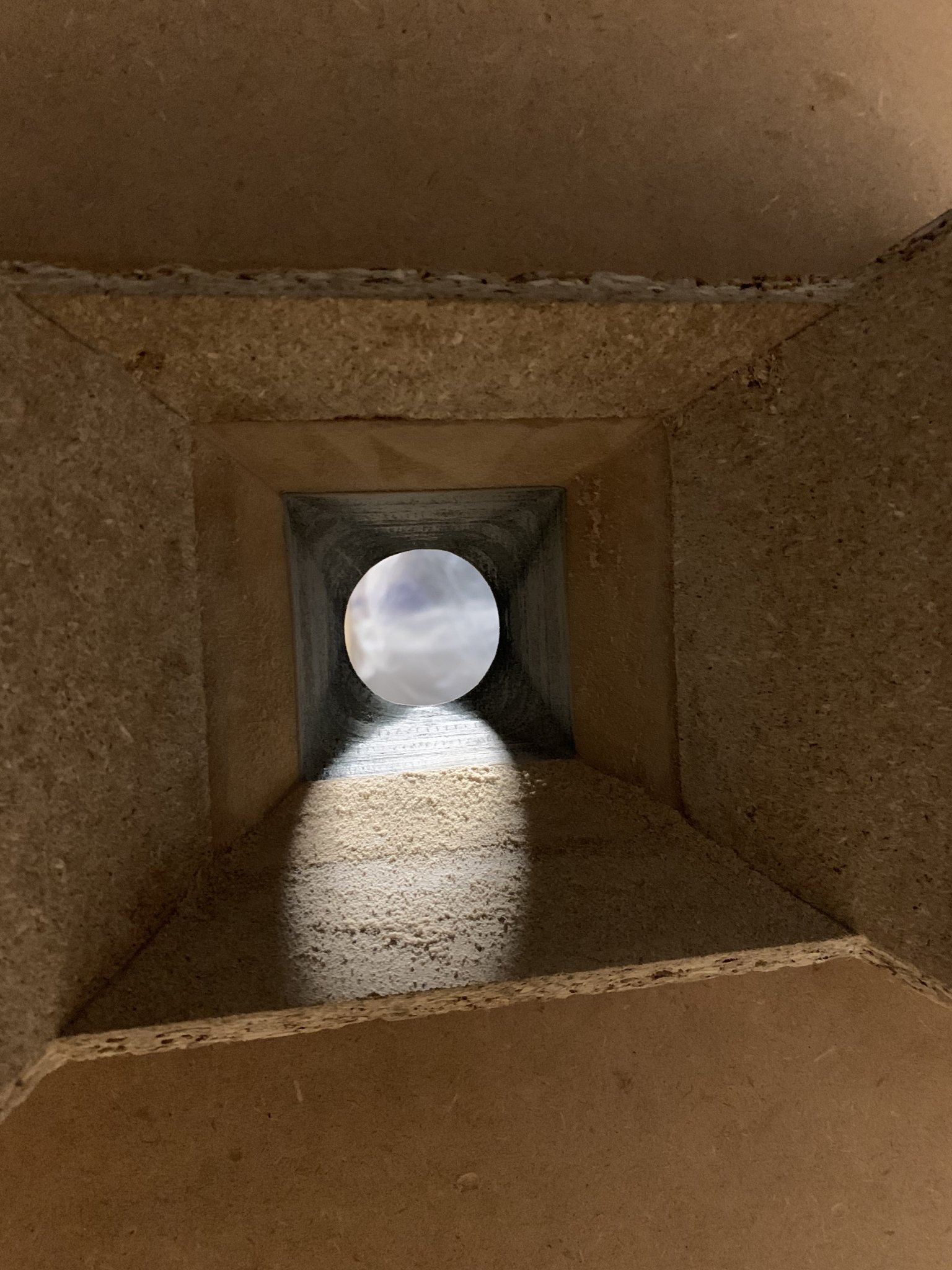

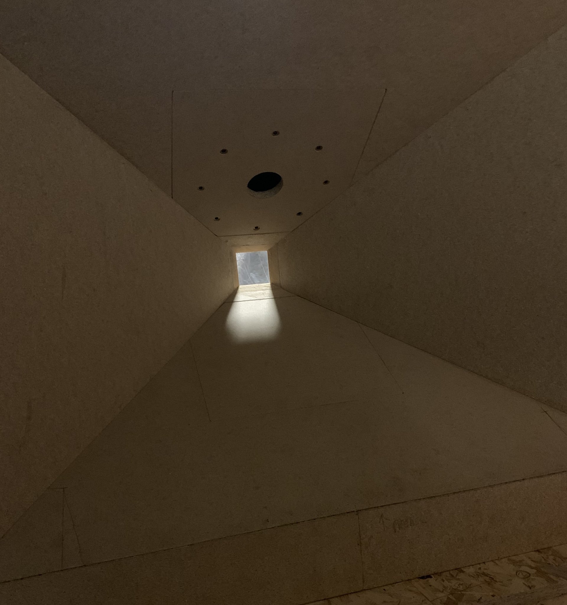

The frame is glued together, now it can stand by itself. Now the bottom opening will be blinded and 8PE21 adaptor plate will be mounted on top, first without an enclosure on the back. Edit: Forgot to attach the pictures🙂

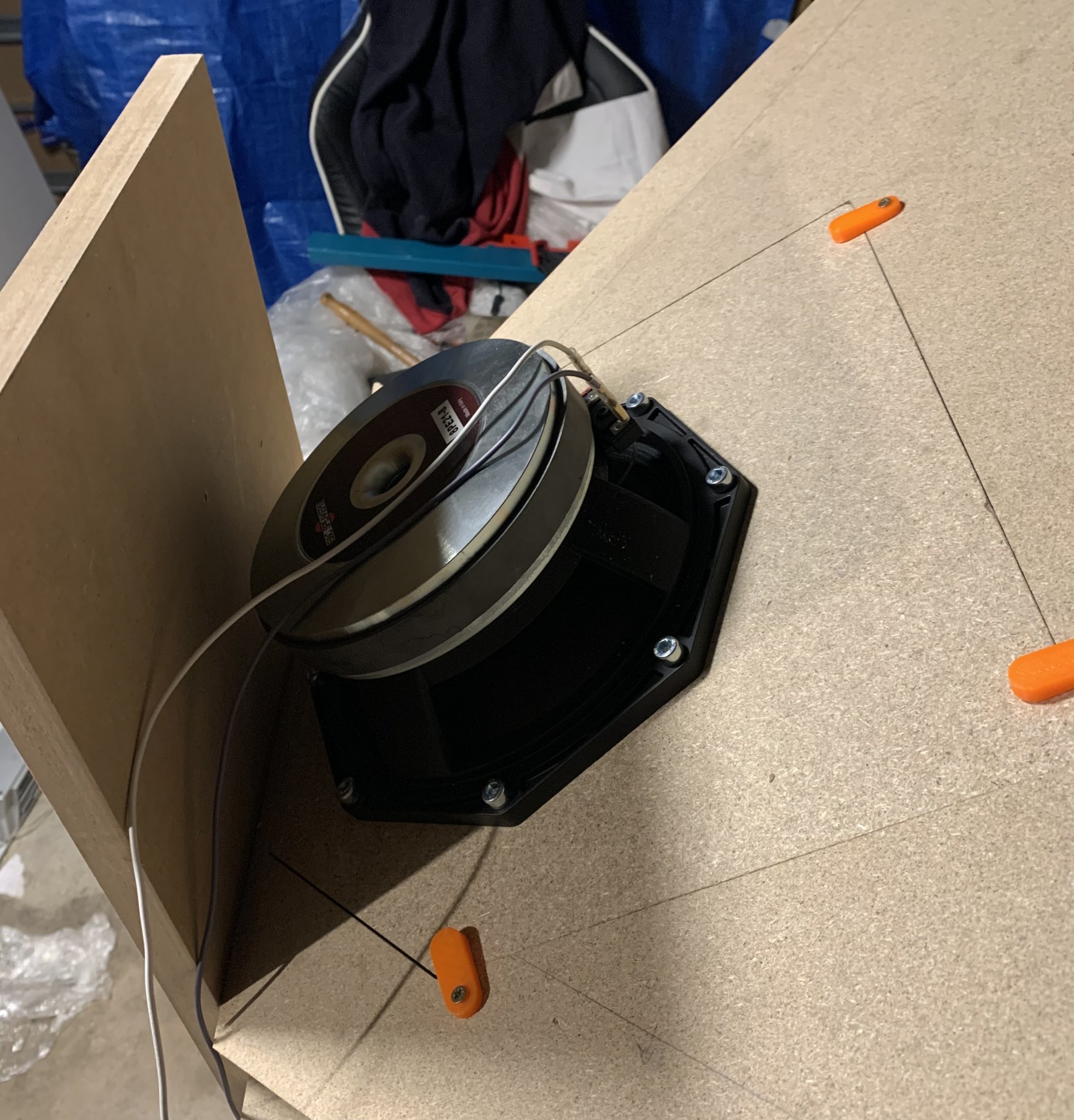

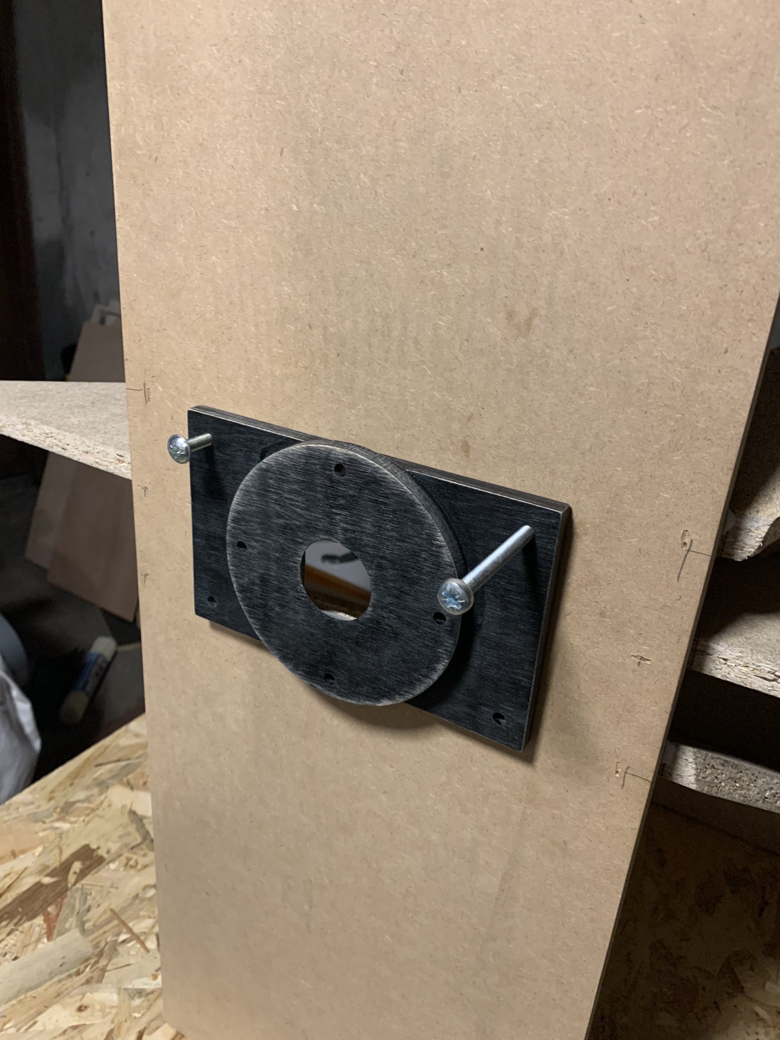

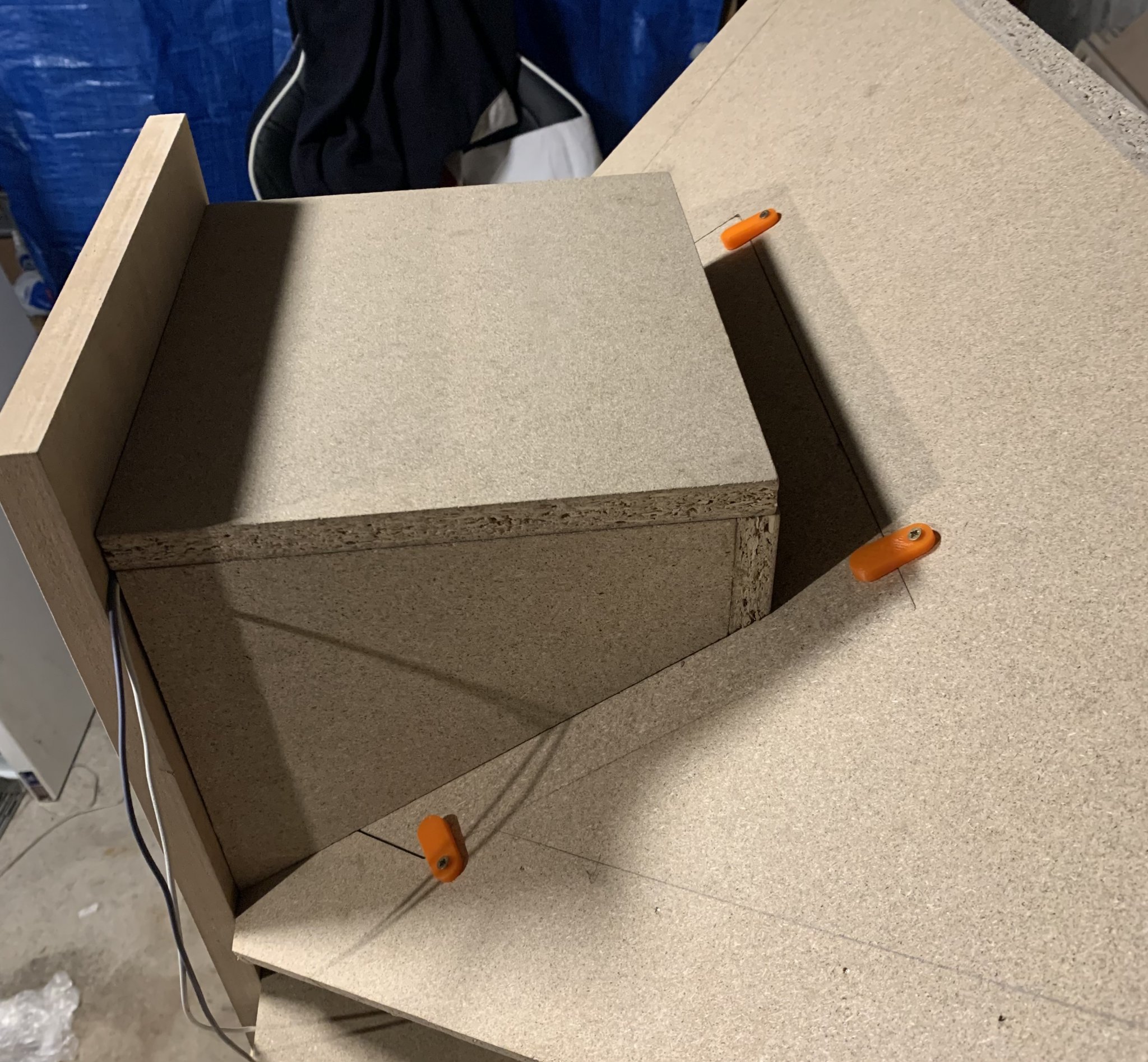

I thought I would do this tomorrow, but I managed to test the mid woofer mounting and to blind the bottom opening - the plates are held by small 3D printed brackets. One of the screws is not accessible, so in future I will use only 7 of them.
