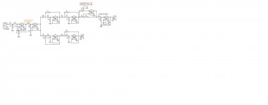

Attached a schematic for xsim for 2-way as an example. Input the frd and zma, start adjusting values.
Vituix Cad can do this as well.
Hope this helps

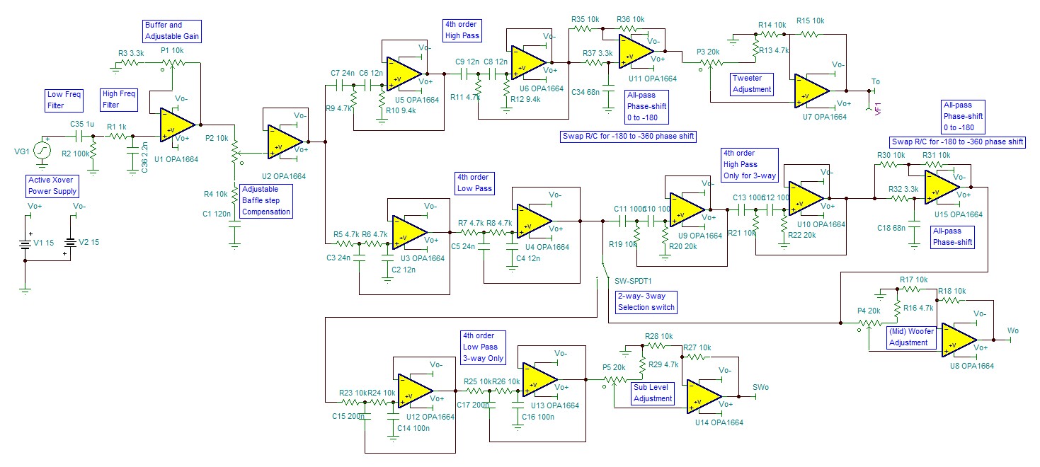

Better Schematic
The Rane is way too complex, and the TIDP134 has a 2-way limit.
ESP is the best, Although not on the PCB board, the required circuits are mentioned in different articles.
Use the attached schematic for a more complete design.
Credits: ESP
Cheers
Mallik
Credits: ESP
