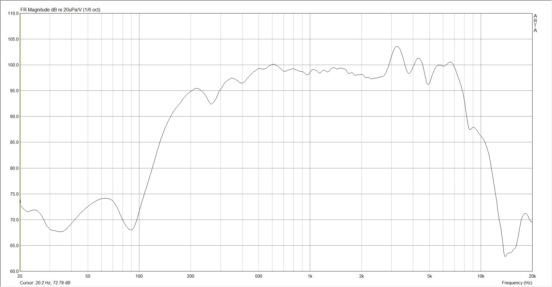

Brett, what do you think is the point of the 'lip' over the woofer on that limmer? Is it just a way of avoiding a stepped baffle when adding a tweeter waveguide?
From dispersion wise view it doesn´t change much but it helps to keep up sensivity to about 97db-98db/2,83v over my using range which helps me to get an sensivity of about 96db/2,83v with High and Lowpass and my complete speaker also ended at about 96db/2,83vThe Limmer looks good from a non-technical point of view. It's actual effects are a little less obvious...
Problem I don't want to use a compression driver, I have waguided Audax tw34 tweeter and I ordered a pair of waveguided wavecor tw30a12 which are still in the DHL box...Don't you just order them from Limmer direct?

Phl 1120 is often said to be used from 500hz, same for Audax pr170, have you tried that ?
