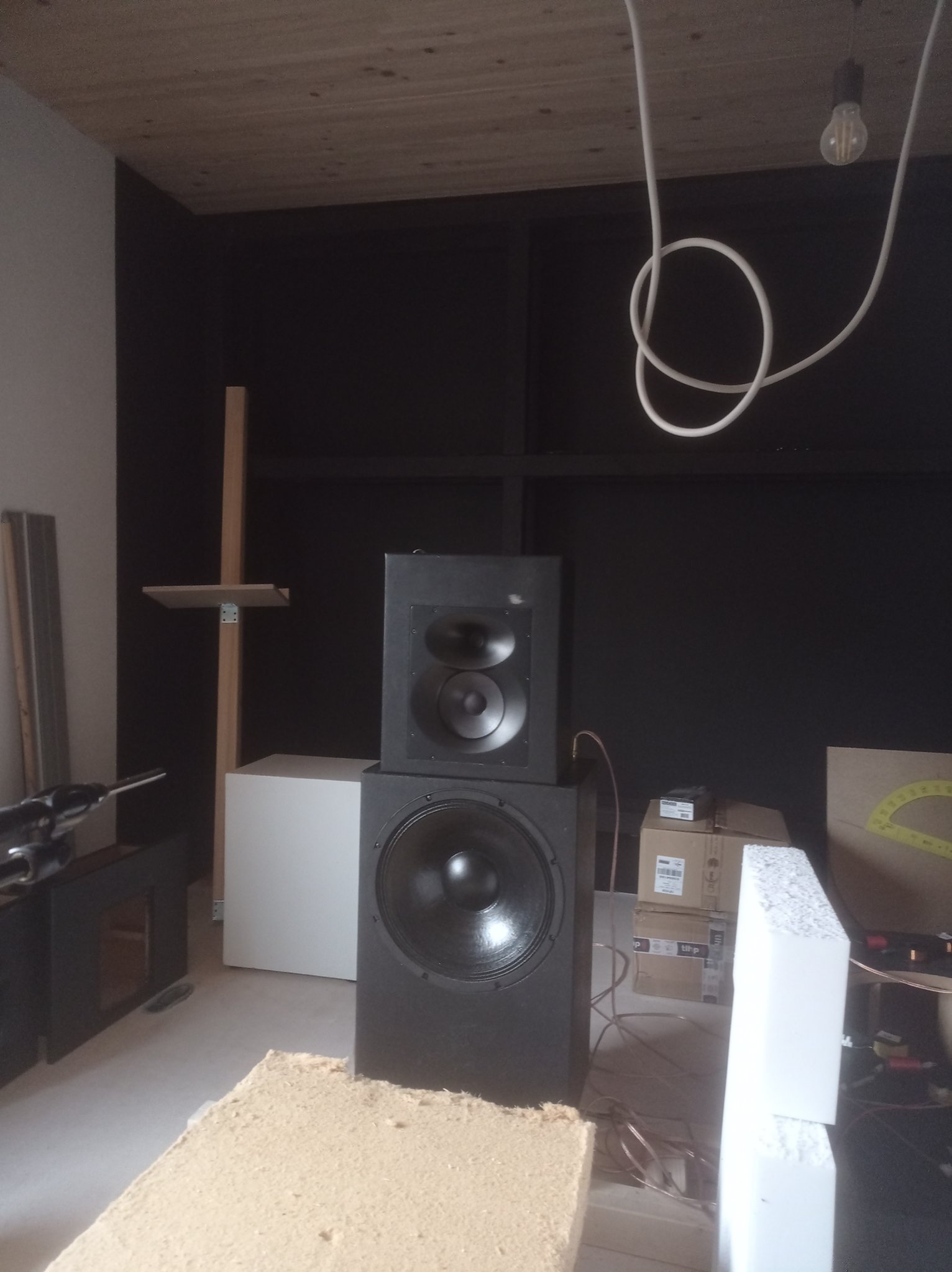

Is this project have some progress or built already? Just out of curiosity.

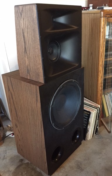

On the HT setup I like dipolar surrounds.
So, you have an on-axis null. I guess you will only be listening to reflections. Honestly, I have no idea how such a system sounds. How will this works when a movie pans a dialogue from LCR to a side surround?
You mean for a woofer waveguide?The Limmer looks good from a non-technical point of view. It's actual effects are a little less obvious...
Do you know where to get a 165mm waveguide...?
Speakers can be set in phase or opposite phase but never tried lol...So, you have an on-axis null. I guess you will only be listening to reflections. Honestly, I have no idea how such a system sounds. How will this works when a movie pans a dialogue from LCR to a side surround?
To me it's to create a field of effect, there is no ''reality''...
I am no movie specialist but I don't know a movie with dialogues from behind...
I guess it's a bit like these new front atmosphere speakers...
That said I fell asleep in the middle of matrix 4 last night...
